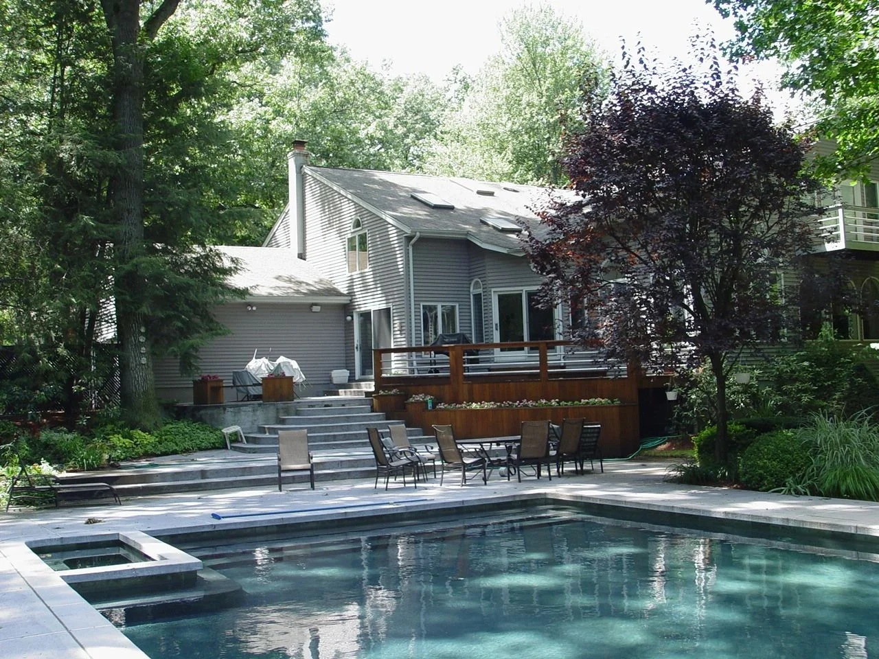

if you have trees it's hard ,open sky then it should work.i had to dump Dish because they moved the HD to a different bird,too low in the sky Directv i can get but their HD sats are blocked--- but i have tall trees but--- 61.5 is Wide open see the space a shot is a shot 12 degrees is low but with a pole and open sky..should work good luck
Is that shot from where the Dish is mounted for VOOM and you have the same 12 degree angle I do? If so, let me go snap a a few pics of my eastern view.
