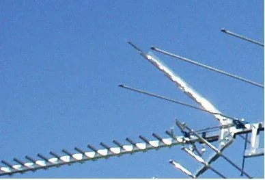

Select any of them that you are sure you should get and press VOOM button then green button. Select System Settings. Select #7 and scroll down to third page and see what is the Off Air Signal Power.
It sounds like you are not getting any power on them. Also check that the antenna is connected to the OTA module and not the UHF input on the back of the receiver. I'll try to get you a picture.
rollerfink said:
Yep, it's plugged into the right place.
On channel 4 my off air quality ranges from 13 to 20 and my off air power hovers around 20-22.
My sat signal is 55.
It looks like the antenna is not performing very well. You are not getting enough power. It should be around 60 (power) to get a lock. Are you sure that is pointing in the right direction? It needs to be pointing towards the transmitter.
No. I have no idea which way it's pointing. It's a big one that looks kind of like this...except I don't think mine has the white pointy part sticking out the top :)
http://www.alleged.com/radio/Johns-Ham-Shack/Antennas/UHF-Repeater-Antenna.jpg
Sorry I'm a bit of a spaz when it comes to satellite and OTA -- I've always had cable.
That's a good antenna. It is the RS antenna with a range of 65 miles. It is the same one I have but it is highly dirrectional. Meaning that if it's not pointing to the correct dirrection it will not pick up your signal.
Go to www.antennaweb.org and enter your address. It will give you all the OTA stations, select digital only and then click on "View Street Label Map". This will give you a good reference where your transmitters are located. Let me know what happens.
Thanks. This is gonna sound stupid, but which part of the antenna has to point in the direction of the tower? Is it like an arrow?
The V shape part of it. I guess that looks like an arrow. :)
rollerfink said:
Thanks, maybe I'll climb up there tomorrow and play around with it.
Ok. Not to create any confusion here is part that needs to point to transmitter.
Yes, I think that's your problem. Once you are able to rotate to the proper location you will get your locals.
