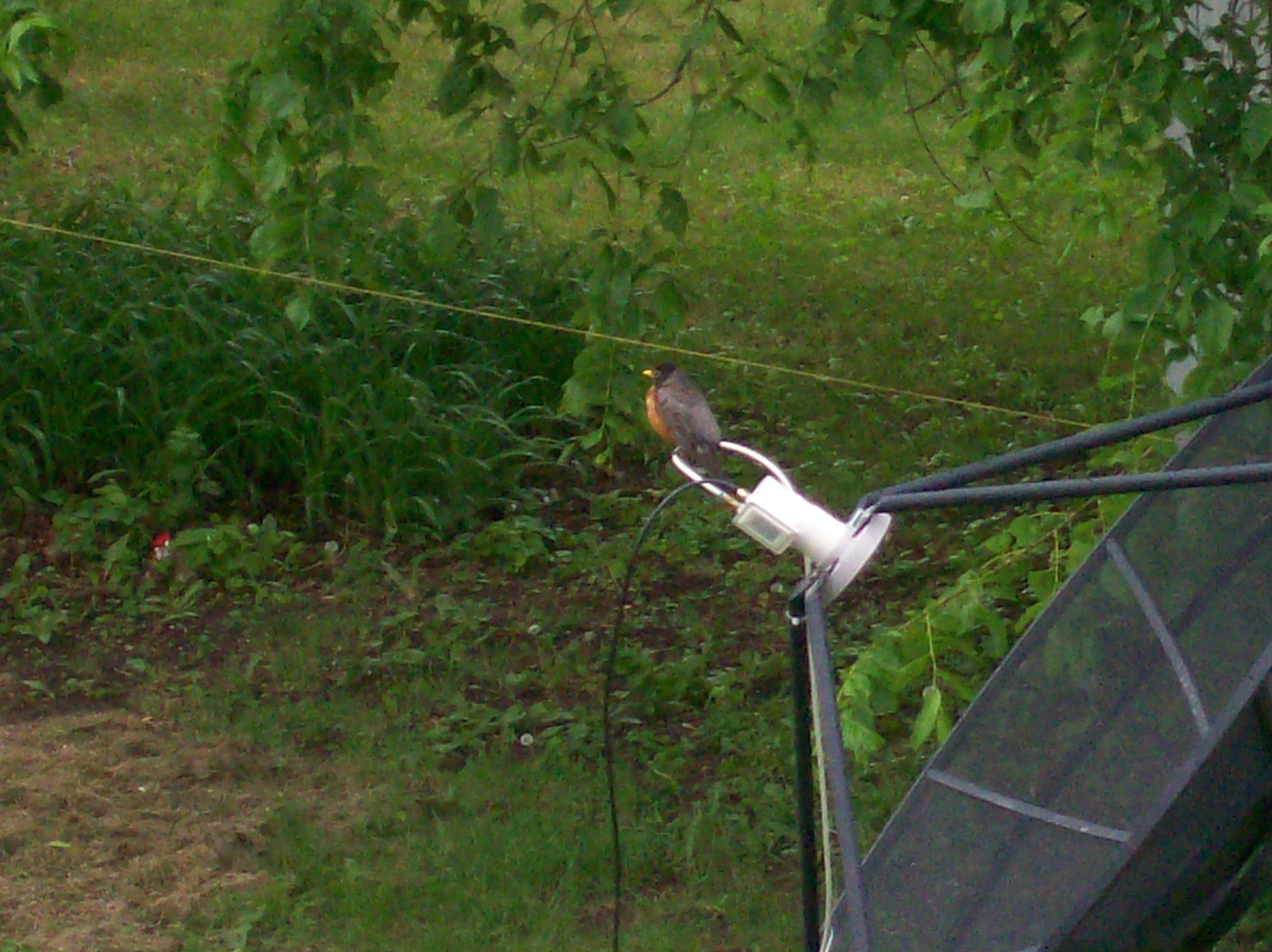

Does W5 (105 W) still have a stronger foot print. I am unable to find any sign of it.
103 and 107 have been found but no 105.
