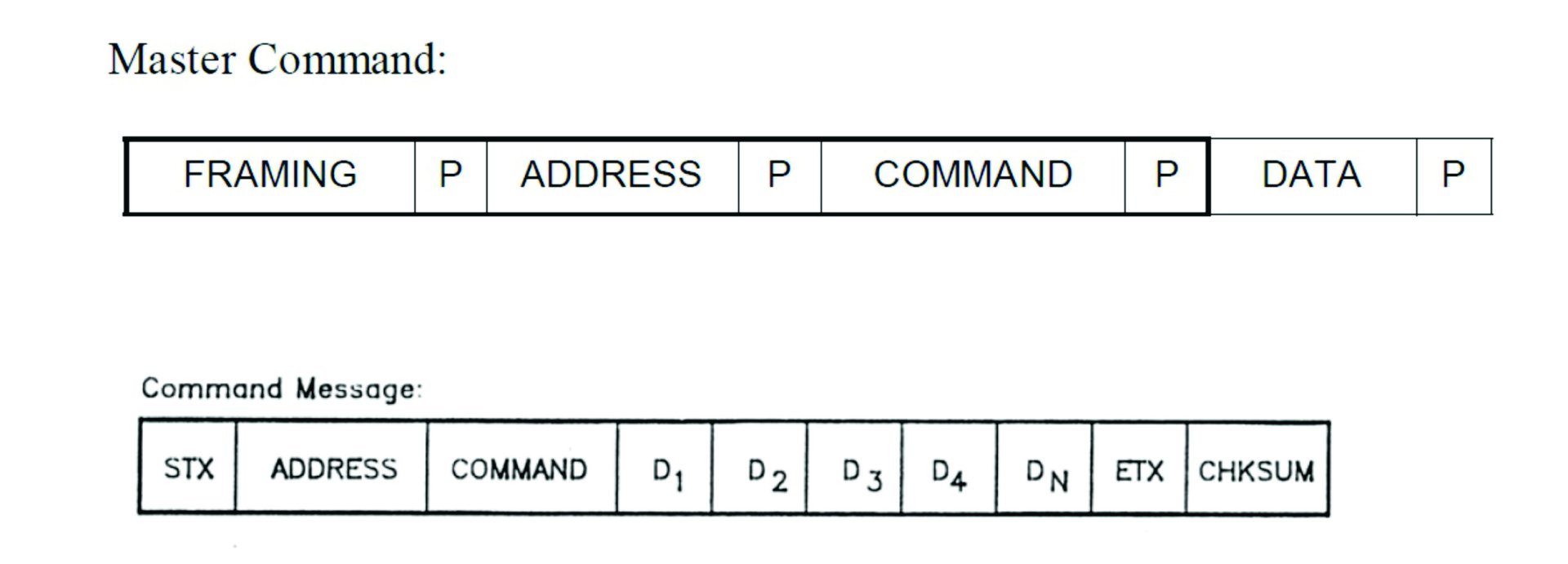

Oh. Further and deeper. And for me frustrating to think of a solution.
1) Receiver LNB port sends command.
2) Just like the ASC1/Vbox, etc. Filtering captures the diseqc data stream from coax pass thru.
3) Data wakes up the Arduino/MCU. Receives the string.
4 Data stream packet is decoded and translated to RCK packet info.
5) All handshaking and acknowledgements are taken care of by the Arduino.
6) Arduino communicates with the receiver to perform necessary duties.
*RCK comms manual states that either a satellite name or satellite position can be used for the go-to command.*
*RCK Az-El controllers could be used with polar mounts for inclined orbit satellites with additional coding.*
Cool or no-cool?
Cool or no-cool?View attachment 183062
More gook. The RCK movers use RS-422. And there happens to be RS-422 Arduino shields. I don't know why I'm on the Adruino thing but people are doing some pretty cool things with them. Research Concepts told me in a phone call when I asked if there was a company or if they knew of anyone offering a diseqc interface. I got a "huh?".
But it was cool to find out that the command set for newer units is backwards compatible.
A lot of fellows are using these different models to move their dishes. Some even use the "ancient" pc software to control them.
But mostly is a Digicipher receiver method. Change to another sat. Get up, walk over punch a few buttons.
Since the ones out there that work are still working. And crafted in the good old U S of A. They still live.
The pc software has some cool files in the installer. Maybe someone would like to take a peek. I've renamed them to open in a text editor like Notepad++.

The RC units are really cool and very robust. My dream would be to develop (because I suck at programming) an Arduino diseqc interface that sat in the middle of a receiver and the dish mover to translate commands.
On paper it looks not too complicated. Any geek takers?
