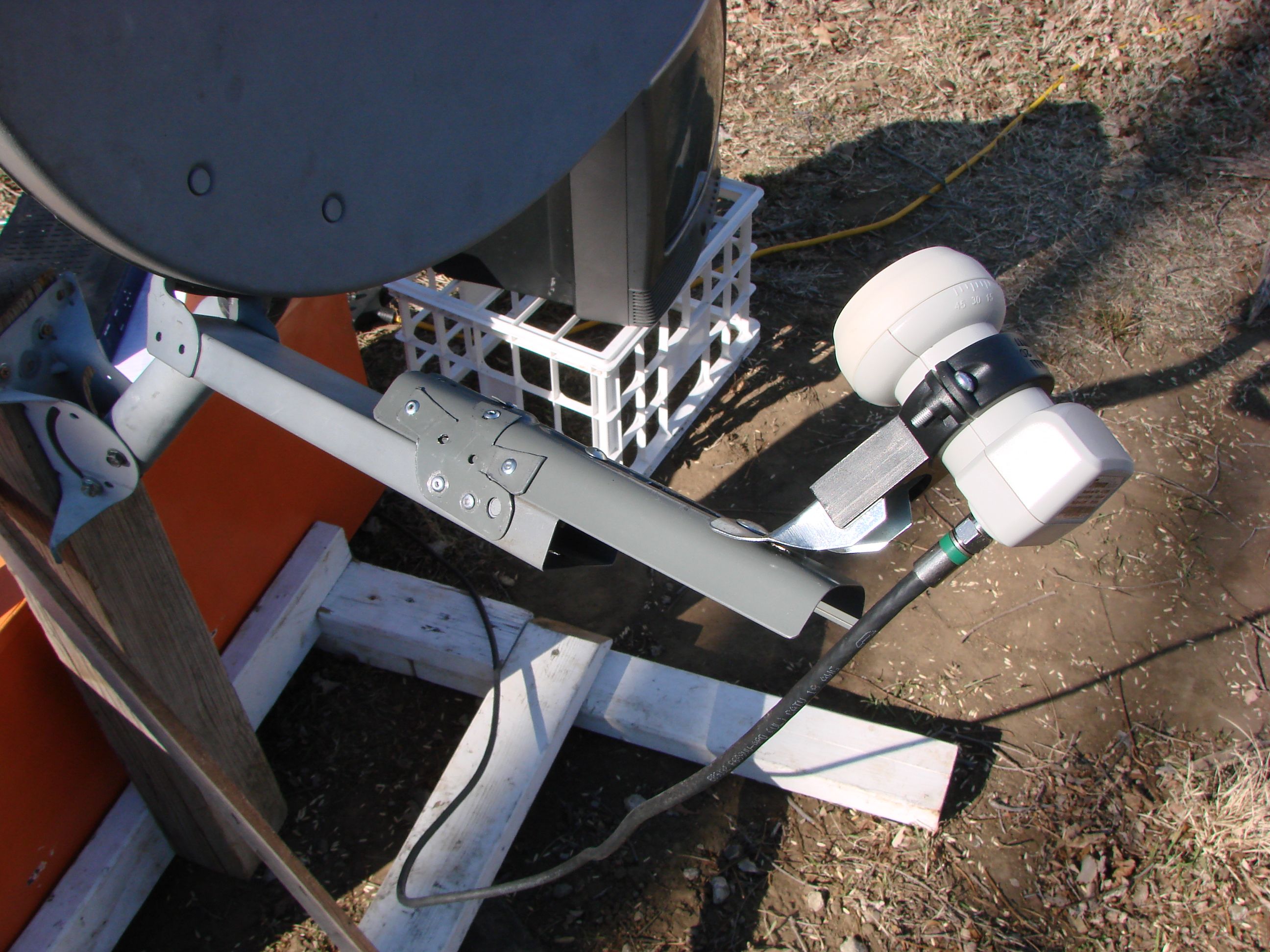

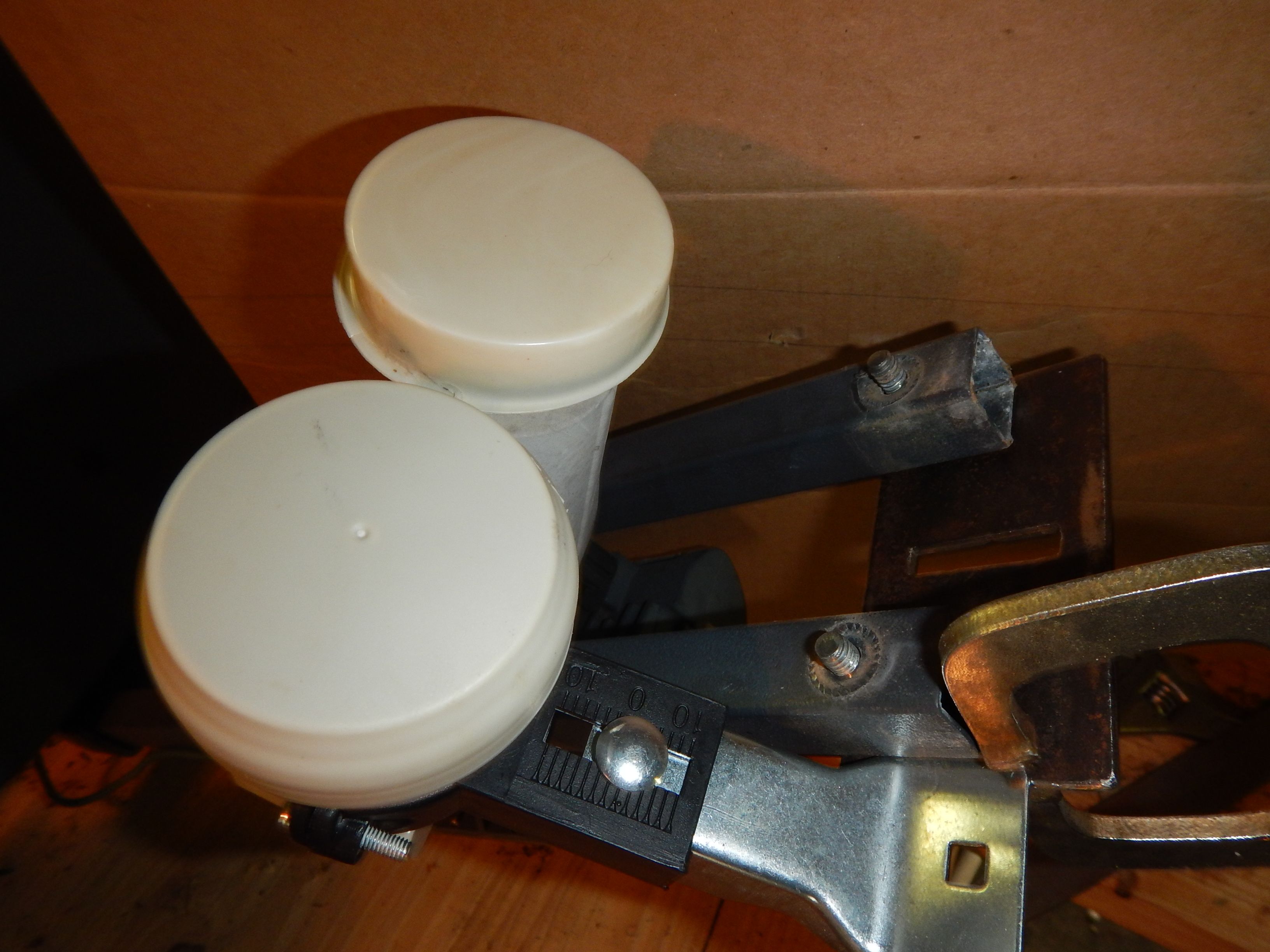

So on Thursday night I removed the circular LNBF's and plastic Y-yoke from the pizza pan. For the linear LNBF setup, I used a universal bracket to hold the LNBF. The LNBF holder is attached to the dish arm by an extension with a slotted adjustment drilled into it.
I did some measuring and comparing of the old LNBF position to the new. Satisfied things were in about the right spot, I riveted the extension to the pizza pan arm.

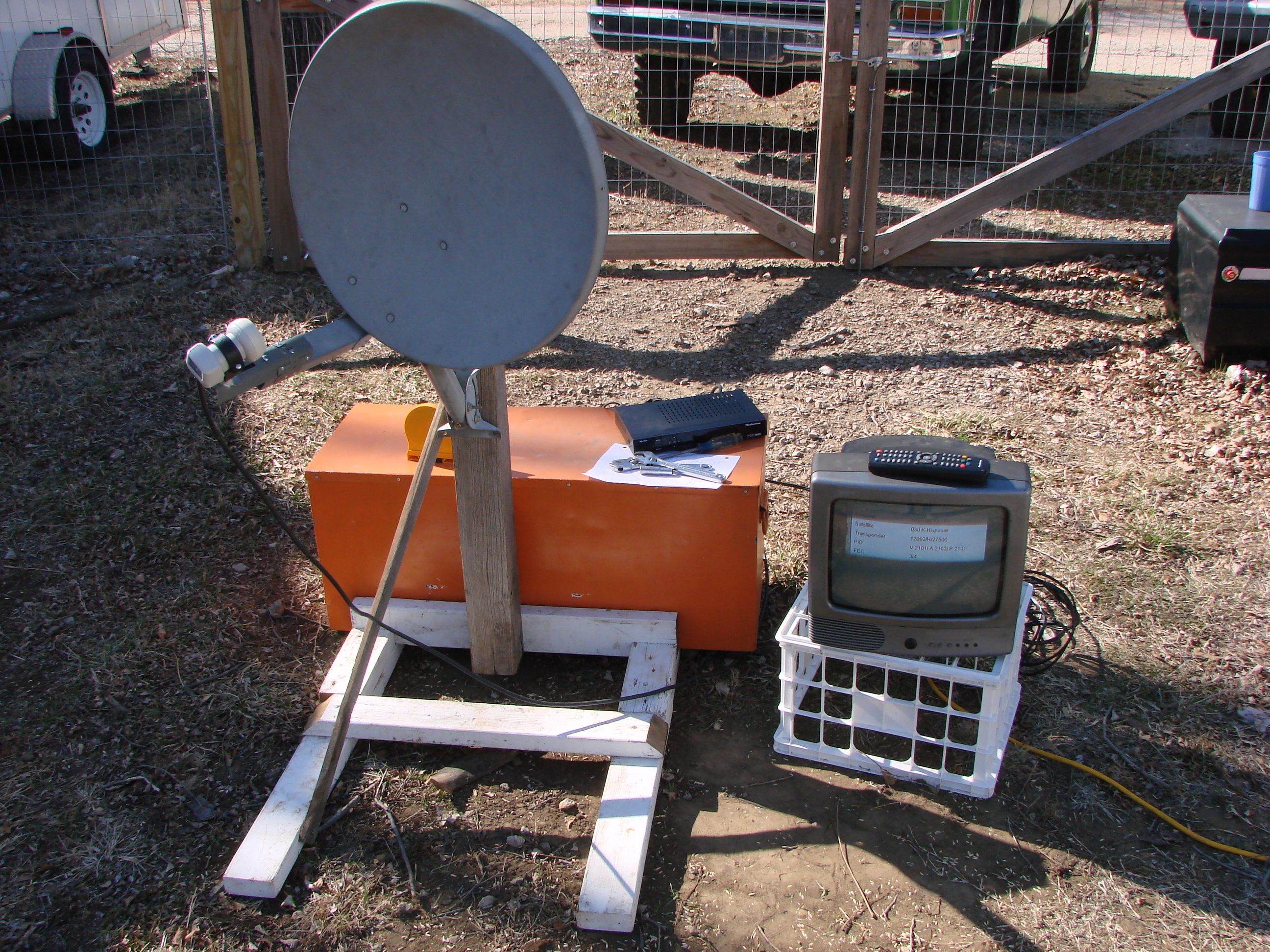

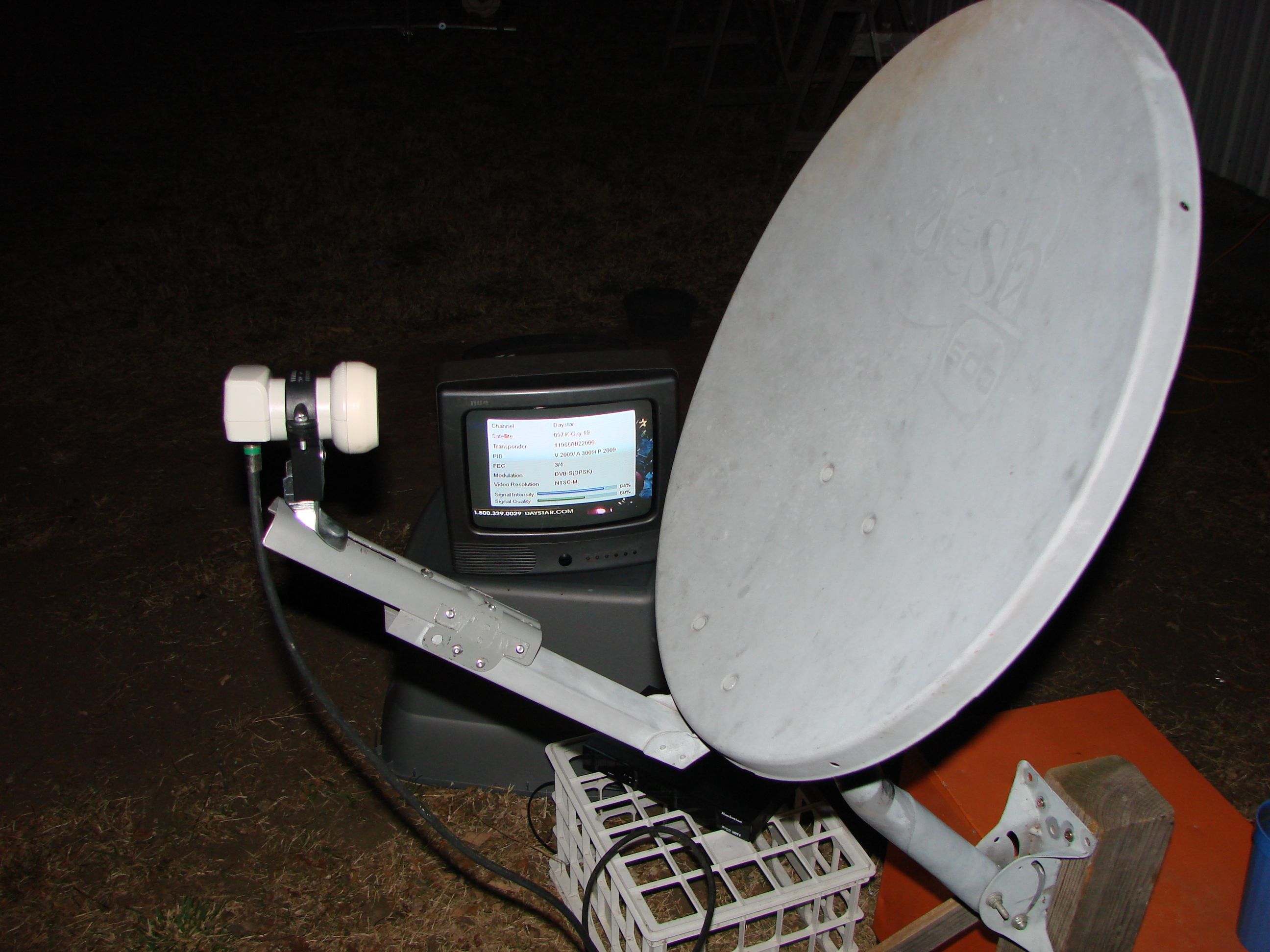

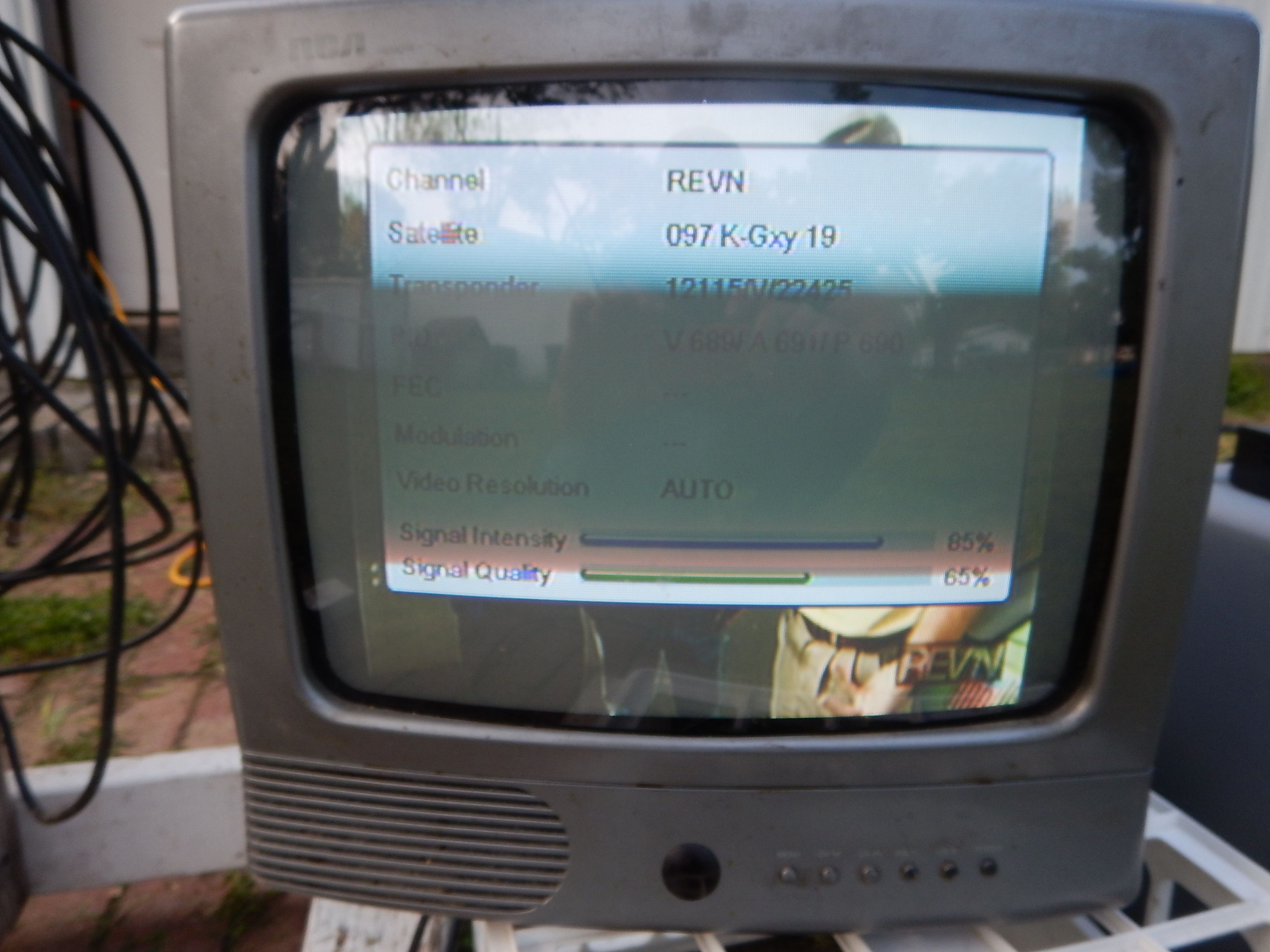

Friday afternoon, I made a skid onto which I mounted the modified dish. Then I brought out a spare TV and receiver. I picked 97W to use for fine tuning the new LNBF setup, as well as to see what could be expected for Q on the receiver.
The initial settings I had for the new LNBF were pretty close. I messed with the height and distance for a little bit until I thought things were as good as could be expected.
Here is the 'new' dish peaked on 97W:
Elevation and skew look fairly normal while on 97W...

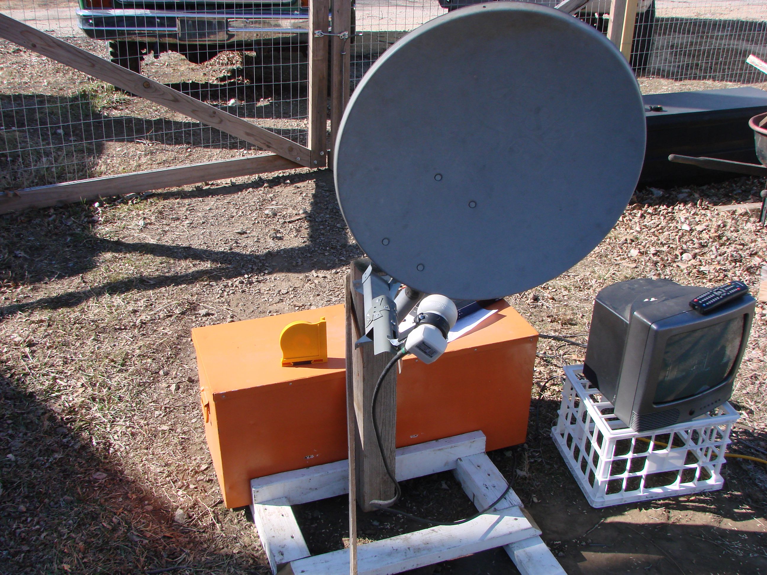

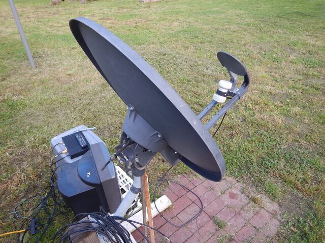

On Saturday, I moved the skid with dish over to an area about where I determined 30W could be found. I had previously entered active transponders manually into the receiver.
I skewed the dish to what dishpointer.com indicated and then lowered the elevation so that the dish itself was nearly plumb. I switched on the receiver and set it to an active transponder and watched the Q. I then lowered the dish and lowered it some more and finally had a lock. I tuned the dish a bit more and then scanned in what I could...

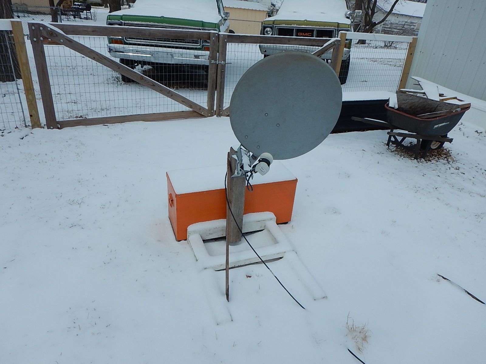

Here are some photos of the dish once I got 30W locked in on Saturday and one from today.
The LNBF arm extension was modified from a bracket I had originally made for an offset LNBF setup for one of my 1.2m dishes...
Thanks for sharing. That's the way it is here looks my dish is pointed into the side of the mountain.
BTW are those 1974 GMC trucks?
Lookin good. Those pizza pans can sure hone your aiming skills! Don't watch too much Sexysat, you'll go blind!
The dish position sure looks odd...
The trucks: left side of photo is a '74 Chevrolet K-10, shortbed 4x4 and the one on the right is a '73 GMC K-2500, longbed 4x4 Camper Special. The '74 was a ground up rebuild/restoration in early 2000's and the the '73 was a rolling rebuild.

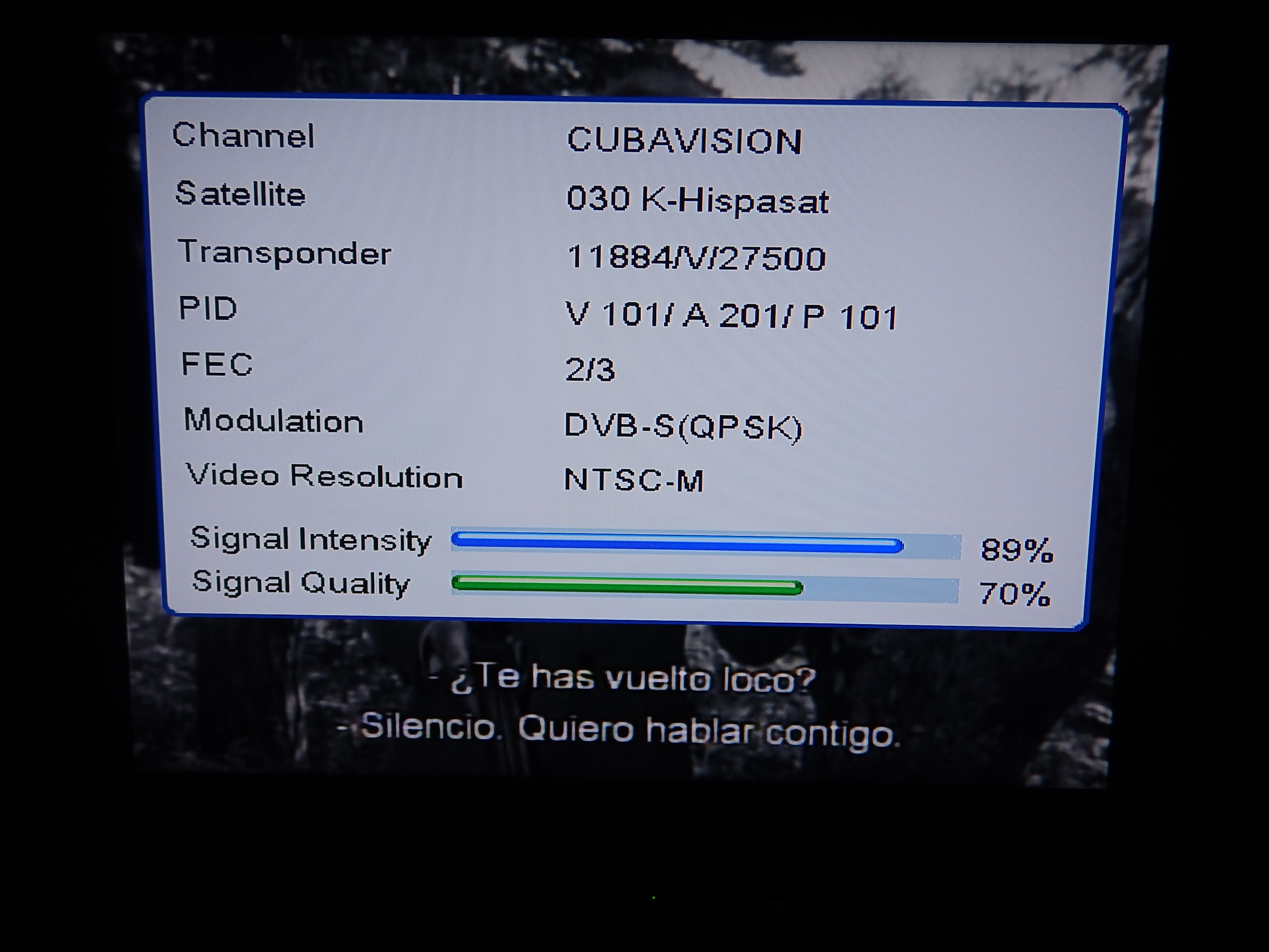

I was sure surprised to see that channel once I had everything scanned! I think setting the dish up on 97W initially helped me with aiming for 30W; however you're right, there is very little margin for error on the little dish...

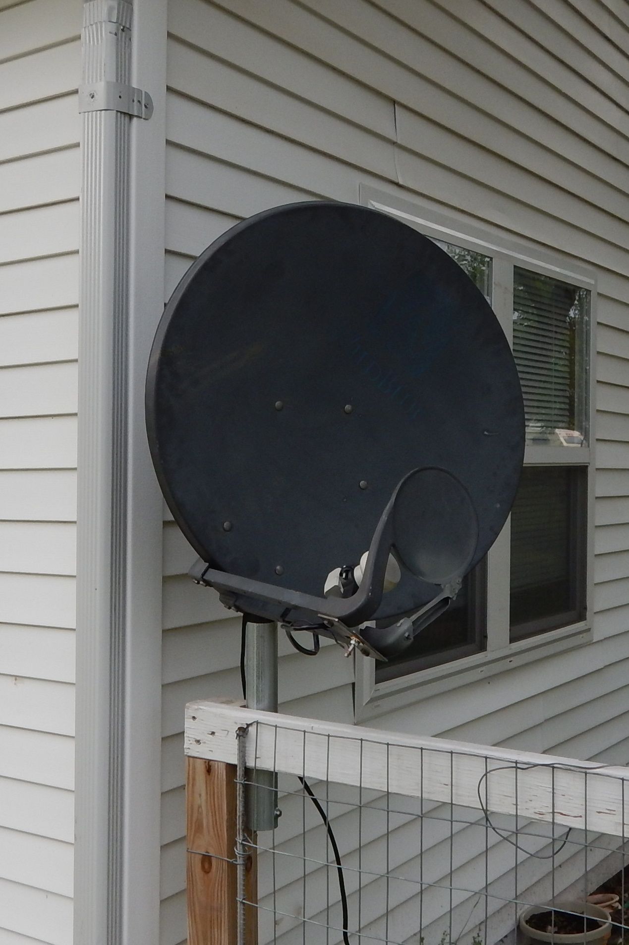

In the meantime, I saw a Wild Blue dish sitting in a scrap metal pile waiting to be hauled off. I asked the owner and they gave it to me. Yippee! I thought...

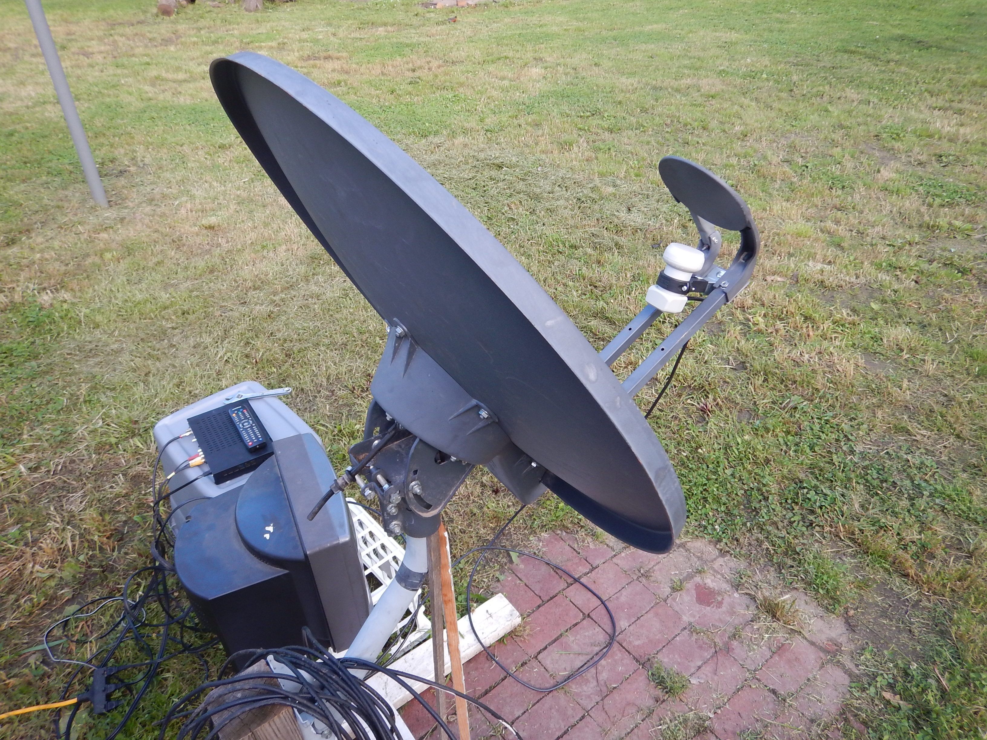

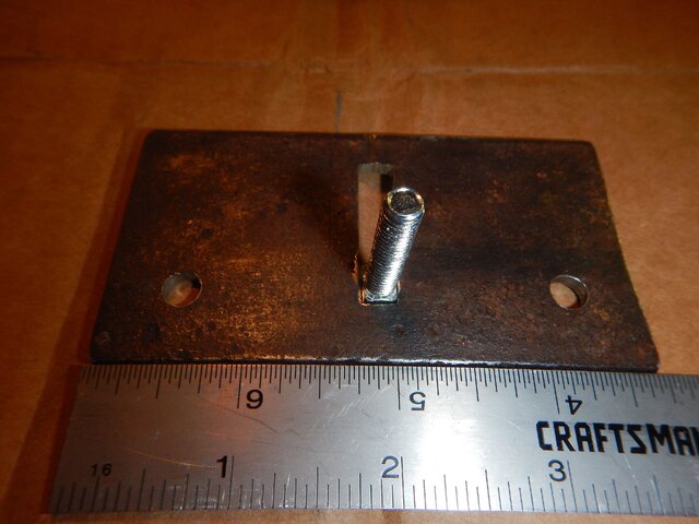

I brought the "new" dish home and shortly thereafter began to fabricate a bracket for an LNBF holder to fit the dish.
To make the slot, I drilled a series of closely spaced 1/4" holes. Then I broke out the metal remaining between the holes and used a file to bring the slot into shape.

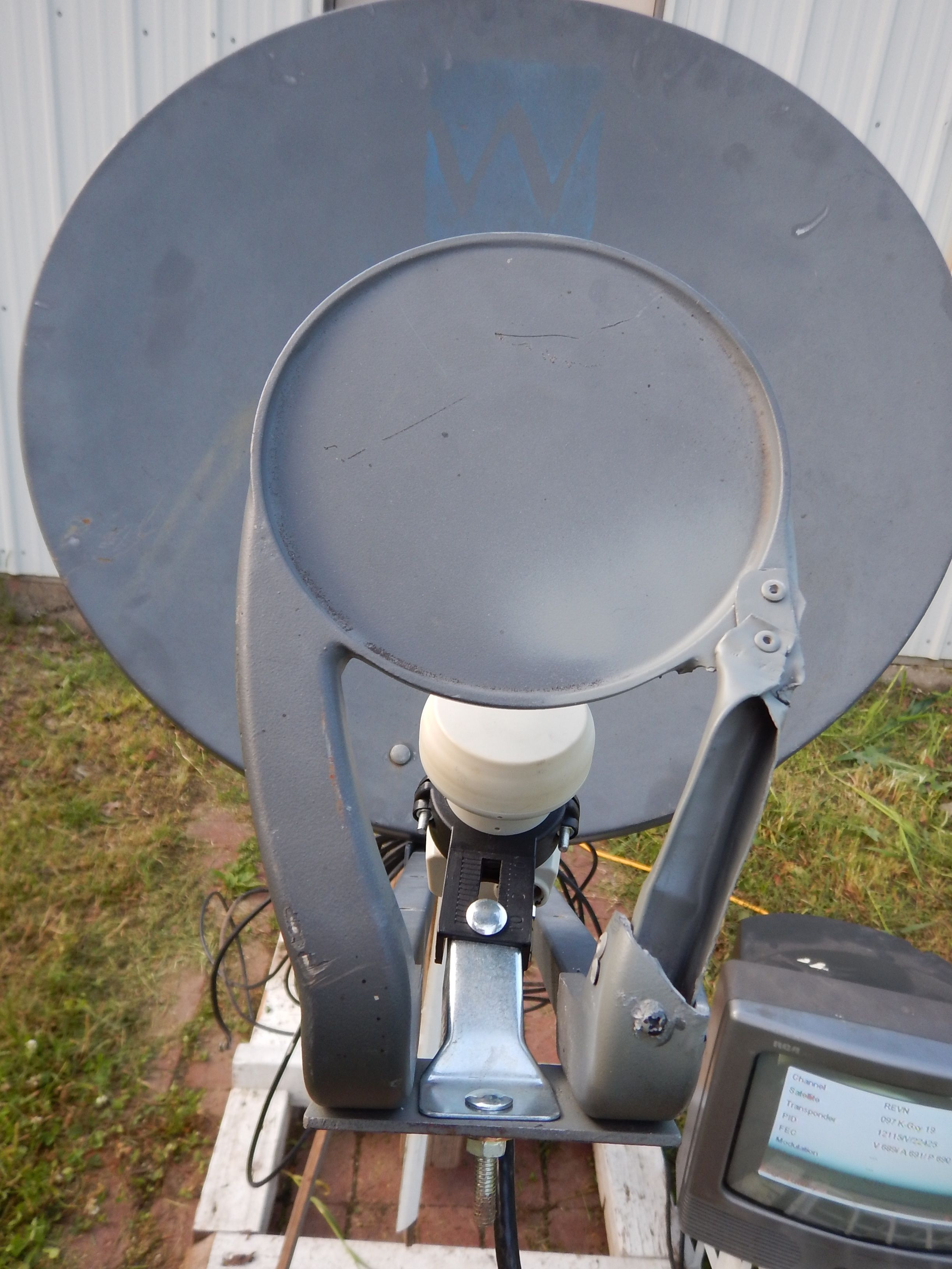

Here is the new LNBF (Titanium Ku-PLL) and bracket mounted to the dish, with the original equipment still mounted for a comparison.
As I began to reassemble everything and do some measuring and looking closer, I discovered the main reflector was twisted and the sub-reflector mounting arms were misaligned (i.e., bent). I think this thing took a hard hit.
I was able to get the main reflector to pop into shape by removing it from mount and laying it flat on the concrete shop floor. I used a rubber mallet and with a few judicious blows, the main reflector popped into place.
The sub-reflector is a different story. I tried to gently pry the arms to reposition them, but no luck. I then tried some brute force which broke one of the mounting arms. Having several hours into the project, I figured "in for a penny, in for a pound" and bent some sheet metal to replace the broken section.

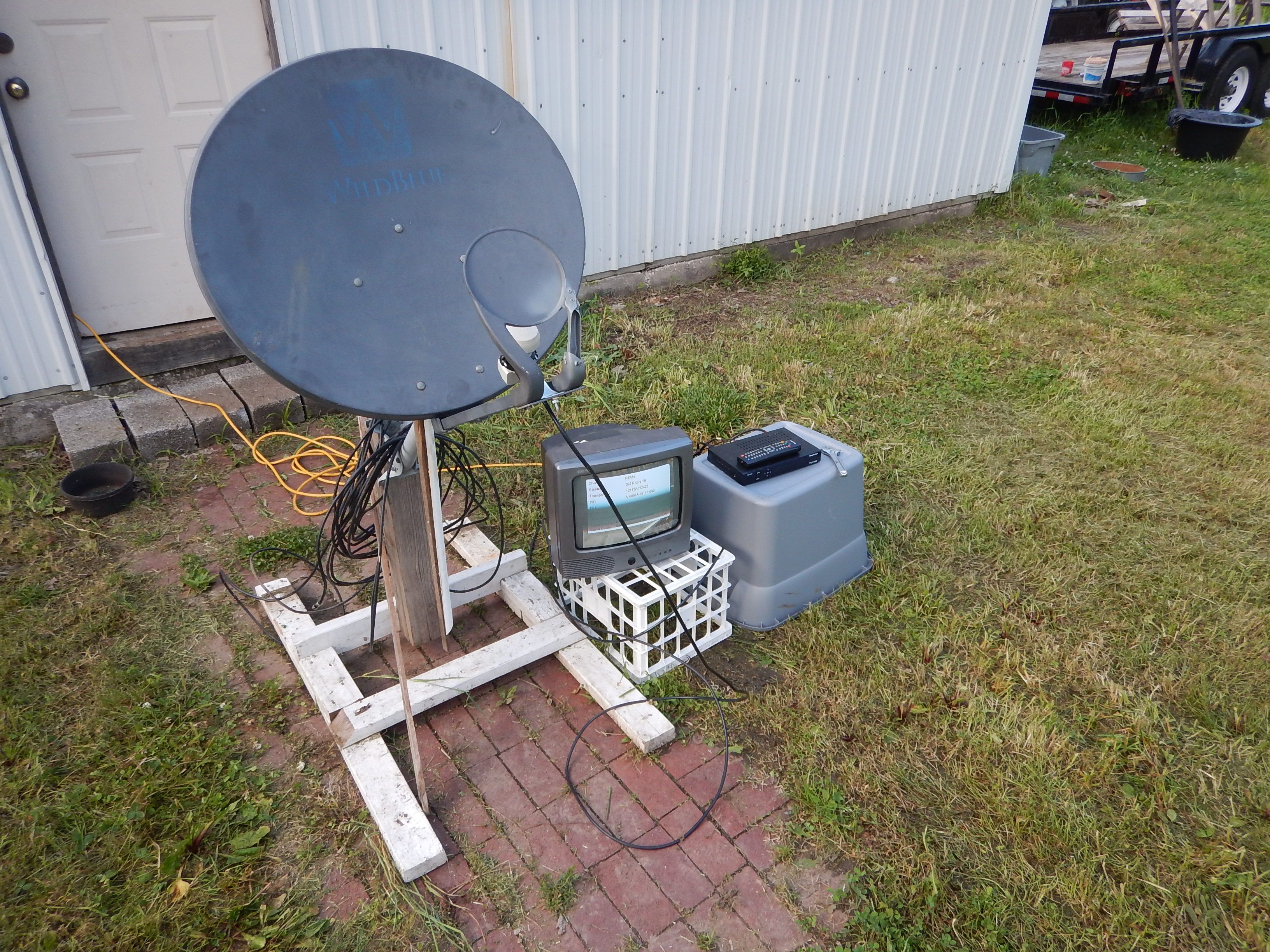

To test the dish setup, I reused the skid with the Dish J-pole. The Wild Blue mount requires something closer to 2-inches, so I just shimmed the J-pole. This was during a break in the rain, so I just wanted a quick test.
Using 97W to try out the dish and with very little adjustment, I was able to get a pretty quick lock. I didn't mess around with it too much. I was happy that it worked with a good and stable Q and left additional tuning for later.
Now that I had some confidence in the dish and after researching on dishpointer.com where I could get a line of sight for 30W, it was time to place the dish. I've been in the process of moving dishes around and had to wait to 'free up a line' to get the Wild Blue mounted.
Once I got the other dishes moved (another story), I mounted the Wild Blue and peaked on 30W. So, here it is mounted and aimed on 30W. As for the mounting, I had to modify some 2-inch I.D. conduit to allow the Wild Blue mount to fit.
