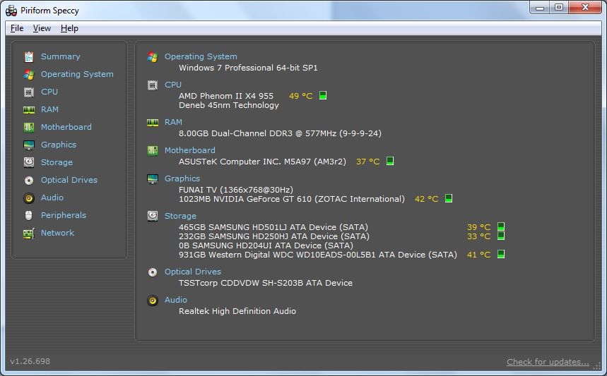

Yeah, might be a heat issue. Install Speedfan or Speccy to see how hot it's getting. 60C is pretty hot, and some PCs automatically shut down around 74-80C to keep from damaging themselves.

For reference, here's what Speccy looks like (though it doesn't recognize the 2TB drive):
