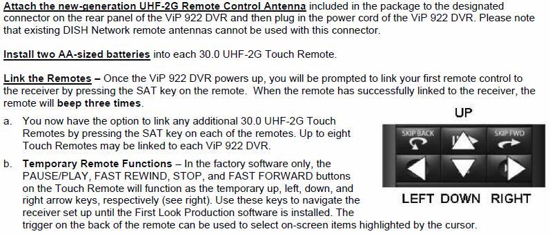

Did you print the 922 job-aid off the retailer care site? If you did and followed the steps on there, then I'm not sure. We had some issues getting started before we knew there was a job-aid. One way to reset the remote is to hold the middle button on the right side of the remote in for 10 seconds. It should beep. Then try linking it again by pressing the sat button. Hope that helps.
mt_hawley, I'm not sure if any people you call at Dish can help. The paperwork I have says not to call Dish, you need to email the private email address found on your paperwork or found at the Dish retailer site.
Here is the Remote Instructions from the Job Aid.
