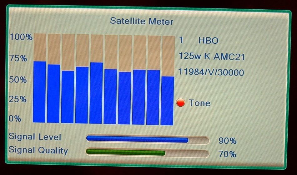

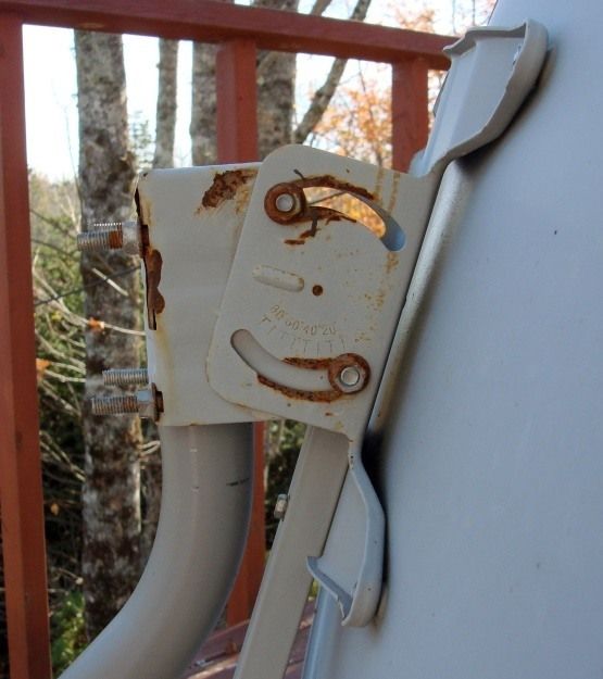

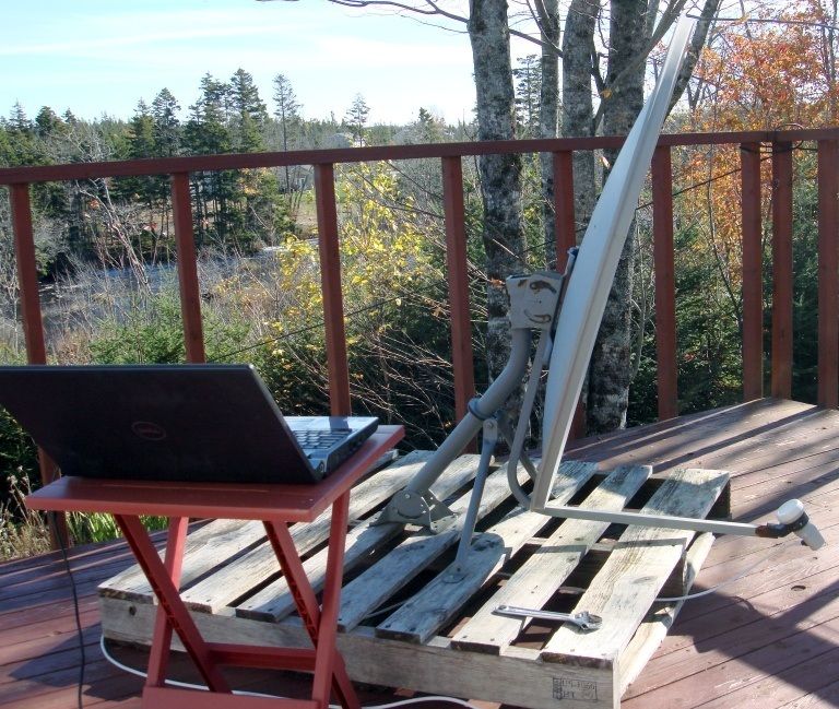

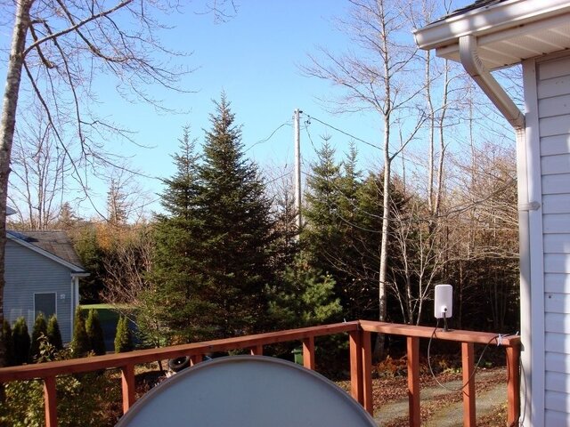

I then actually found AMC 21 for the first time in a long time. The tp that jumped out were the scrambled Claro TV channels. I am now receiving this tp SQ 60%~70%. But...nothing else. No PBS at all! On the PBS frequencies I get a SL indication and a bobble head of SQ but no real signals. I was worried I couldn't get the dish elevation low enough (11 degrees) but I can tell I am going through the Claro TV lobe as I change the elevation so I should be good on elevation. Here's what the dish looks like now in my "outdoor lab". 121W through 125W are about at the telephone pole in azimuth and just above the pole in elevation.

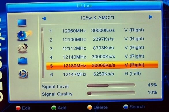

I've tried all that I know of: 12106 V 2397, 12112 V 8703, 12180 V 30000. No receivable signal. I know for LPB at 87W that night time signals are significantly stronger.

All three tps are entered and I see SL 45% with peak SQ 10%. I've tried panning the dish across and up/down while monitoring all three entries.
