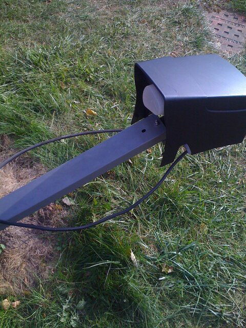

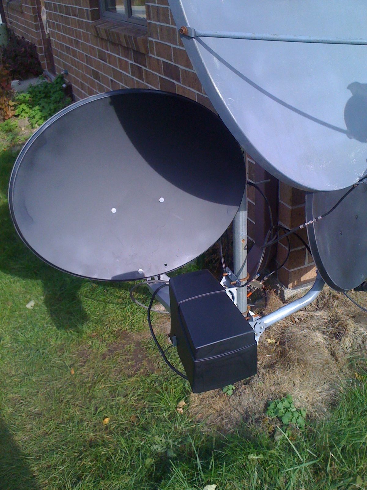

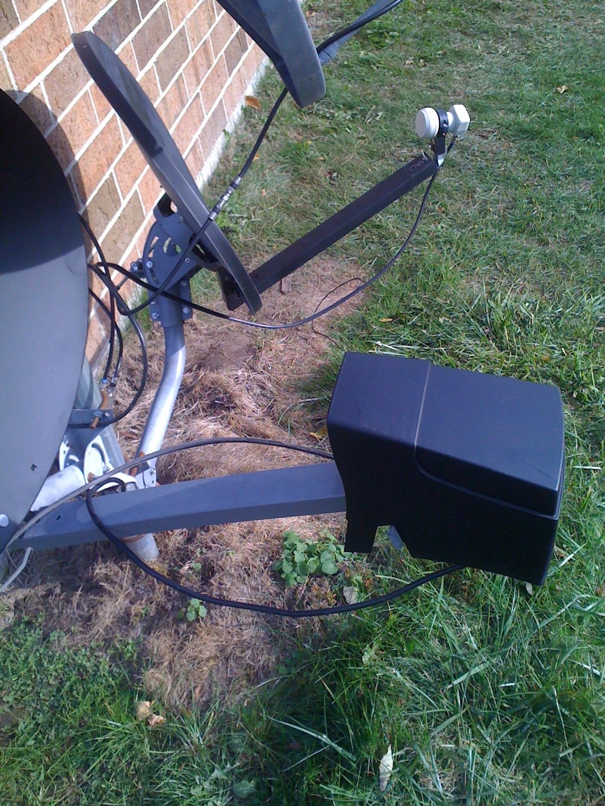

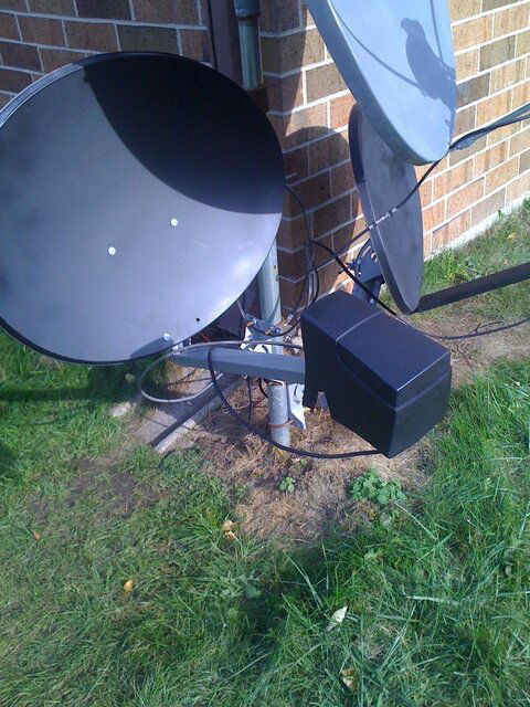

No motor for any of this. I'm using my fixed dish just outside window from receiver and short RG-6 cable. If there were more satellites further west, I could keep panning west and get them. Running out of ideas.

Not sure if that 12036 H 3725 tp is active now. But I have a strong Claro TV tp on which I have oriented and I'm satisfied I'm centred on AMC 21. While monitoring each PBS tp, I gently tugged in each direction on the dish (east/west, up/down) and I could see the SL / bobble-head SQ readings go down. I also changed my LNB to a SatelliteAV SL2 (non-PLL) and I get virtually identical results for all tests.
I'm using both a microHD and an S9 so both are capable of DVB-S2 and HD. If necessary, tomorrow I may go steal my PLL LNB from my motorized dish and install it on the fixed dish to see if it makes any difference pulling in AMC 21.

Have now tried my Avenger PLL LNB and results are the same. This was my final ace I thought might resolve this issue. Tough to understand how Claro can be so strong without a peep from any other tps.

Ima join the crowd, hehe, only thing I can get on my motorized 1m is the claro scrambled stuff, nothing else. Wondering if trees might be my problem though, and after seeing cybers pics, I wonder if his evergreens are partially blocking him!

I'm going to do more checking today using my Android application to confirm 11 degrees elevation to AMC 21 will clear my local trees. Perhaps earlier when I checked this, I did it standing up beside the dish (6-feet above dish) instead of groveling down on the balcony floor where the dish is sitting. All indications are that I'm just not receiving enough signal from the PBS tps.
