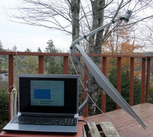

What approximate dish angle with respect to vertical should be used for an offset dish aiming at a satellite at 11 degrees elevation when dish is inverted?
Well the inverted dish will be pointing up at a greater angle. Deyond that my brain is not in dish mode. We are setting up for the kiddies tonight. Usual is about 80 -100. The forecast is 18c with mucho rain.
Dish Looks Different; Same Results
Inverted Off-Set
Take off Angle = 90 – (prime focus + offset)
Where 90 = vertical plane of reflector
Prime focus = calculated elevation based off of lat and lon of earth station and station
Offset = manufactures off-set of the boom/feed assembly to reflector surface
Therefore for AMC 21 @ 11 degrees elevation:
Take off Angle = 90 - (11 +22) = 57 degrees
0 degrees: horizontal; 90 degrees: vertical
Note: When you invert the dish, you do not need to change the skew. I know because I did and had to change it back!
Here's what it looks like:
