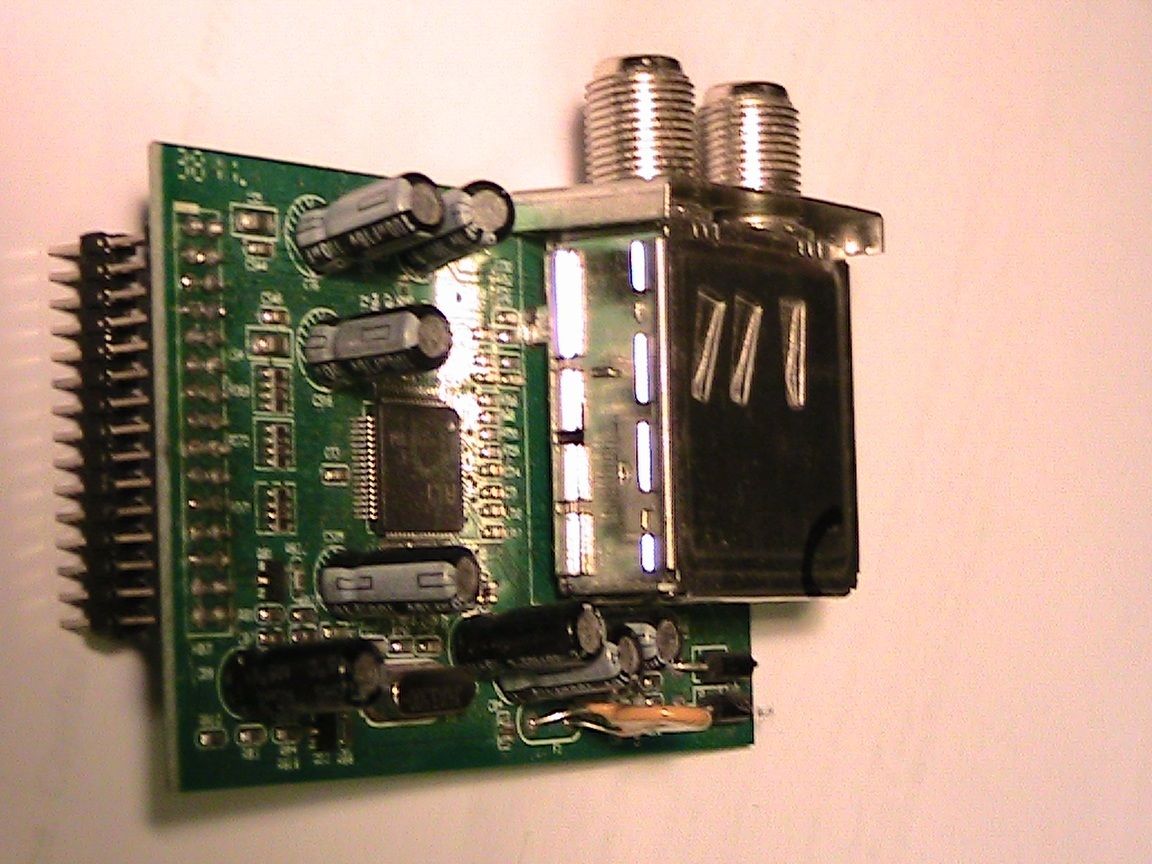

can you post a picture of what you need?? there are several s10 models out there. What happens with yours?? I have some spare parts from some S10 and could probably help you
tuner board 004.jpg this is the tuner board for the openbox s10 this boardhas no H or v voltage out put have check power to it ok. thanks
most of the time the tuner just isn't seated correctly in the socket.
BTW with no tuner installed,the receiver kicks into clone kill mode- so beware.

View attachment 92397 this is the tuner board for the openbox s10 this boardhas no H or v voltage out put have check power to it ok. thanks
Coming No Power or No Signal to the output IF connectors can be cause from another sources on the power supply or main board, do some search in the forum, there are several post about it.
