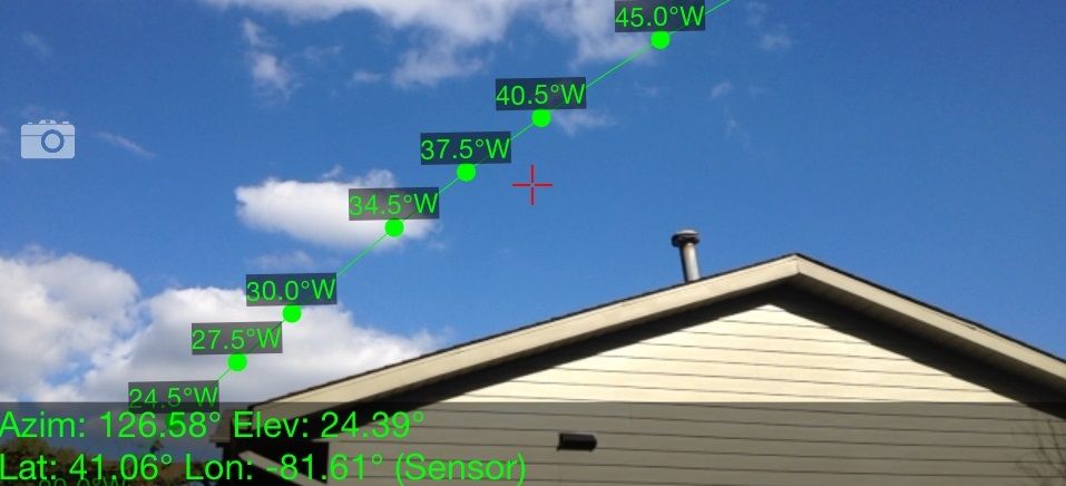

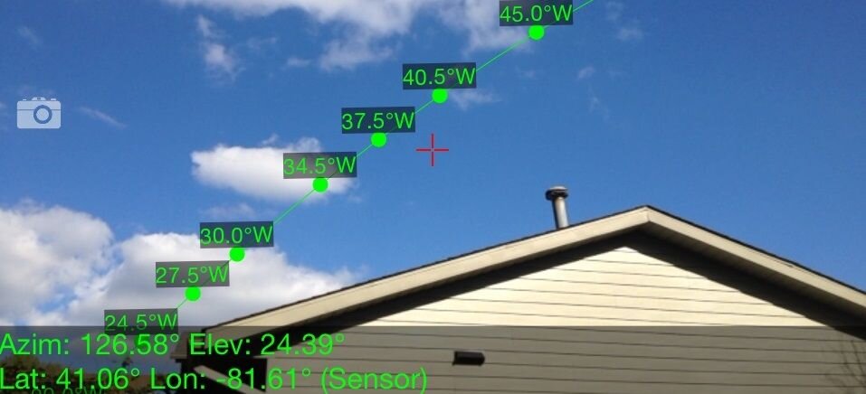

Here in Ohio Hispasat 30W is just a hair below 20 degrees above the horizon. I used a satellite locating app on my iPhone to see where it is located in order to place my dish in a good spot, and I had to strategically place it so that I can clear the neighbor's house. This is what I'm talking about (see photo)...
