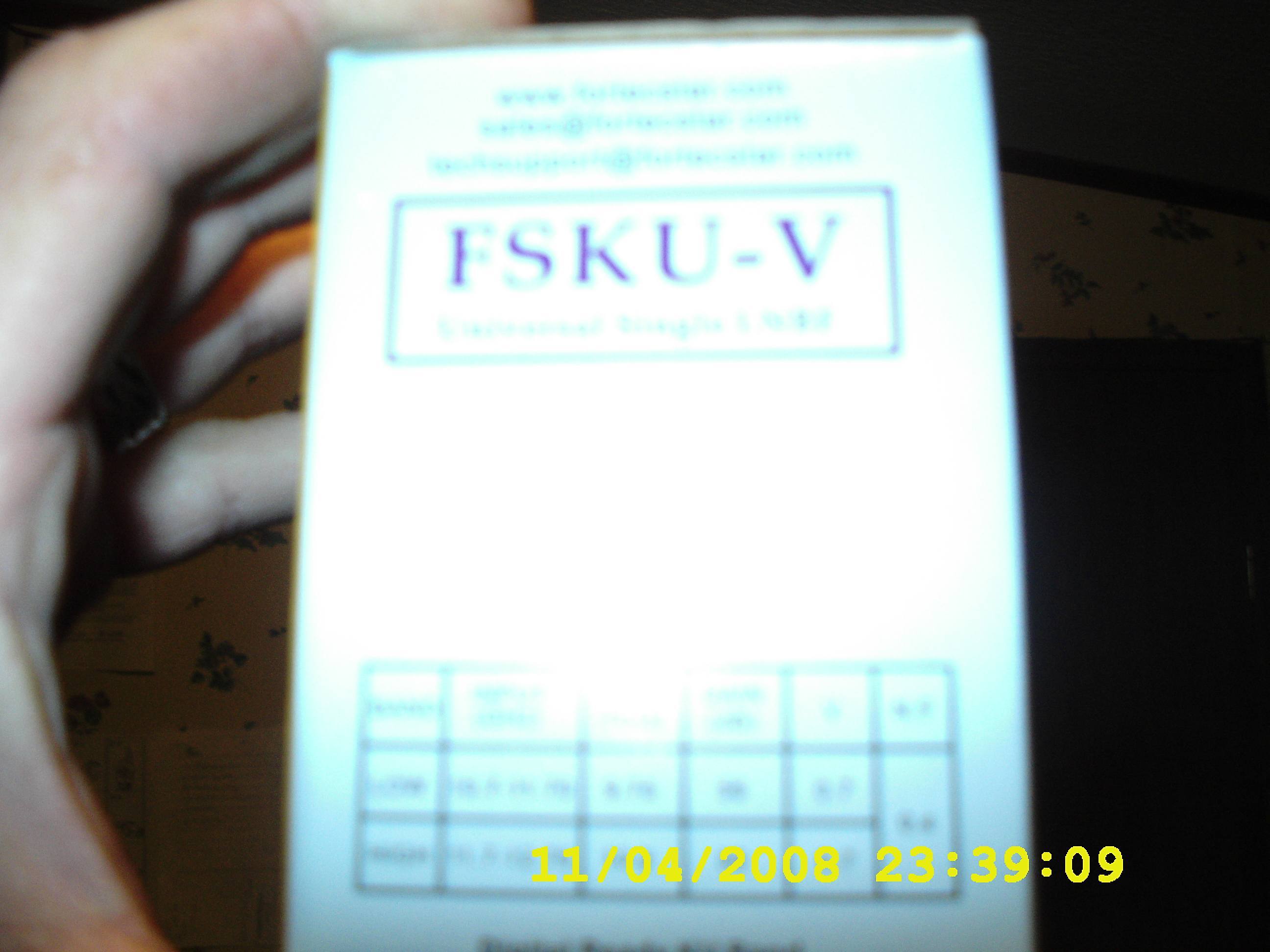

OK, the brand is Fortec Star. Universal Single LNBF, model FSKU-V
LOW
Input 10.7-11.7
LO 9.75
Gain 56
V .7
NF .4
High
Input 11.7-12.75
LO 10.6
Gain 56
V .7
NF .4

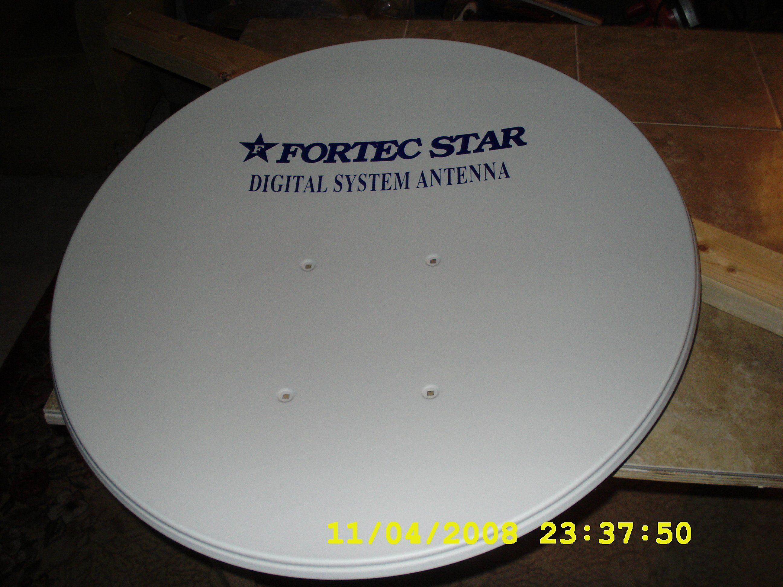

The open case of dishes has three dishes but only two polar plates and only two lnbfs.

Trying to post pics now. Dish is 30"x32".

A Fortec FSKU-V is a single output, universal LNBF. I used to have one on my G-18 (at that time G-10R) dish, but I ditched it in favor of the correct feedhorn/LNB assembly for that dish.
In your receiver settings, it is a universal, with L.O. of 9750/10750. These will work for linear Ku band, but since they are universal, they limit your use of 22k switching.
So I would be better off using the old dish network bandstacked lnbfs? What does the 22K switching do?
The 22k switching on a Universal LNB selects the low and high band
The Universals will work great on that Fortec dish. I've used universals but switched to standard LNB's because they give more flexibility when adding switches
