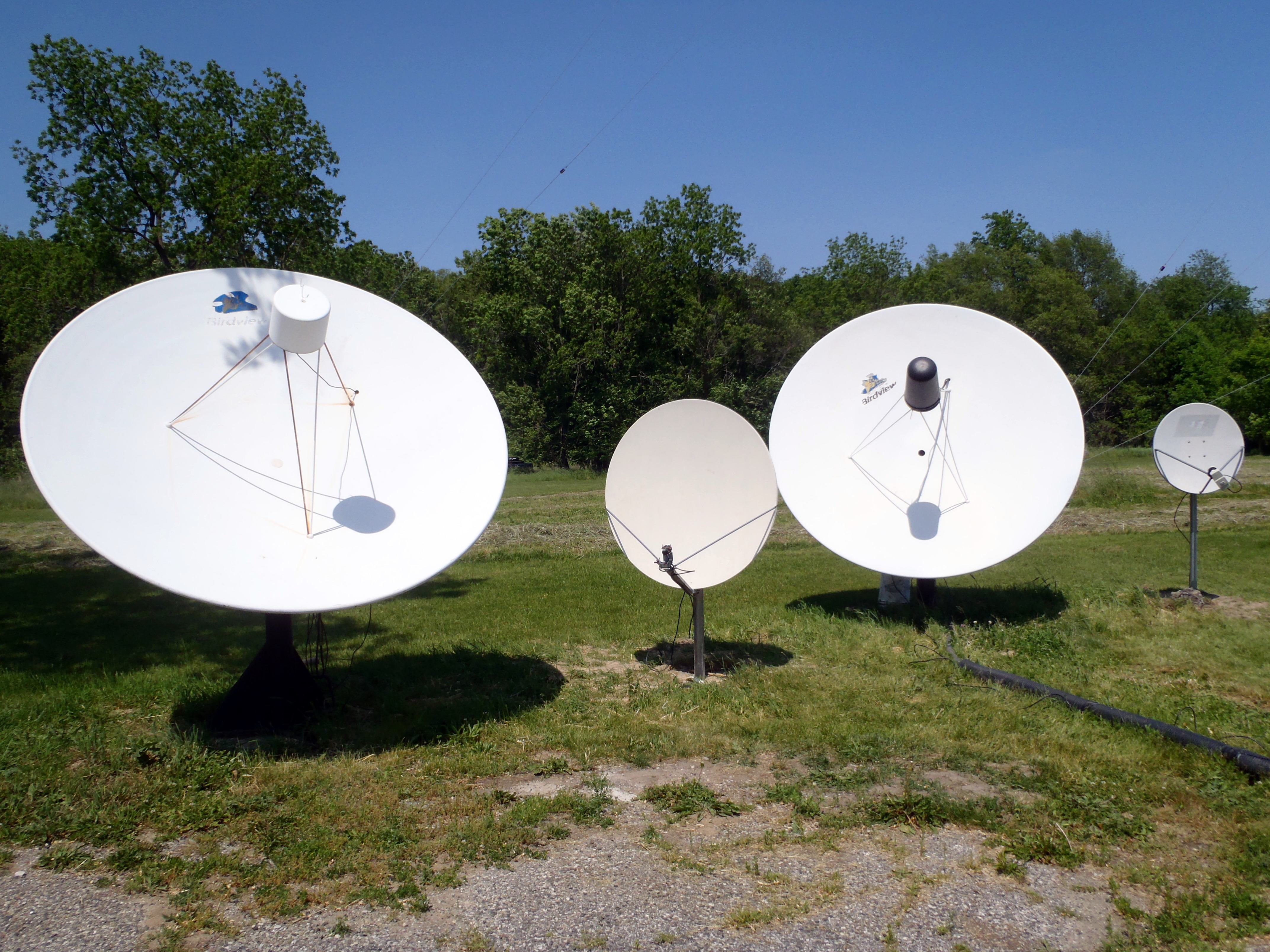

Cozi on 103 KU is 24/7. It's not an easy transponder to keep locked in mid Michigan 100% 24/7 though. I'm using a dedicated Prodelin 4 foot dish, SatAv PLL lnb, and a MicroHD receiver, and I still get some issues now and again, even in perfect skys.
Though with the 4 foot dish, it's much better to stay locked than the Channel Master 1 meter dish I used before.
Oh yeah, and YES, I am adjusted to the 'special skew" for this satellite.
Might be time for me to swap the larger ku dish to grab COZI for this (between the birdviews) and move PBS (currently on that dish) to one of the former DTN Channel masters! I haven't noticed the real "need" for PBS to be on a larger Ku, it just was nice to not have to run the BV motor all the way down.
Thanks for the info...sounds like a "hunt" worth the doing!
