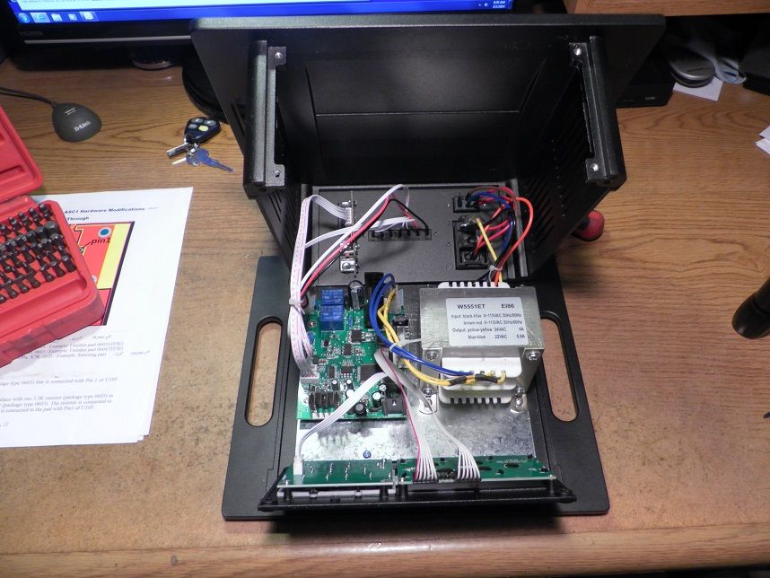

Here is one undressed. You won't find plastic here :)
