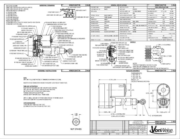

I've been over at Von Weise reading the descriptions of the actuators. The one for $199, the drawing says 33" retracted and 24" extended. That's not right! Then the $269 one says 33" retracted and 57" extended, that's right. Both are 24" stroke with reed switches.
I'd rather not spend $225 on a new one but I'm tired of messing with it and I can fix this one later. They have acme nuts for $20 but they want $20 to ship it and I can get a whole actuator shipped for $25, go figure.

Then they have this for $199, the one that's listed wrong in the drawing or I think it is, has to be.
DC Actuator 36 VDC, Full Load Speed 11 inches/minute, Gear Ration 19:1, Full Load Thurst 600 lbs, 1/15 HP, Current @ Full Load 3 Amps, Reed Switch. Substitute for Dayton 5A651.
http://estore.vonweise.com/vw7636vdcactuator-1.aspx
This one is $269.
Solar Panel/Satellite DC Actuator with Telescoping Tube Assembly. 24-36 VDC 1/15 HP Bidirectional Permanent Magnet Input Motor. 600 lbs. Full Load Thrust. Linear Velocity at Full Load Thrust 6.8 – 11.0 in/min. with 24 Inch Linear Stroke. Reed Switch Feedback Control. Limit Switches for overall stoke control. Enclosure Totally Enclosed Non-Ventilated. 19:1 Gearbox Ratio.
http://estore.vonweise.com/v76-5actuatorwithtelescopingtube.aspx
This one is $229 and not too clear on the details on length etc.
Solar Panel/Satellite DC Actuator with Telescoping Tube Assembly. 36 VDC 1/15 HP Bidirectional Permanent Magnet Input Motor. 300 lbs. Full Load Thrust. Linear Velocity at Full Load Thrust 11.0 in/min with 24 Inch Linear Stroke. Reed Switch Feedback Control. Limit Switches for Overall Stoke Control. Enclosure Totally Enclosed Non-Ventilated. 28:1 Gearbox Ratio
http://estore.vonweise.com/vw-24lcactuatorwithtelescopingtube.aspx

Ok, so I emailed Von Weise and Alan Signer cleared things up a bit. I still don't know the exact differences between the "V00212AT76 - VW76" and the V76-5 Actuator with telescoping tube. They both have the same tube mounting system with individual aluminum piece and the butterfly hole pattern instead of the three molded mounting tabs or whatever you call them. He also didn't tell me the resolution of it but I ordered the V00212AT76 - VW76 for a total of $225.70. The V76-5 has 8 magnets for a 48 count and the diagram he sent me shows only 4 magnets for the V00212AT76 - VW76 so that would make it a 24 count. They're the same horse power and speed (gear ratio 19:1) and I still don't know all of the exact differences.
I hope this is the one that is like the ones I have, he said it is but with a reed switch (mine was optical, I converted it). There is a model with a cheaper looking limit cam setup and I like the 2 screws to set the limit like I have now. I'd gladly pay the difference for the good one if it's that much better. If you're spending $225 you might as well go $300 if that's what it takes!!! If count is all it is I'll change it if I have to. I have magnets, nice small powerful ones that I can fit right on the wheel. I did email him back and ask for a couple of more details including the count but it was past 5PM. I think he assumed I could figure out the count and if it's 4 magnets then it has to be 24, and that's 24 per inch of extension.
I told him the models are confusing and he said that there is an error in the listing for the one I ordered. He said "The retracted dimension is 33.75" and the stoke length is 24.0". The print has a typo, it should read 24.00 ± .50 extension".
You can order them with "options" so there is no telling what you get if you buy a used one. If you get one that looks the same as yours...those options under the cover could be anything from a potentiometer or an optical setup. I have a feeling I should've gotten the $269 one, but if it's just the count, well, I wouldn't pay that much more when I can modify it so easily.
I'll let you know what arrives, photos and all. Here's the diagram he sent me. I haven't found it on SG but it's probably here somewhere. So I'm tagging this one as a Von Weise V00212AT76 - VW76 diagram or a Von Weise V00212AT76 - VW76 assembly drawing and I reduced it to 1920x1484. The original TIF image is 6600x5100 and I'm attaching it as a zip file so you can keep it if you want. The resized one is still readable but the original is much better.

The number of magnets affects the pulse count and some receivers have a problem with a high count actuator. The 4DTV is one. The 4DTV counts each pulse twice so a high pulse actuator causes it to miscount and you'll find your count settings for each satellite start to migrate. It's a good idea to determine what your receiver is comfortable with before ordering a new actuator and I agree, the ball screw is the way to go.
Reactions: Cardinal 177a
I'm using a Gbox and I converted my other Von Weise to a magnet wheel. It has 6 and the Gbox loves it. It doesn't miscount and it'll move by 1. When it was optical it was rare to get a 1 count movement. Others here have tested up to 16 magnets on a Gbox and it works. It would handle an 8 magnet wheel just fine but I'm afraid the one I ordered is 4. I'm not worried about it unless I have a hard time pinpointing Ku satellites. Their magnets could just be removed and smaller, stronger ones installed. They're so small they would fit between the mounting areas provided on the wheel.

So this new actuator is built cheaper. The limit switches are not screwed down, they slip down on plastic pegs and there is a foam pad that holds them in place when the cover is on. I folded a small strip of paper and put it through the hole on the switch to tighten it up a bit and now you can test and adjust the limit switch with the cover off. I often use a small drop of pancake syrup for temporary glue. It makes it sticky enough to hold in place but it's still removable. Over time as it dries it can really glue something good so I didn't use it this time. It would be hard to get something in there to soak it loose.
Also, only the extended position switch is adjustable. The retracted position is fixed. I still don't know the exact differences between the V00212AT76 - VW76 (mine for $199) and the V76-5 except that the V76-5 ($269) has the old style limit switches and 8 magnets where this one has just 4 magnets and the cheaper mounted switches. They are standard switches though. I think you could remove the plastic pegs and thread the holes (if they're not already) and use bolts to hold them in. This one says 24-36 volts but the description on the site just said 36v for both of them. If cheaper limit switch mounting and only 4 magnets is the only differences and you save $70, I'm happy. Both of those can be easily modified.
