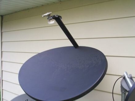

My FTA dish that I have been using for 8 years is showing signs of a surface type rust. Any ideas on the type of paint I can use that will not affect the reflectivity?
Any old non metalic/gloss paint will work! I like to use matt/flat black :)

BUT my rust is basically surface rust and only on the steel center Button hook mount...the rest of the dish is aluminum!
