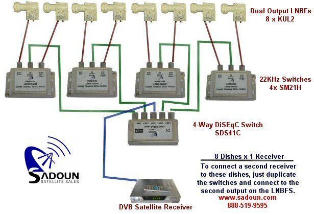

here is a picture of a 8 LNB setup

as for your option the only way is to use the loop out function on the receiver to go to the PC card. The card would get the same polarity as the reciever gets and if the receiver is off, the PC card should be able to get both polarities with no issues
Thank you for answer. I understand I cannot use a 22khz switch as I use Universal lnb. This i did not know that when my receiver is off my pc card can pass thru the receiver up to the dish.
correct. You cannot use a 22k switch with a Universal LNB. Here in No America the only satellite we need a Universal for is PAS9 at 58W. Otherwise standard LNB's work fine :)

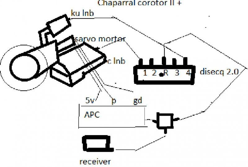

Can you please check my connection and advise me why am not getting KU on this attachment. am receiving all C band without a hitch, but non of KU
:welcome to the forum Nyanjua. There could be several problems causing this symptom. The two most common would be; 1. your dish is not peaked for Ku frequencies. Check to make sure you are aimed correctly. 2. the DiSEqC switch is faulty. You can short out a switch or port on a switch if you do not shut all the power off to your system when connecting and disconnecting switches and LNBs.
Copy that ! I guess might be both. I read on a thread somewhere instruction on how to install the feed horn. My ku band is below the polar axis. About the diseqc. I might wanna change from 1and 4 to 2 and 3
I meant", Chaparral corotor feeds are installed with ku band on the upper side of cband and Inline with polar axis. This is from a forum i read here..
When you look at the feed it shouldn't look inline with the polar axis. It should be 45° angle to the polar axis. The probe is moved 45° from center when energized, one way for horizontal and the other for vertical. Is the probe moving?
