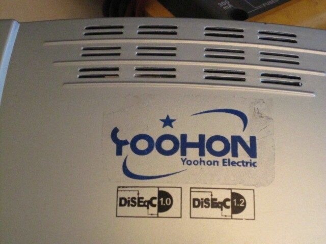

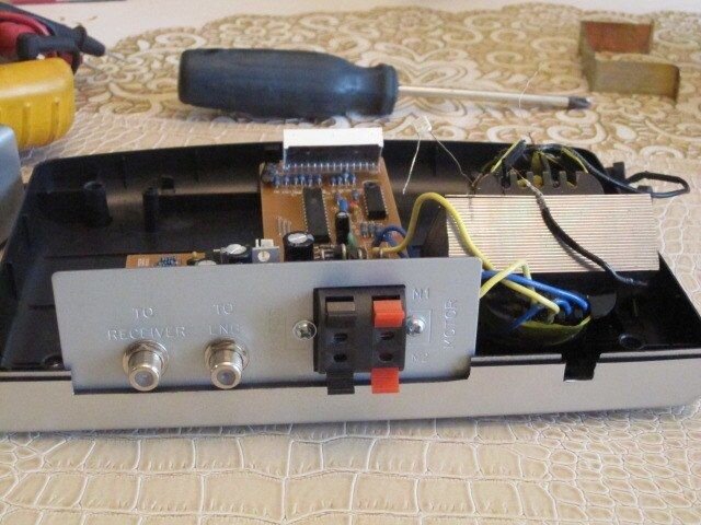

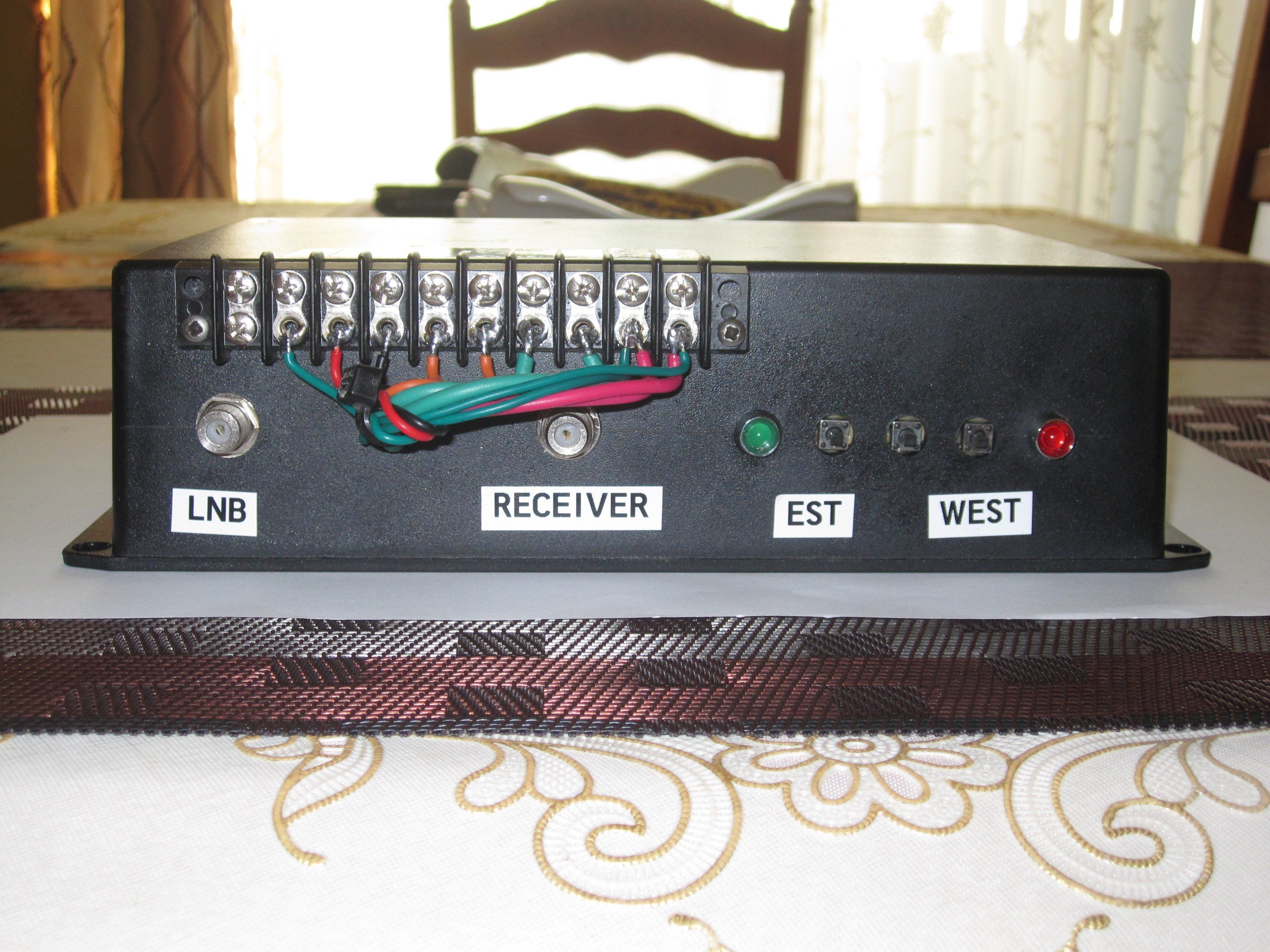

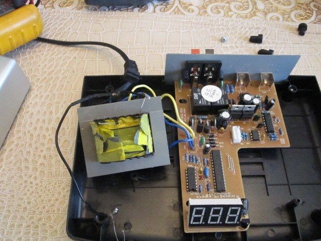

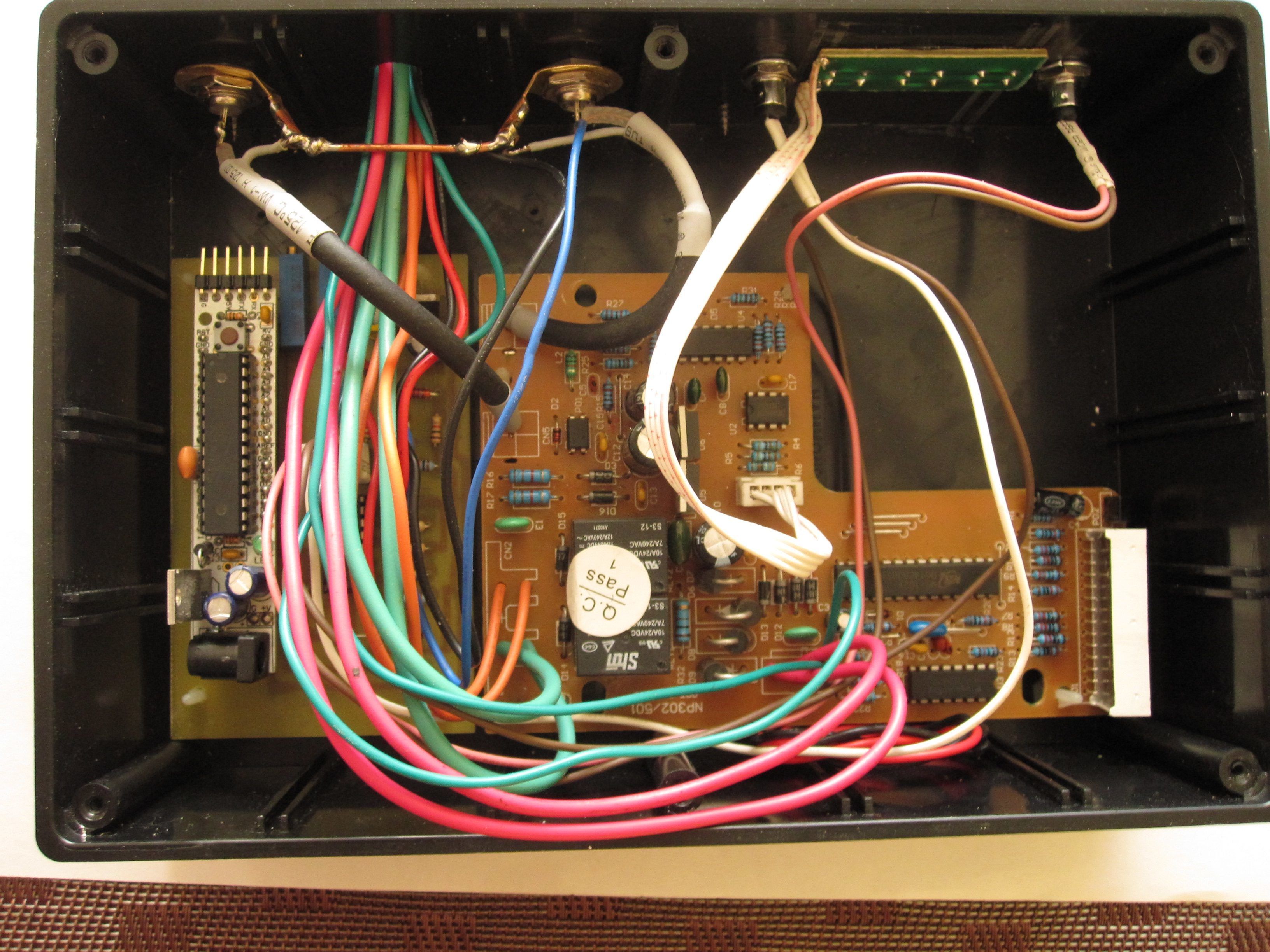

I have one v-box x and it is working fine just that the tranformer that come whit it is very ship it have one termic fuse inside and it burn out because the transformer get realy hot , so i did some change and integrete whit my servo control and I put it on my dish , like this I just have to send 36 vcd to the dish and the rest it is don up there , for the 36 vcd I use the transformer from a old analog reciver taht it is on my balcon, here are son pic of this project posicioner & servo control 009.JPGposicioner & servo control 013.JPGsatelite 6' 060.JPGsatelite 6' 061.JPGsatelite 6' 062.JPG
