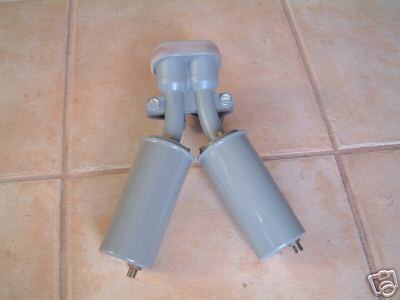

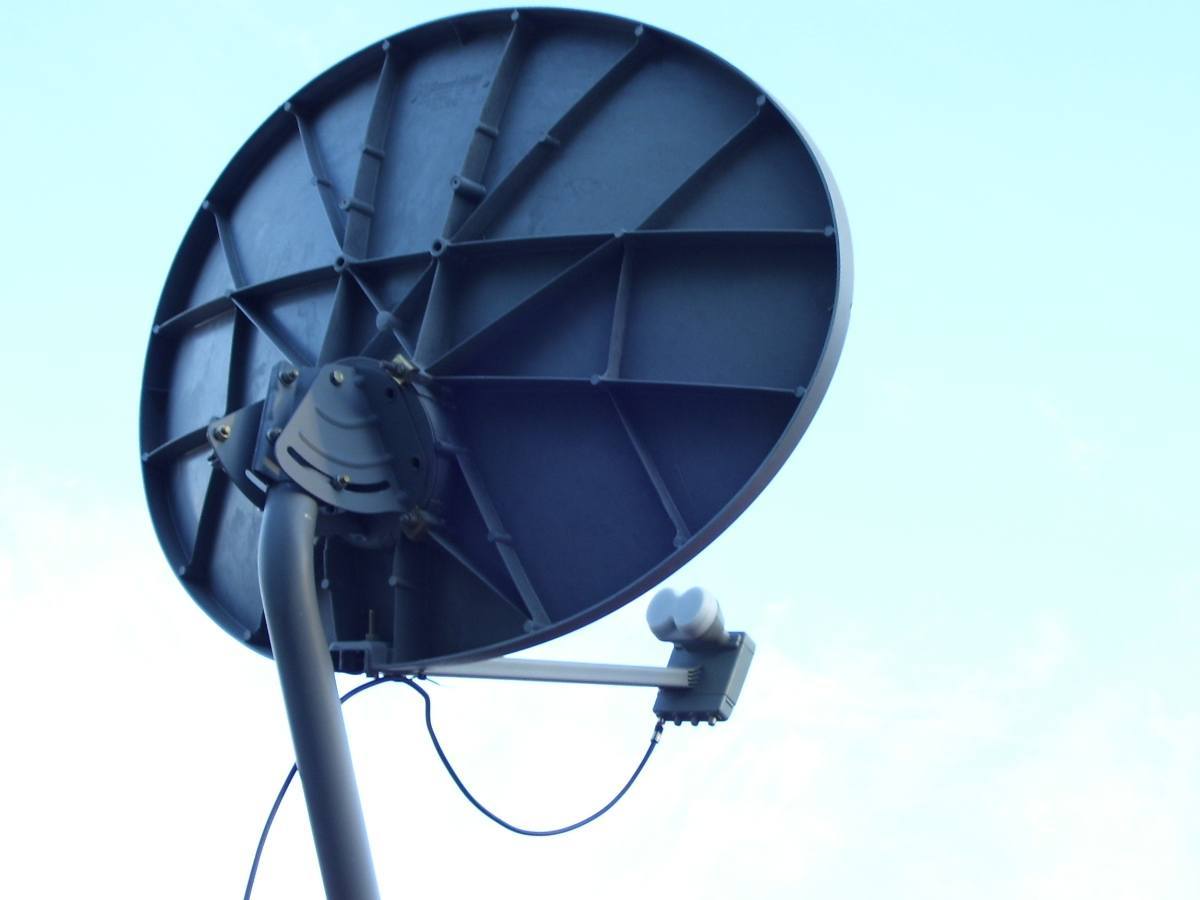

What LNB is it? There are 2 models
the older one had two "beercan's" and a special switch. These are stacked LNB's

the newer quad which has 4 outputs
attachment.php
If its the quad you have 4 outputs to hook up to the receivers. Unless you go above 4 tuners you wouldnt need the switch
if its the beercan I **think** you plug the 107.3 sat into 18v and the 111.1 to the 18v+22k side
