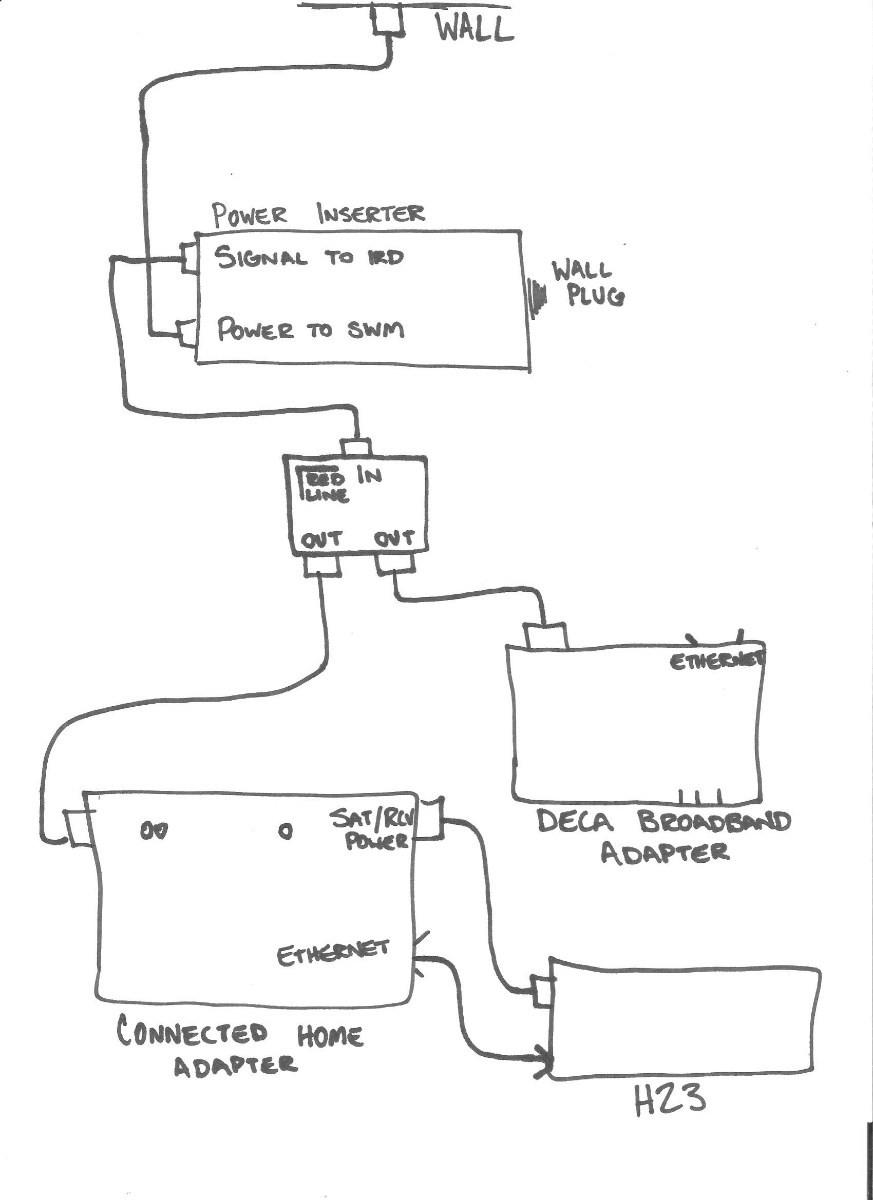

I ran the test on the HR24 and it said No Internet Connection and No Network Detected. As for the H23, I have the DECA box hooked up to it. Whether or not it is setup correctly I can't tell you. I'll see if I can make a diagram of how my H23 is setup.
Here is a diagram I made of how the H23 is currently set up. I'm assuming I have something in the wrong place.
The HR24 is plugged directly into the wall. I have a router and modem, I'm not sure if they should be plugged into anything.
Your diagram looks good, are all lights solid green on black and white boxes? And is the black box connected to your router?
Sent from my PG06100 using Tapatalk 2
All solid green lights on black and white boxes. The black box (broadband adapter) is not connected to my router. Should it be?
Yes, thats the reason theres no internet. The broadband adapter connects to your router via ethernet.
Everything else looks good tho, and your whole home should be working, even without the internet
Yes the broadband deca needs to be connected to your router, this is where the system gets its internet from. What i would do is unplug everything except your power inserter. Both receivers and the broadband deca, connect the deca to the internet and plug it in, it should link green with power and network, plug the hr23 in next, when it comes online clink should go green, once the hr23 is live and you are watching tv, plug the hr24 in. Then follow dfergies instructions in post2 when you have tv on both boxes after hard resets.
Thanks for all the responses! It is an H23, rather than HR23 as I stated in the initial post. I hope this doesn't change anything. I will try your suggestions tonight and update you ASAP.
