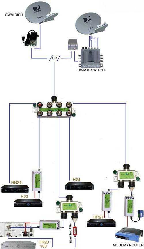

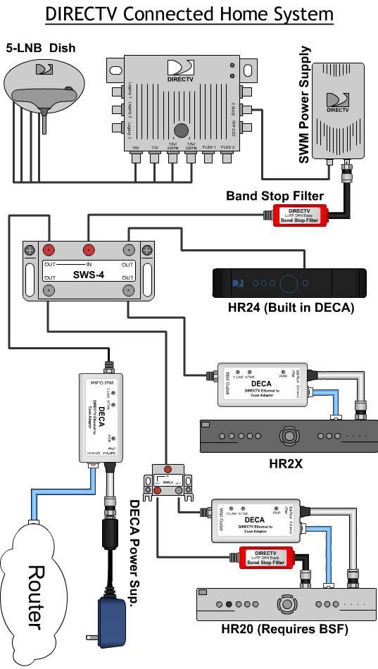

Ditto, can you tell us YOUR details. In the mean time maybe these can help? OR, since you buddy can pass out hardware and says that's all you need, maybe he can help you out since he seems to be local.
