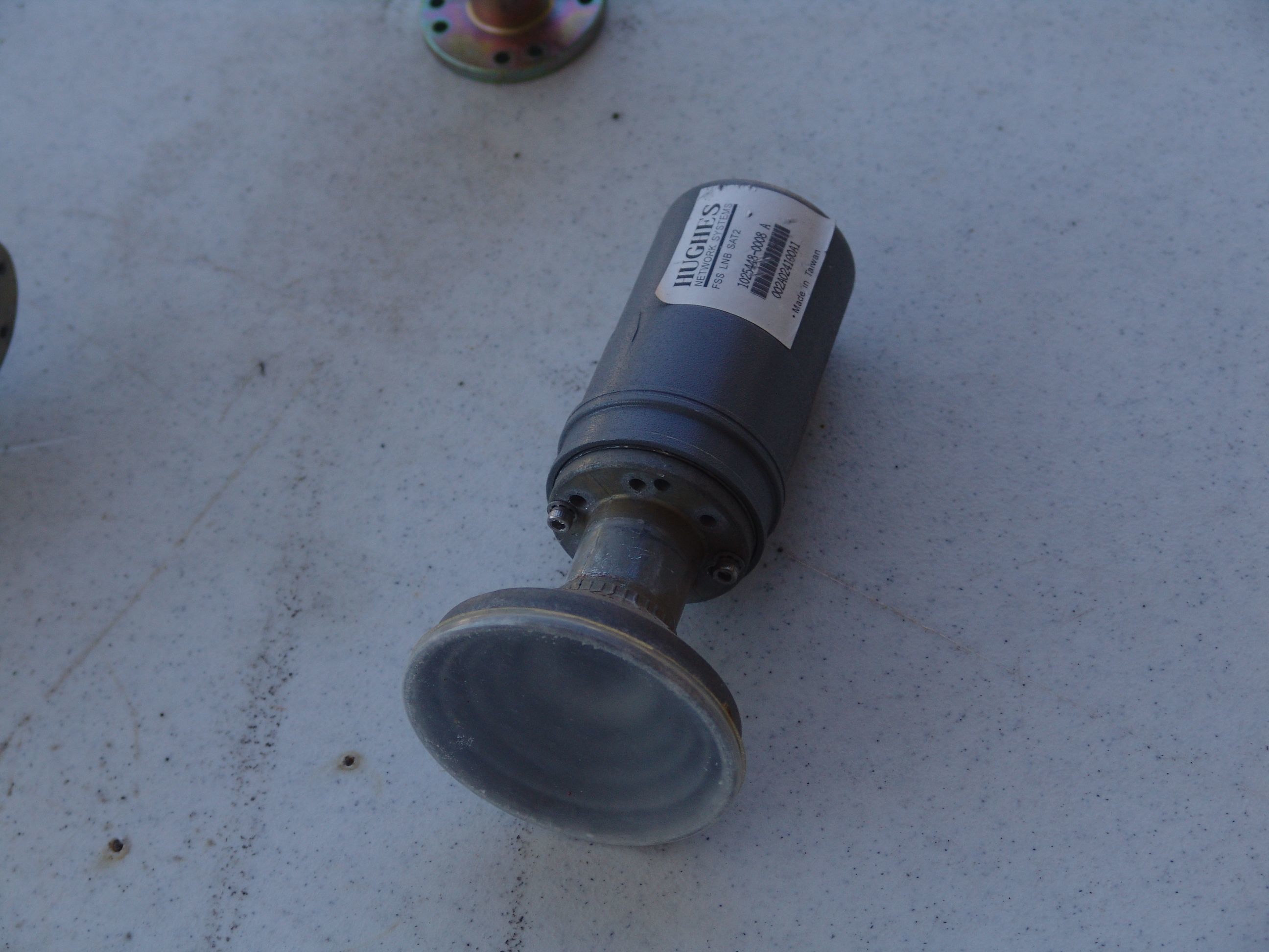

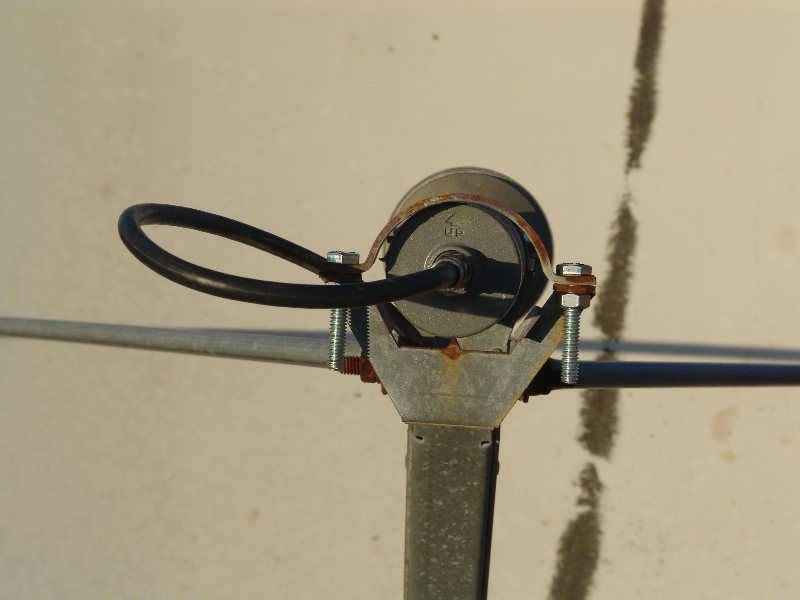

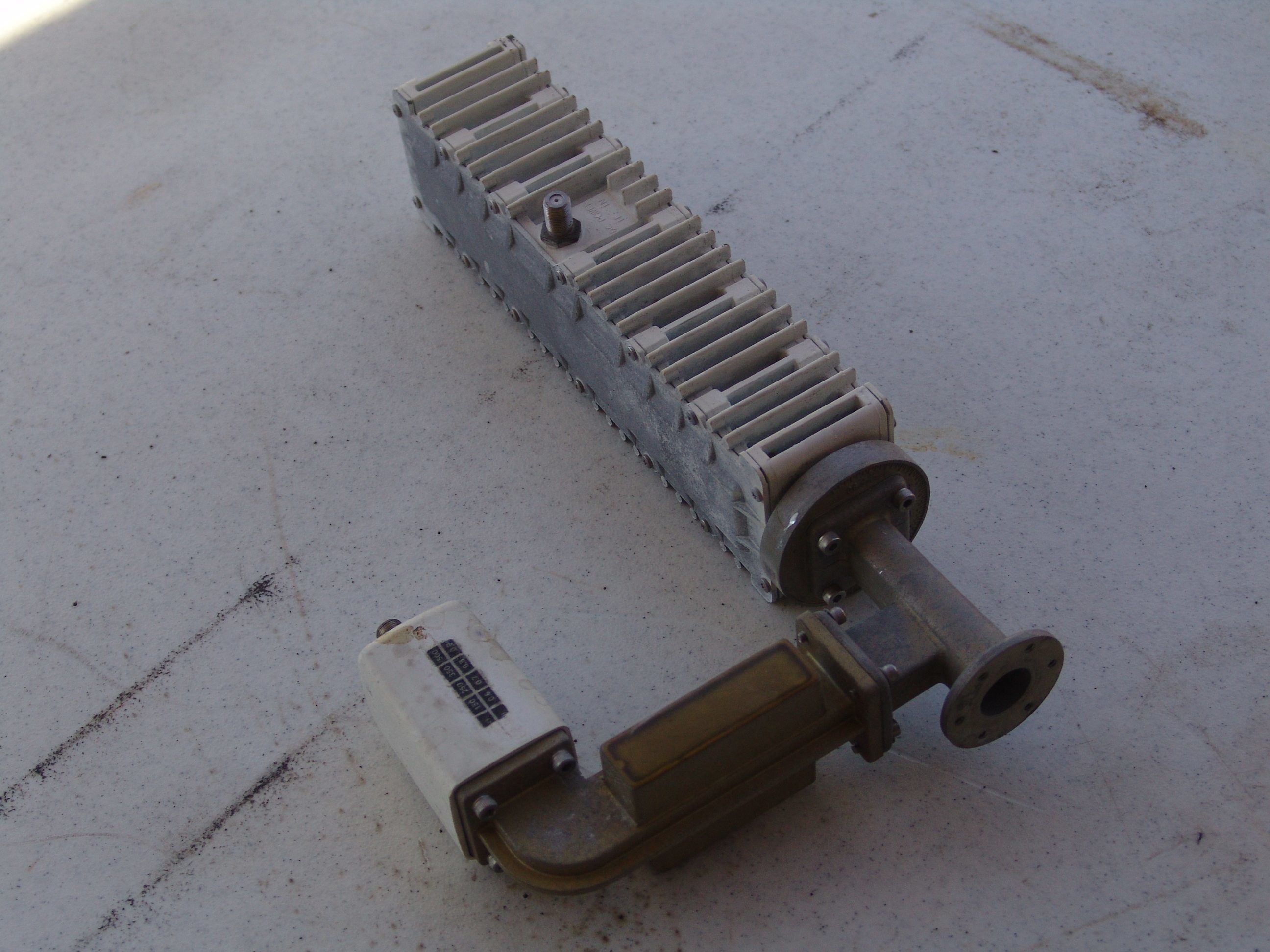

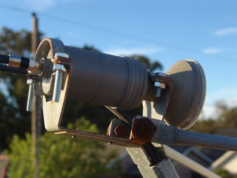

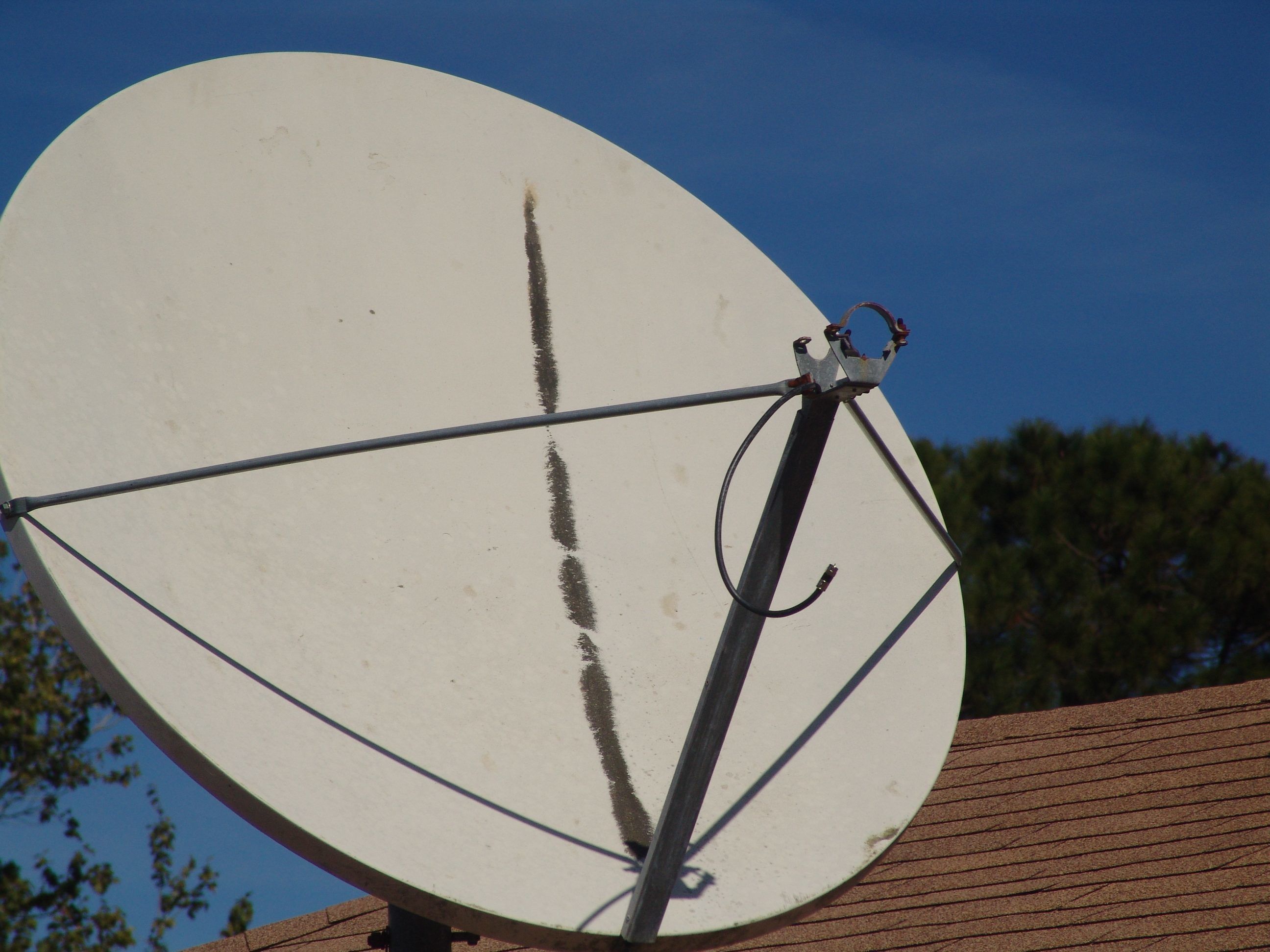

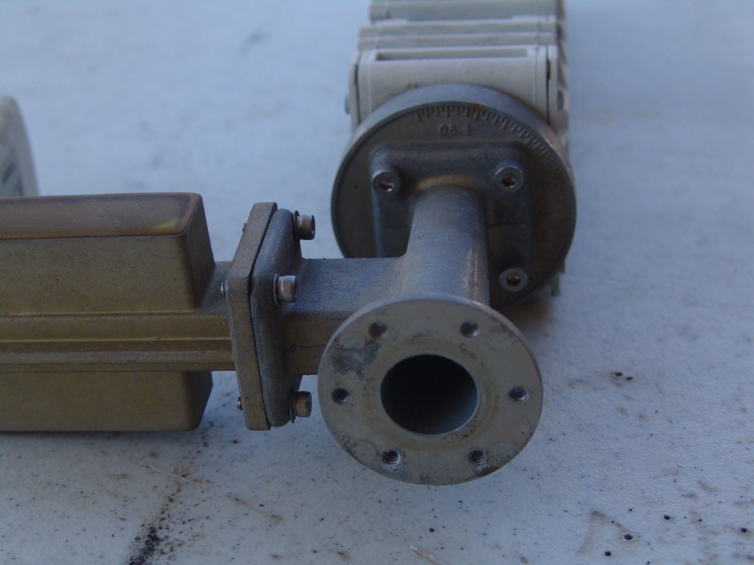

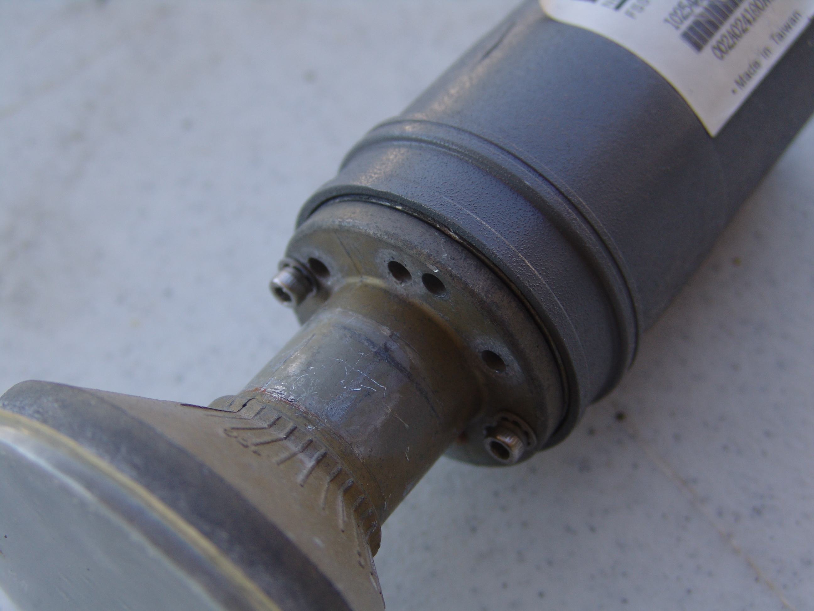

Here are the promised pictures of the dish we obtained yesterday. The LNB that came with it is pictured attached to the transmitter, the Hughes is screwed into the feedhorn with only two screws because those are the only two holes that mate up. The other problem is the mount is larger in diameter then the hughes LNB and I need dual polarity.
What to do...

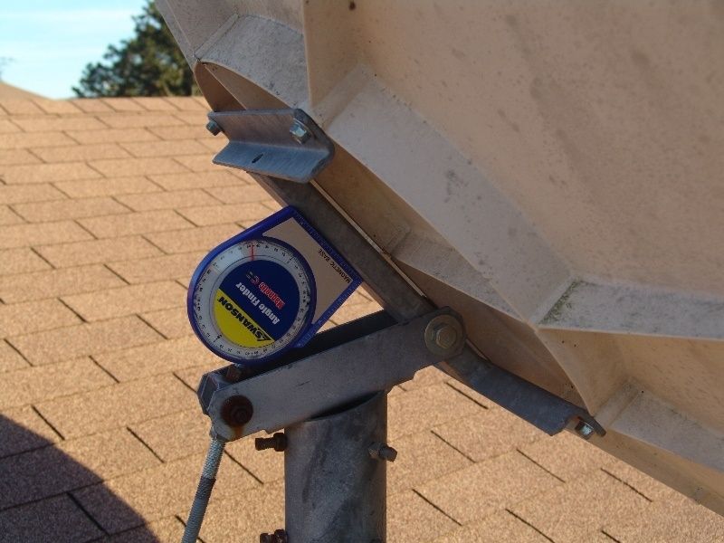

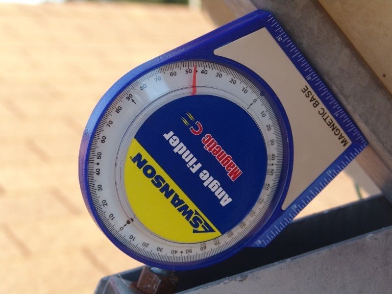

So I am getting there, I have this new dish and I want it looking at 97W all the time, the issue is the Hughes LNB mounting up properly, both the flange and the mount. Two screws on the flange is enough for me since they are crushing the rubber O-ring good but the mount leaves me concerned, its ID is just a wee bit on the large side to grab hold of the rear of the Hughes LNB, its just able to be held by the neck of the feedhorn..
Does anyone know the Inclination and what to subtract for this type of dish? Its just up there generally pointed, I have to level the mount and set the angles still. Thanks!!

You're showing the post office feedhorn (round on front) attached to the Hughes LNB, eh?
I'd go with those two existing screws.
If you're that anal, it's obviously possible to put two more holes in the feedhorn, but if it seals now, I'd move on.
Just my opinion - if anyone else has ever had a problem with that, speak up.
And as for the mounting the whole thing . . .
If you could hold the Hughes LNB in the same picture as the LNB mount, we might get a bit better understanding of the sizes.
More camera angles on that LNB mount wouldn't hurt, either.
Looks ugly, but it apparently survived the storm, so it must be pretty tough.
Is the Hughes long enough that you could just shim it at the back end?
Remember, this dish has no skew adjustments, so you'll have to make sure the LNB assembly is lose enough to twist for skew, when you aim the dish.
If it were on a motor, then of course, the skew would be taken care of by itself.

No No.. This is a 3-4 foot dish.. Sorry.

More pictures

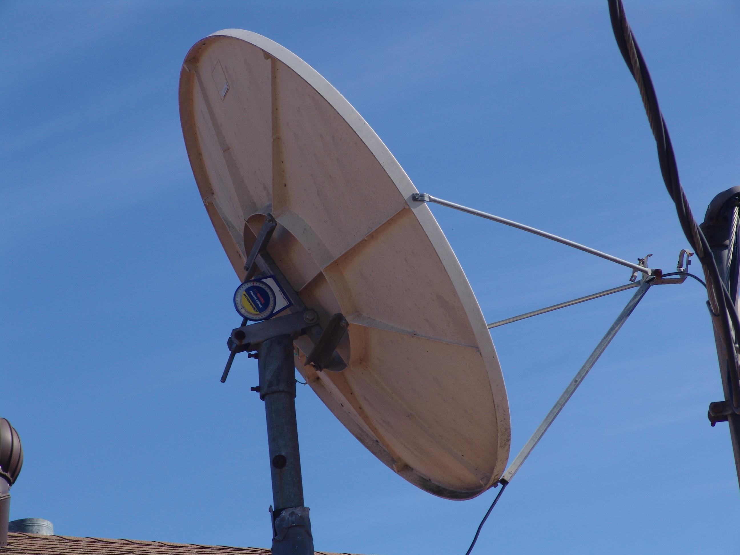

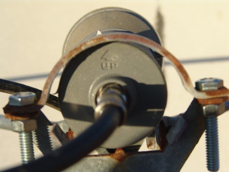

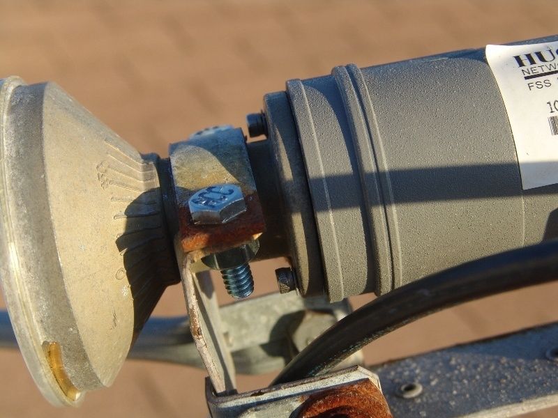

This is the little dish that just wont I have a feeling lol.. Hope these pictures help, my neighbors are feeling strange seeing two rather large dishes go up in such a short span of one week in addition to the 3 others I have up for DBS lol..
I wonder what they are thinking lol..

So yes pictured WAS the PO LNB for reference, I am trying to use the Hughes so I can have dual polarity, I still need confirmation on inclination and such.
Thanks!

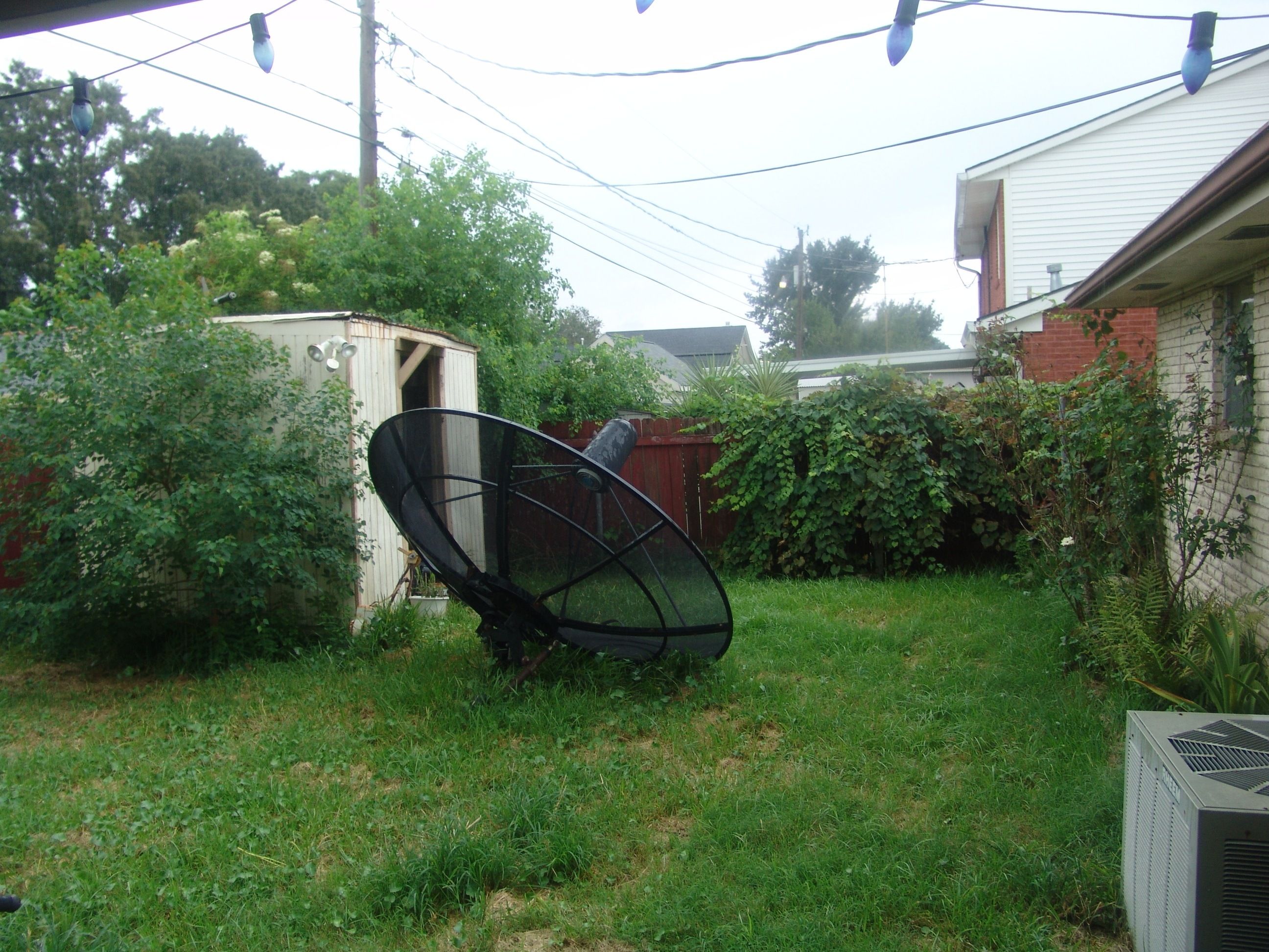

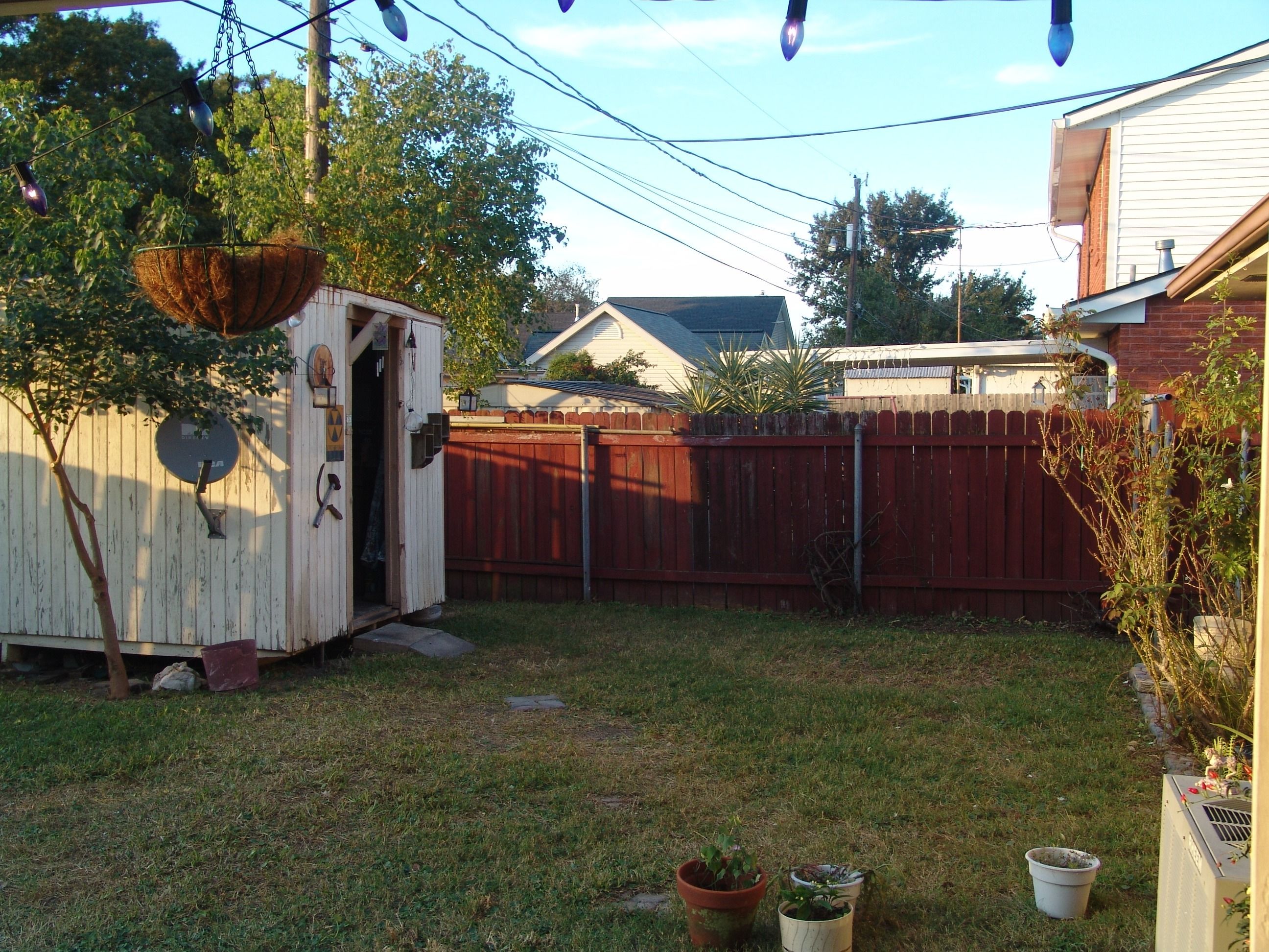

Here is a contrast and please do not draw conclusions on either the mess or the art on my shed please.. Observe the dishes :) This is the difference between August and October here, we actually can get out and clean up with out passing out or getting heat stroke.
Its a great before and after not to mention seeing that bud wasting away there like that was killing me. Took five of us to life it over the house and onto the pole..

1). if someone moved in next to me, and put a hammer and sickle on their shed, along with a radiation sign...
I might think they were either quite mad...
... or just call the police and be done with 'em! - :D
2). the pictures I've seen of Primestar dishes (similar to yours) generally mount the feedhorn, and have the actual LNB hanging off the back side.
So..... as long as you don't put any too much strain in the LNB/cable/connection, I'd leave it as is.
Contrary opinions are welcome. - :cool:
3). I know you are worrying about the offset of the dish.
Assume it is in the 22º to 26º range. That's typical.
Start out with 24º and see how it works for you.
If you can't read anything molded or printed on the back of the dish, so as to be able to look it up and find specs on the internet, then...
Just tune up on any reasonable bird you can find...
Measure the tilt on the back of the dish where your inclinometer is now.
Knowing the actual elevation of the bird you've chosen, you can work out the dish-offset to the last degree. - :up

I agree with the pointing, I think I am just going to hit my due south sat and peek the dish that way, its what we used to setup the bud.
I cant get the feedhorn to clamp straight though, that is going to require literally a hammer and anvil possibly to the top piece of the mount. The old rusted bolts all broke off and struggling with one I believe I bent the top of the mount. I have to get it inside in the shop to see. Tron looked at it earlier this evening and scratched his head.. He is coming back over later, we are going to mess around with it a little..
