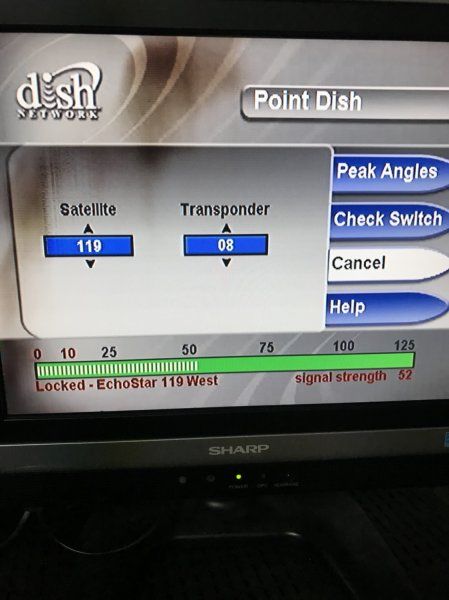

Ok here’s some screen shots. I got in early enough to go in the screen before subjecting everyone to the buzzing sound this screen makes.
I went into the menu, installation, dish aiming and it defaulted on this transponder.

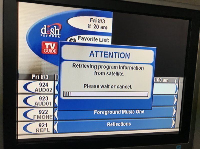

This receiver is so archaic and slow that just bringing up the guide causes it to freeze to gather data. I didn’t have all day I exited out and then turned the audio amp on. Anyway the channel is AUD02 Hot FM I believe.

I'm guessing you're looking at two different satellites. It looks like 119 for the music channels, but who knows what for your HD (maybe 129). You can look at multiple satellites with a single dish.

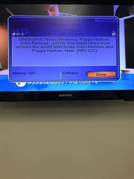

Yeah here are screen shots from our CNN TV.

Maybe we do have 2 dishes on the roof. I really thought it was one. I know we had even an older receiver for music that they came out and upgraded the video and music receiver and they were out on the roof. We got HD at that time, and locals - which we didn’t have before.

Yes, I would say that definitely answers your question. Your severe weather must come in from the west, so it knocks out 119 before 61.5 is affected.

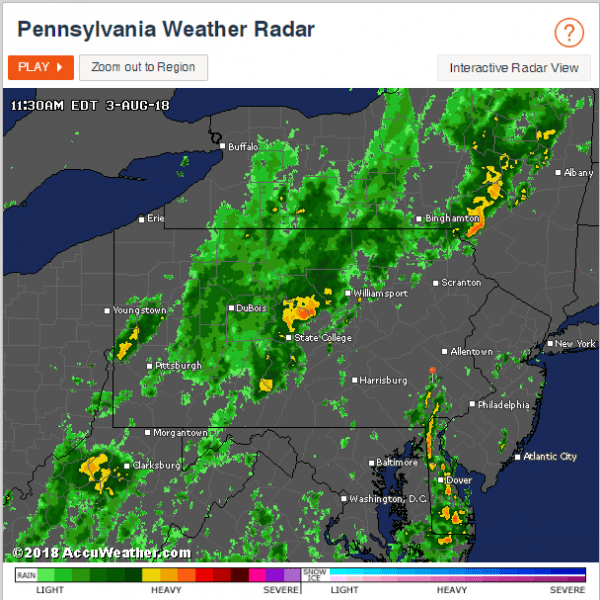

Music is out now, but CNN HD, still alive and kicking.
Here's our radar. Were by the pin.

It is probably a single dish pointed at two or three different satellites. 110, 119 and 129. Most HD is on 110. Music is at 119 so music will go out first since it's farther west as the weather rolls in from the west.
