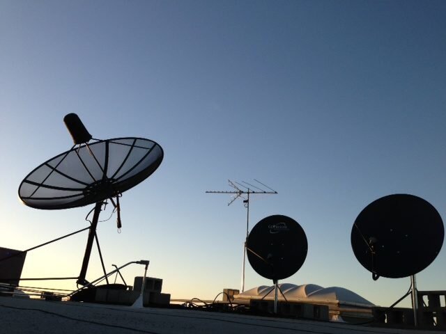

We are relocating the C-band dish this week and will not be able to capture the stream until next week.

No offer yet to provide a TS recording, so we will need to wait for our dish farm relocation to be completed.
The dishes have been relocated. Roofer should be here in the AM to install a POE.
Already installed the distribution, cabinet and a 5x18 port Spaun DiSEqC/Multi-switch.
Project almost complete!
