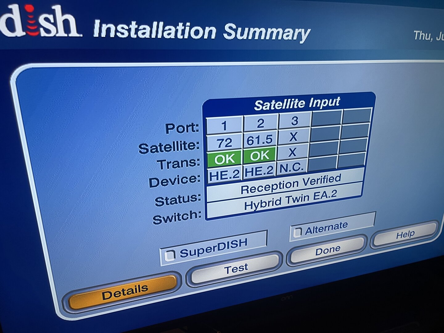

That's… interesting. I don't see why the 211k wouldn't work with the Hybrid LNBs, but if anyone else has a 211k specifically and they can test it to make sure that would be great. Does it detect the switch (should show up as "Hybrid 1K.2 WA/EA), and while running the test, does it run through 0 out of 3/4 tests or a big number like 38-50?
what my 211z displays for reference

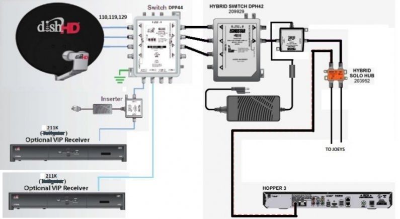

If you would like to add the 211 and have the Wally's still ran off of the same DPH42, you could add a DPP44 to the mix. This would take the same satellite dish feeds, provide 4 DPP connections (that either the Wally or 211's can use), and has another 4 outputs to connect another switch like the DPH42 in series.
Found this picture on Google (from this forum nonetheless) to sort of give you an idea what that would look like.
