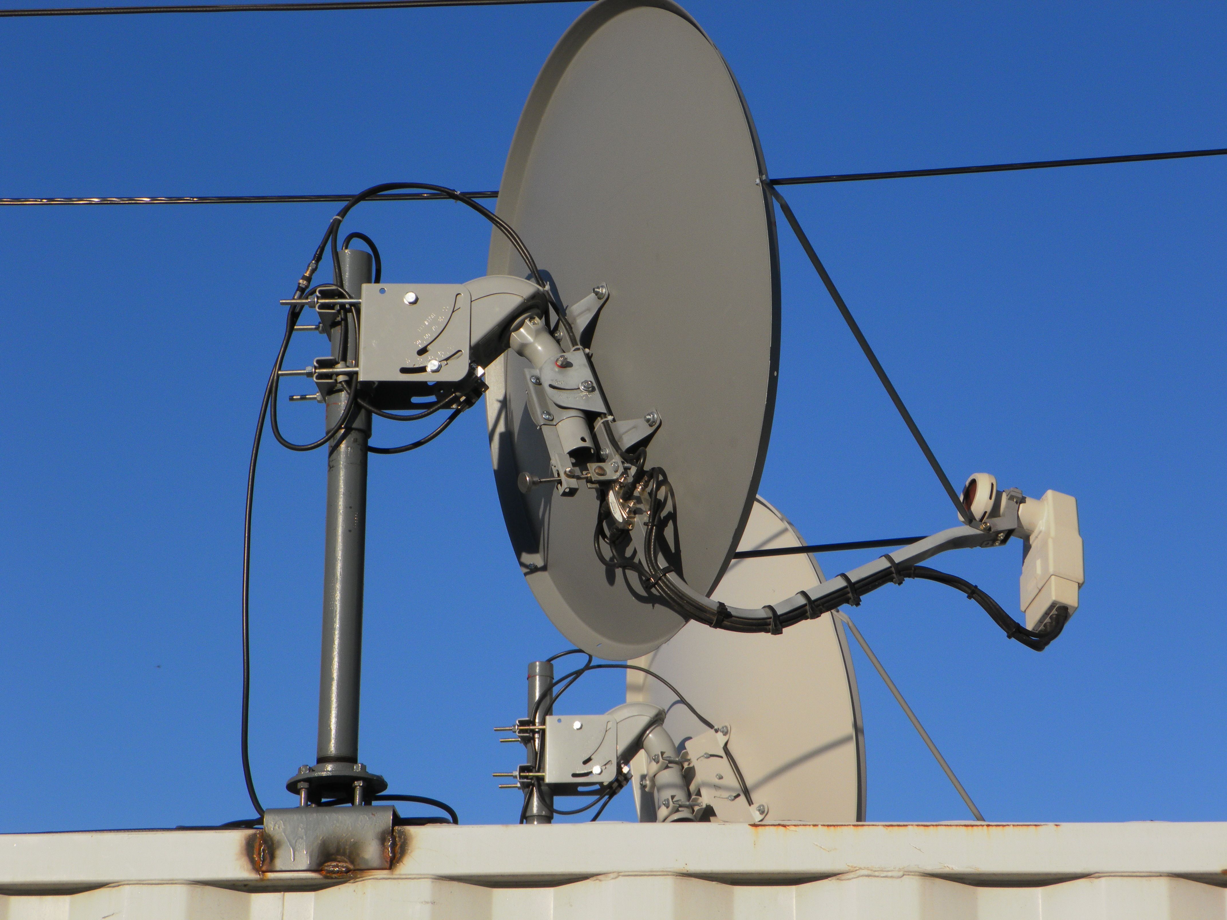

My first FTA dish had to move. So I added some upgrades. I fabbed some LNB supports from 3/8" steel brake line. I replaced the SG2100 with a SG9120b. I installed a "Walrus Elevation Adaptor". This dish has never worked better. The elevation control is so sweet. Dan is the MAN!!
Nice mods and mount. My invacom does tend to bounce in the wind without support arms. Looks like something I will be doing very soon.

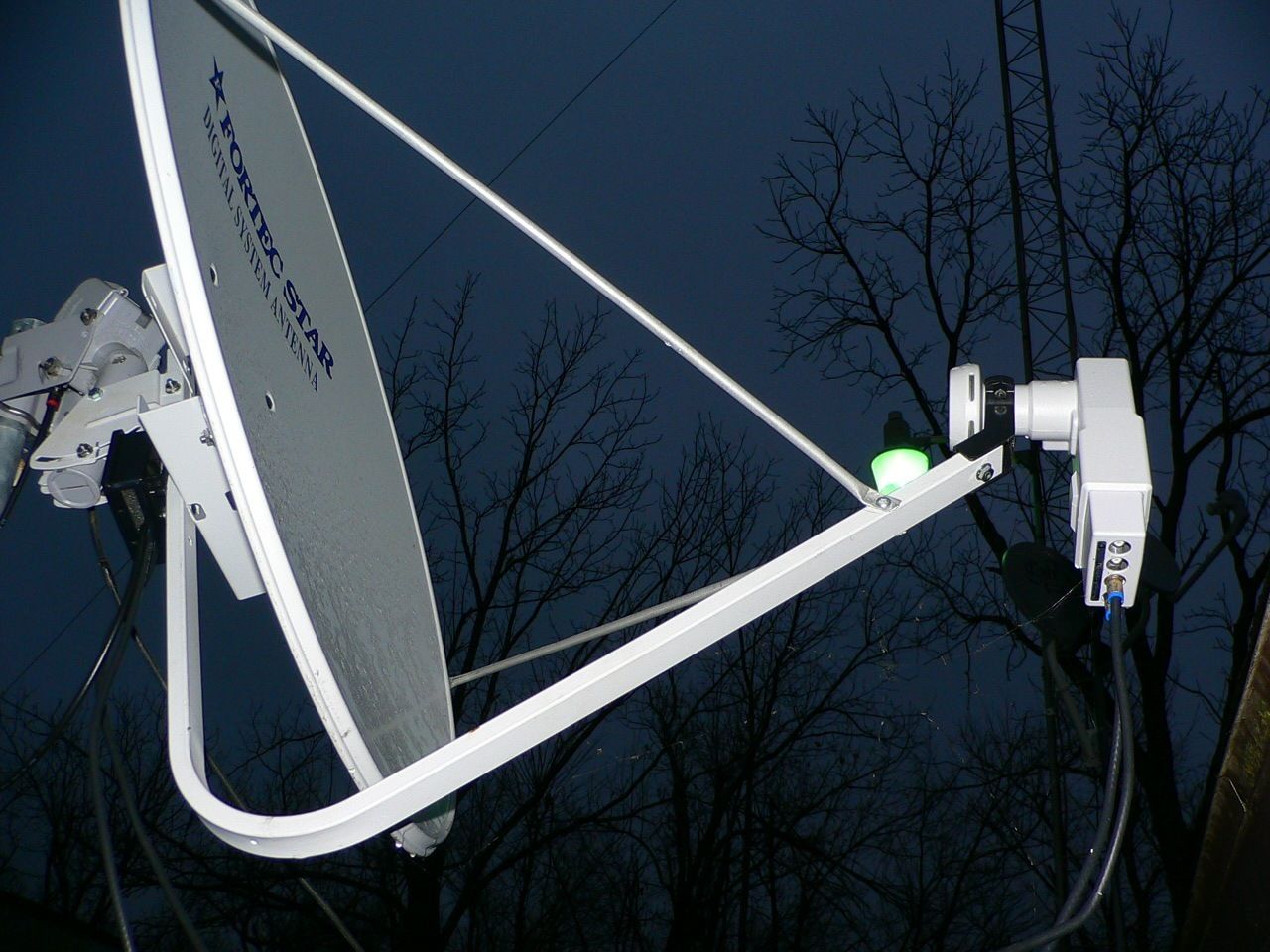

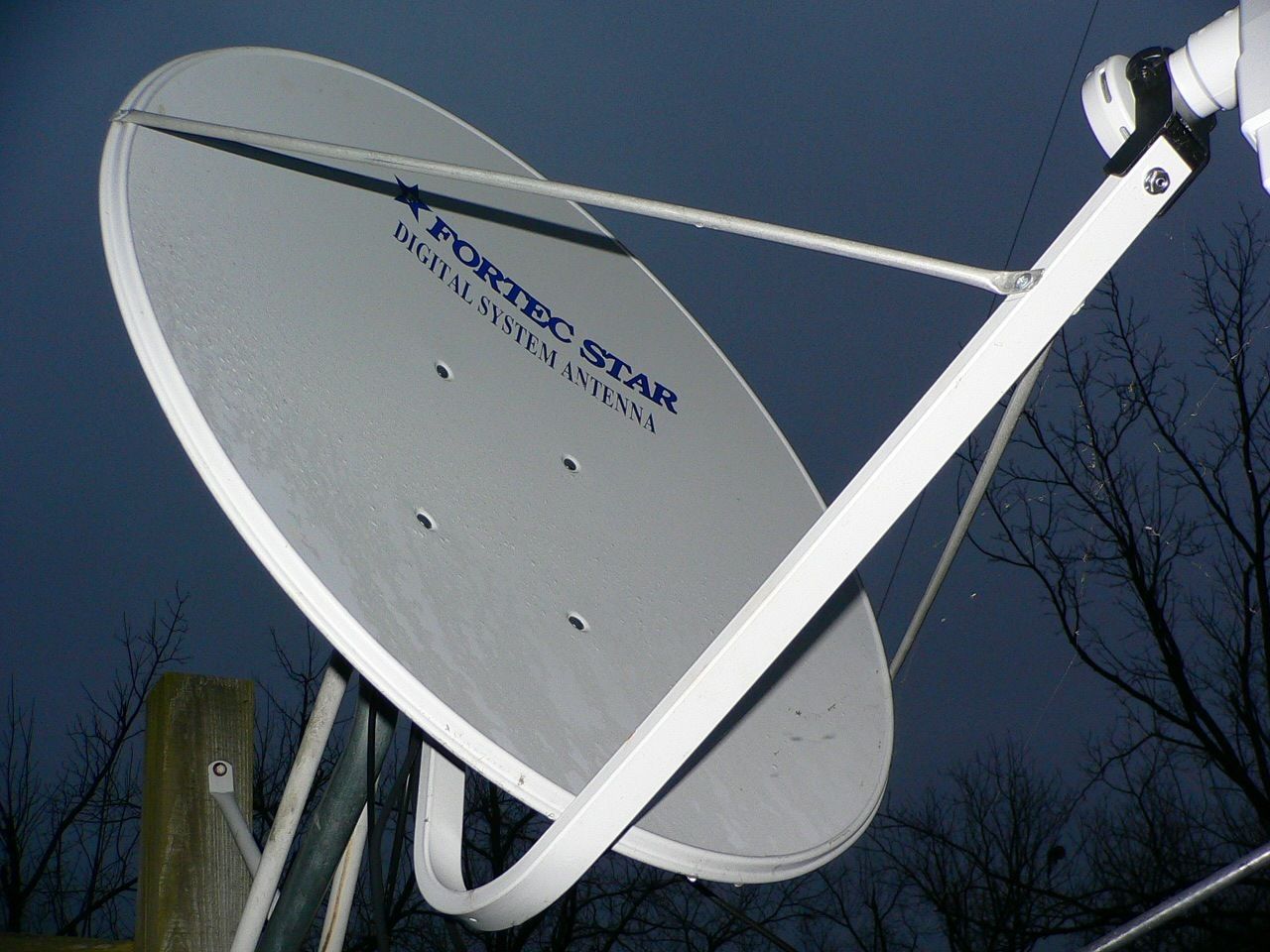

A couple of the longer elements from a junk OTA antenna works great. I attached these with self-drilling panhead phillips screws, 5 minutes from start to finish.
