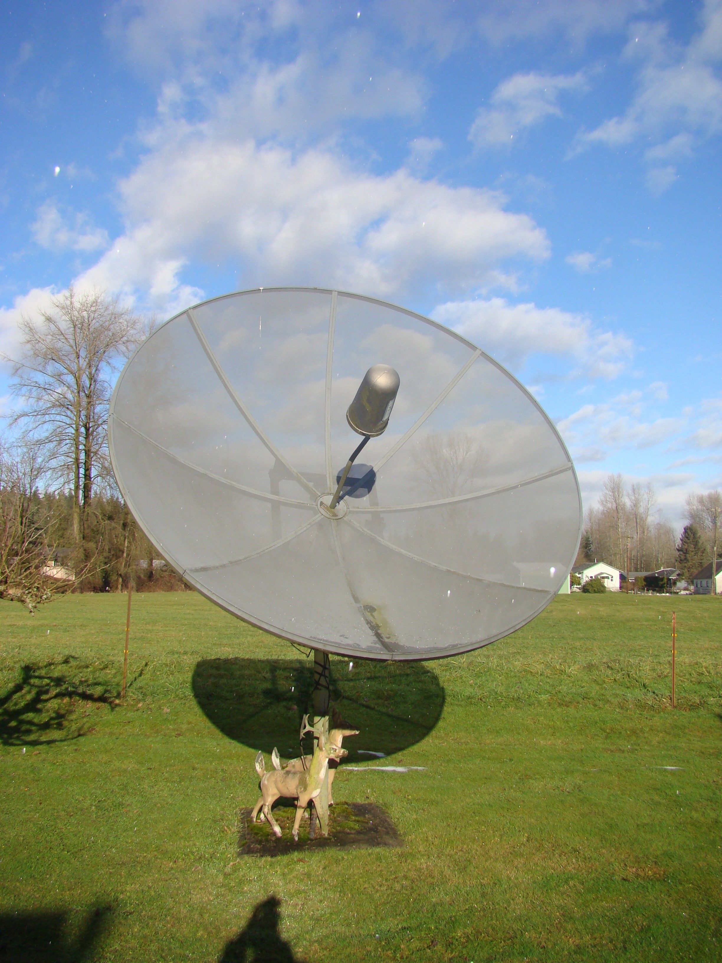

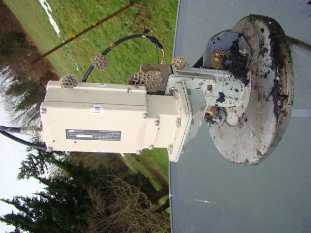

I got this nice dish home today. I will start getting it cleaned up & decide where I am going to place my pole after a good site survey. I know I will need a new LNB, this one is a MA-COM #ODU H3-STD. Will I be able to get the dish up & running with this LNB? Winegard did a great job in this dish design, everything is in great shape, after 20 some years of service. Thank you guys for all the help I have received in this short time,

It's possible that old lnb may still work, check all the connections and give it a try. Newer one will surely be better, naturally. What temp lnb is it? Should be stamped on the sticker on it.
Be curious to see if that polarotor still turns after you put some power to it, lol.
Nice dish, you're having stellar luck with your hunting.
There is no temp at all on it, maybe one of the elders can decipher the model #? The Part # is 7003-030, maybe this is 30%?I have plenty to do before than, now it is snowing again, lol.
Maybe it'll melt soon, and you can resume your project. That old lnb looks like one of the early models, it's prob 100-120degree job. Over the years the noise temp improved, they're down around 15-20degrees now. MACom was a forerunner of General Instrument, I think.Made cable tv equip back in the 80's.

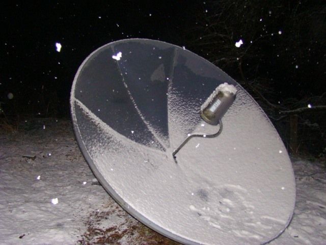

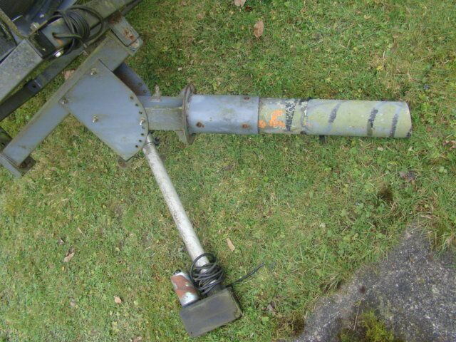

It is warming up this morning, so the snow will turn to rain, which is a good thing. When I took the disk down, I could not get the mount to unfreeze from the mounting pole, even with alot of WD-40 and a pipe wrench. We ended up using a sawzall on the 4 inch pipe. I am going to the local Iron Works to see if they has pipe that matches the mount (inside diameter 4 inches)

That one would be different then, if you measured it at 4". Most of them are 3 1/2" OD I think, haven't measured one in a while. Be sure you don't wind up with a too-big pole..that would be sad at current prices. Scrap yard might be a good place to find it. Last one I bought was about 60bucks, but the only thing the place had was super-thick pipe, at least 1/2"thick. That pole isn't going anywhere in the wind!
The mast is 4 inches outside diameter, so I need 4 inch inside diameter mast.

I remember that when dishes were first out they used a lot of 4" OD pipe and as time went by they started using more 3.5" OD pipe.
When you order or refer to pipe, remember that pipe is called out by it's Inside Diameter, not it's OD. So if you want 4" OD pipe, you really need 3.5" pipe with 1/4" wall.

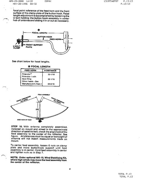

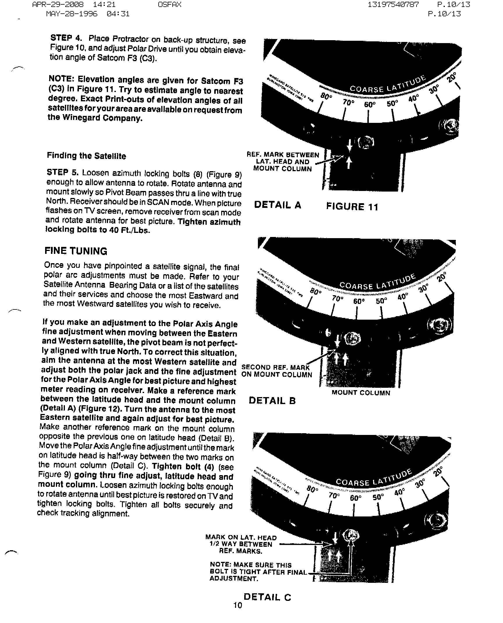

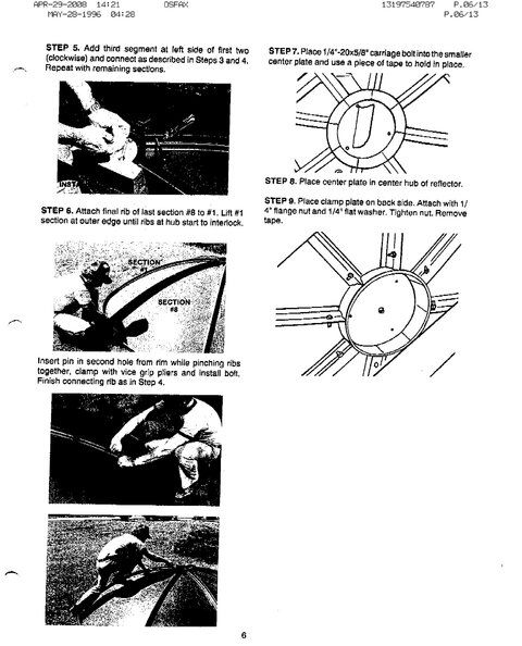

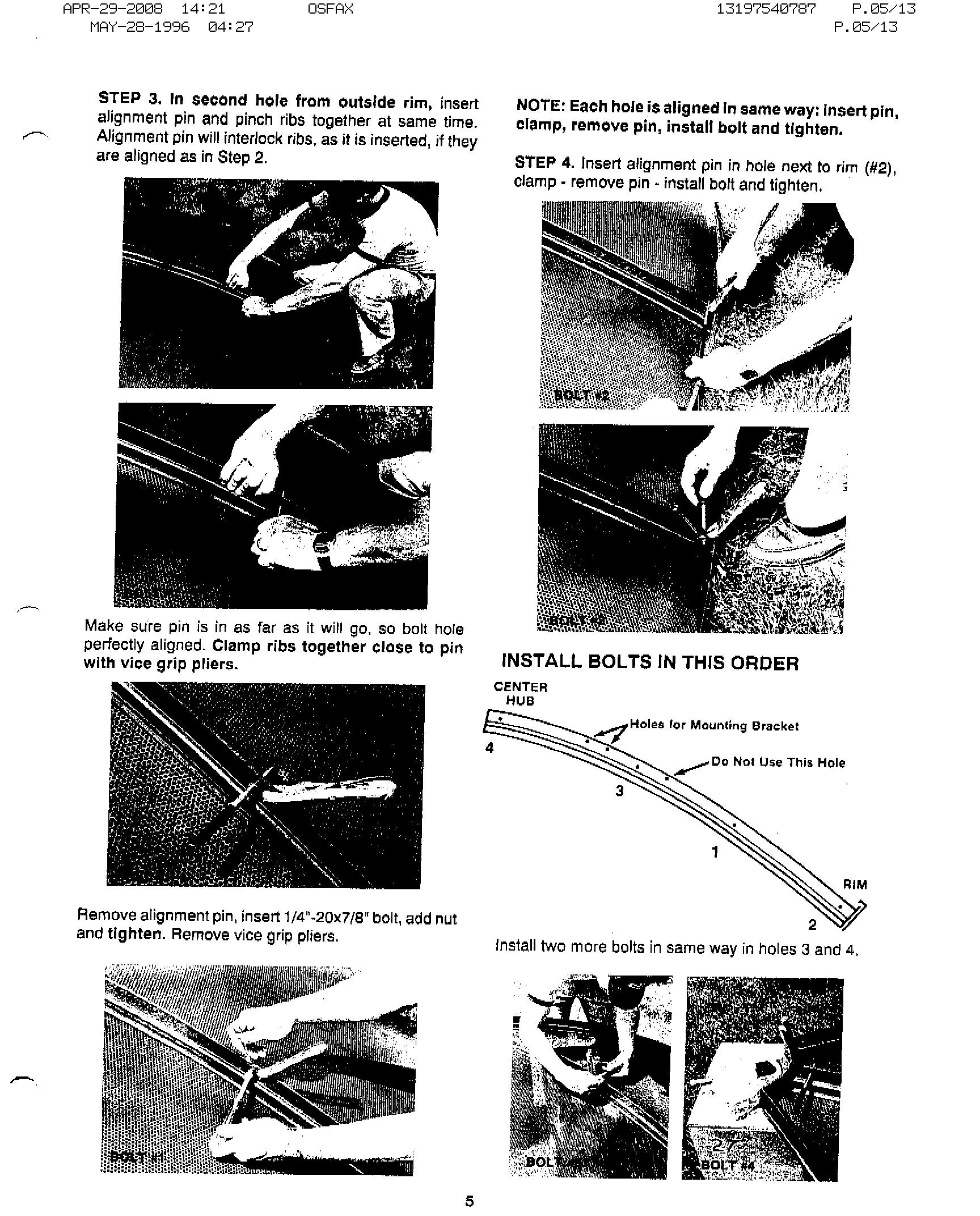

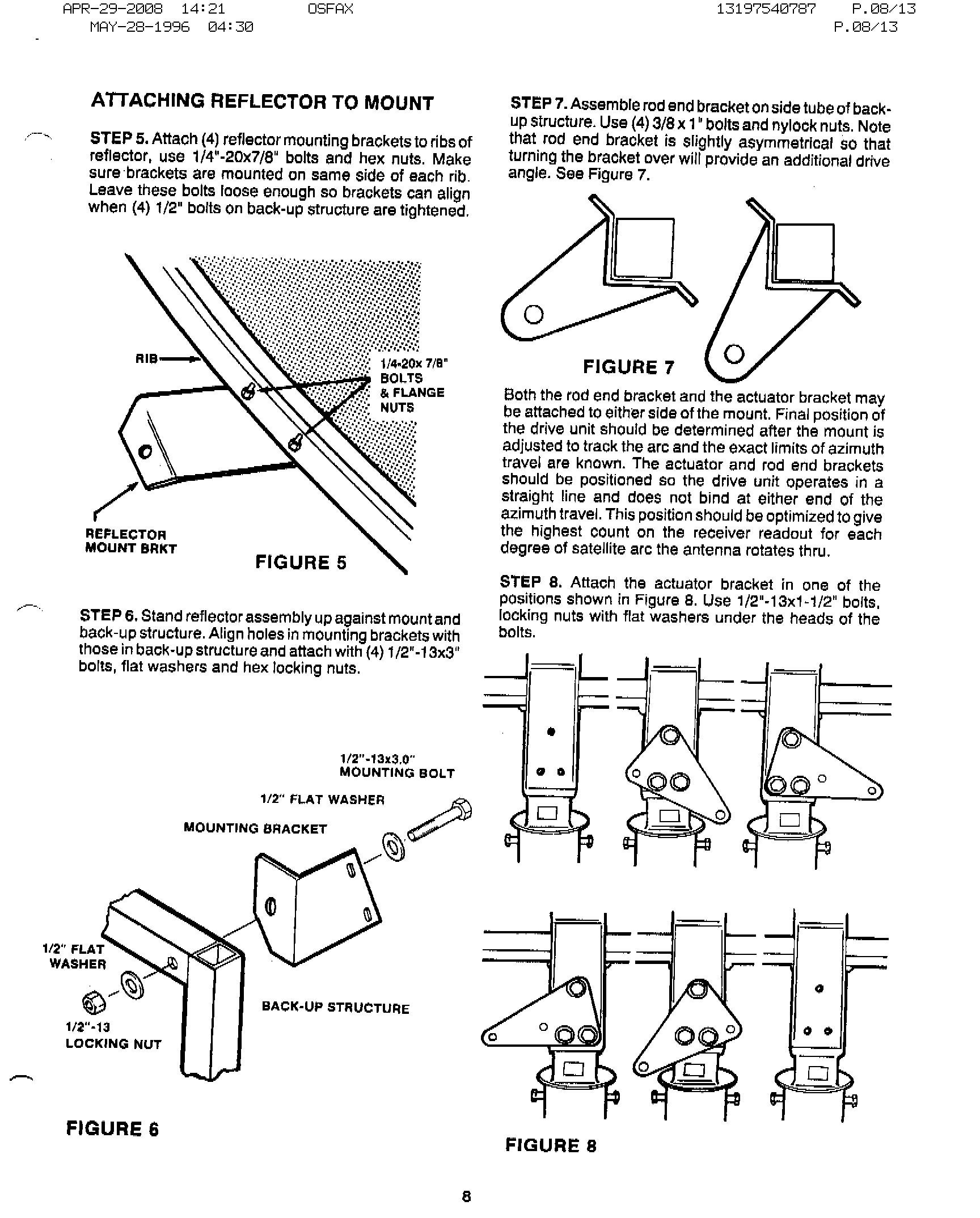

pinnacle instructions

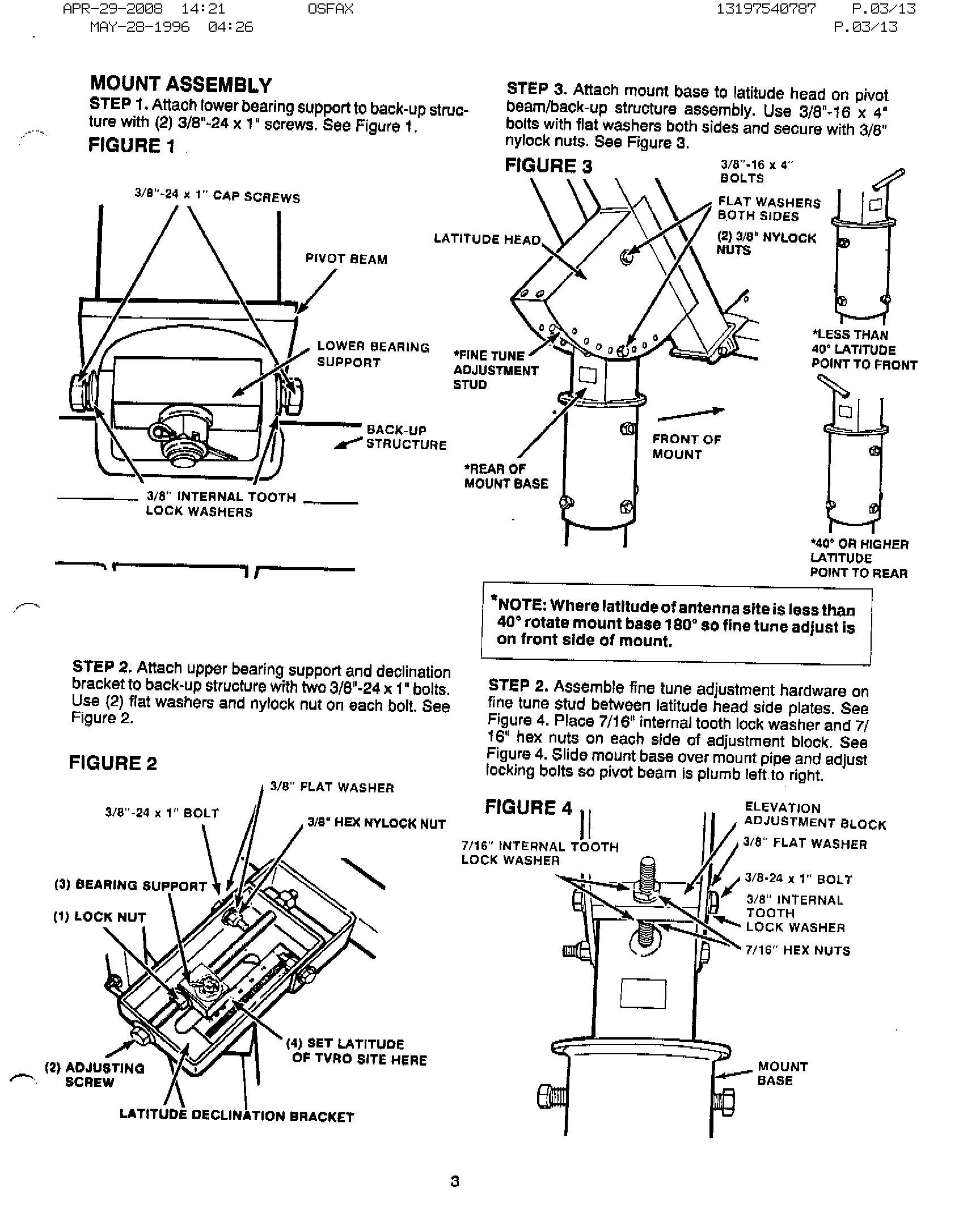

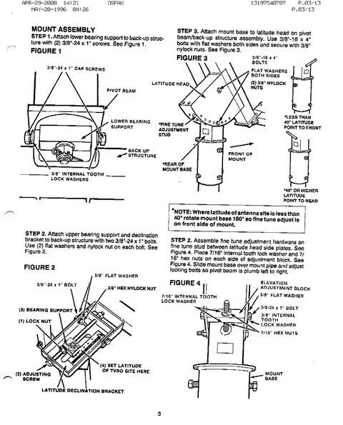

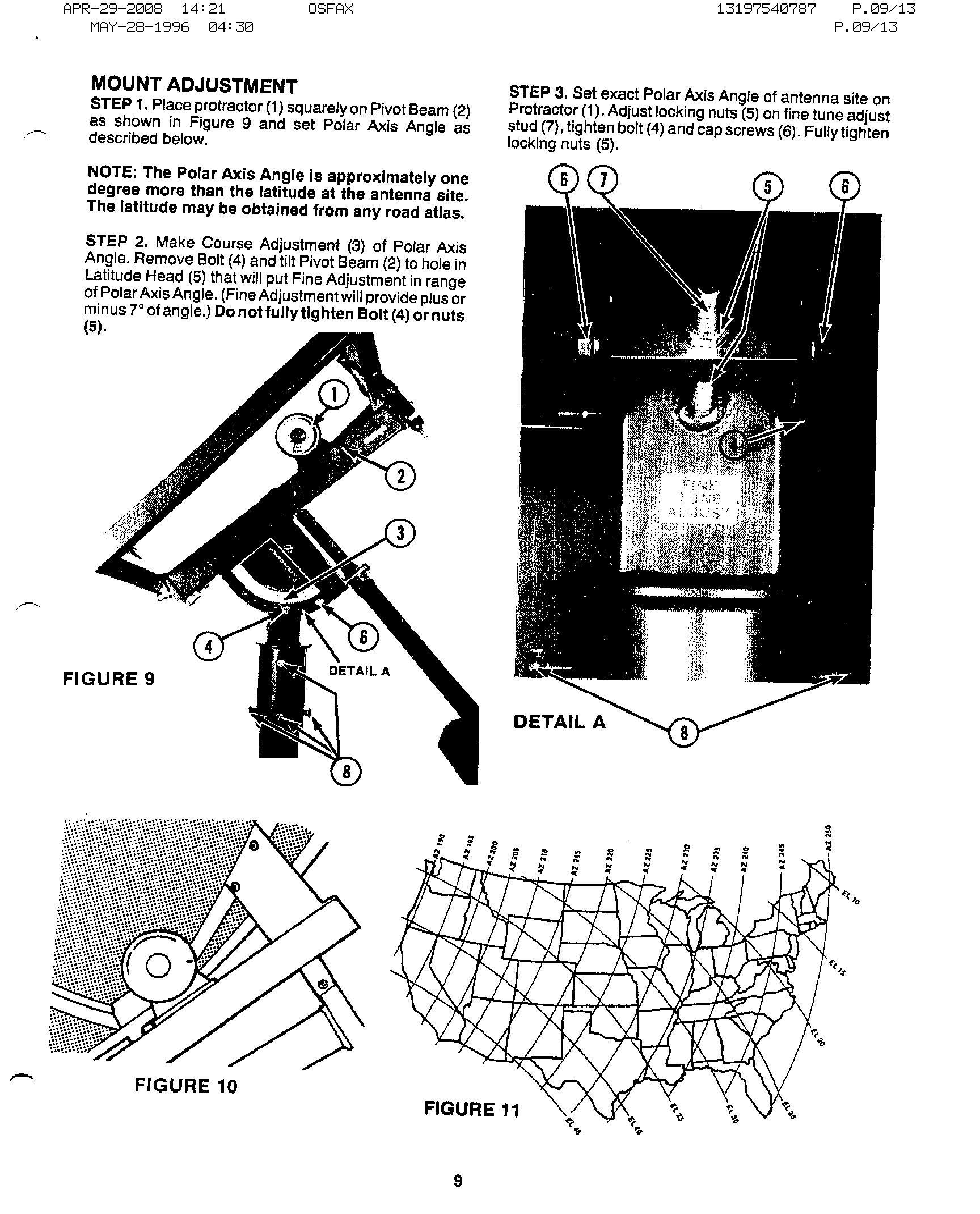

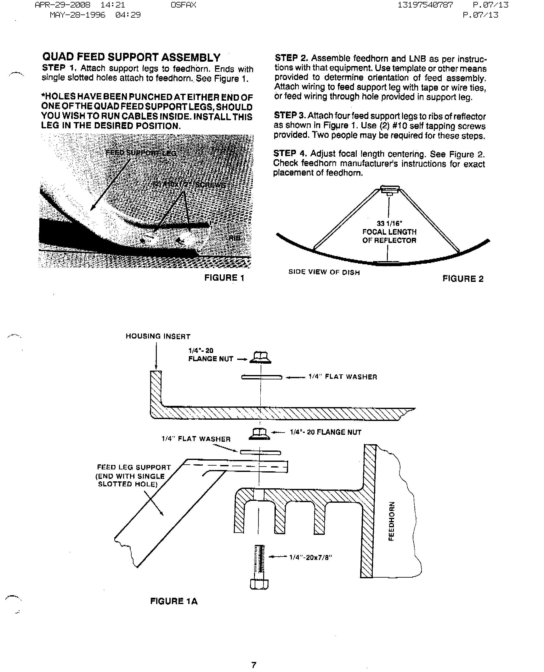

I was going to refer you to the manuals section for these, but when I went there to check it, the file was corrupted, so will try to attach them here. I hope this will help you and whoever else needs to put this dish together.

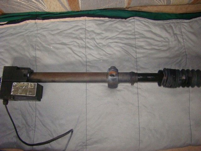

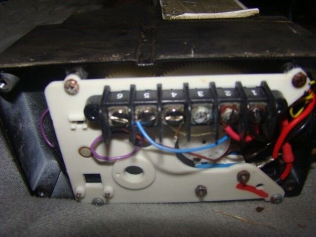

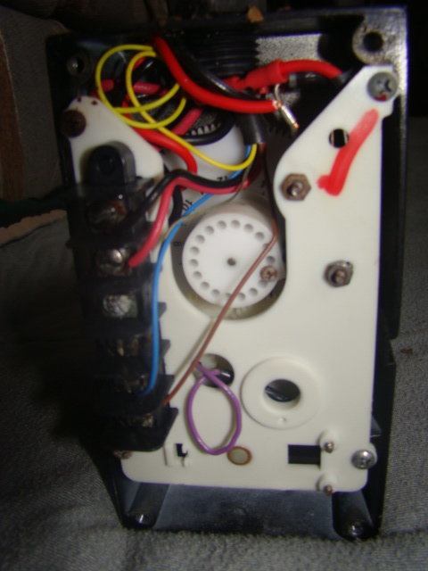

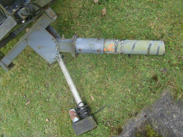

I was pretty bummed out when my 920 went south, lol. I went down to grandma's house & started to get the Zenith dish ready to haul home. This time I made sure the mount would free itself from the mast & I took the actuator off the mount first. I proceded to remove the dish from the mount (4 bolts) carefully laid the dish on its back & removed the mount & placed it & the actuator in my truck . I came home & hooked up the actuator up to my 920 & it works! (her husband stopped using it because the dish stopped moving) I get 16 inches of travel, this thing seems real heavy duty. Although it says Zenith, can someone help me identify the maker? the motor housing & cover are metal with no plastic.
