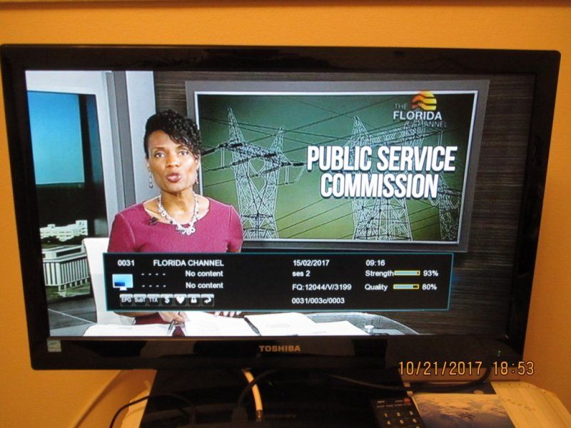

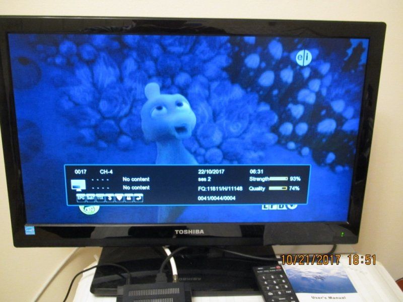

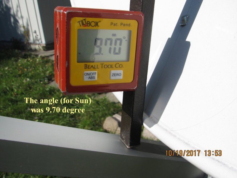

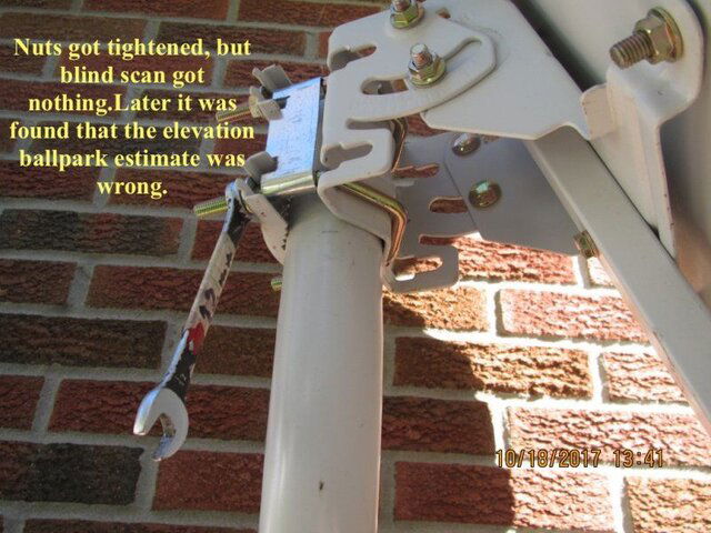

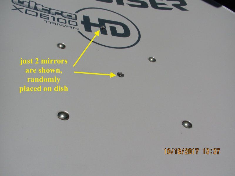

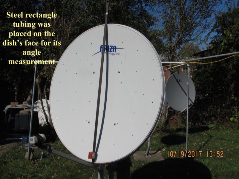

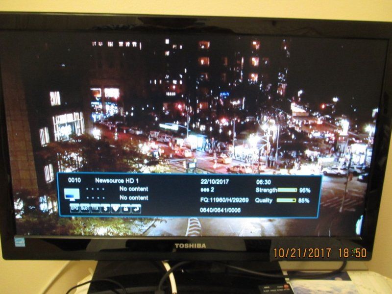

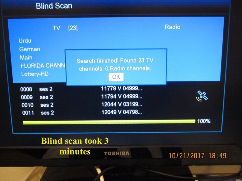

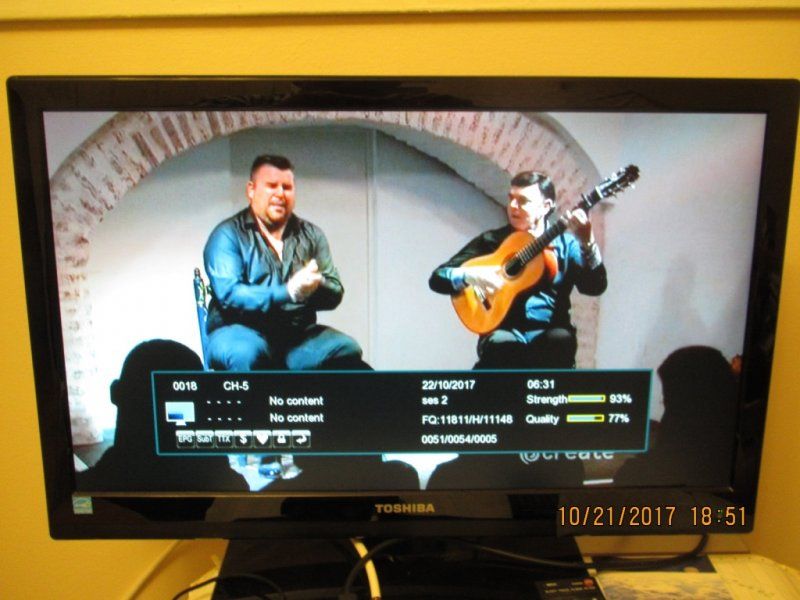

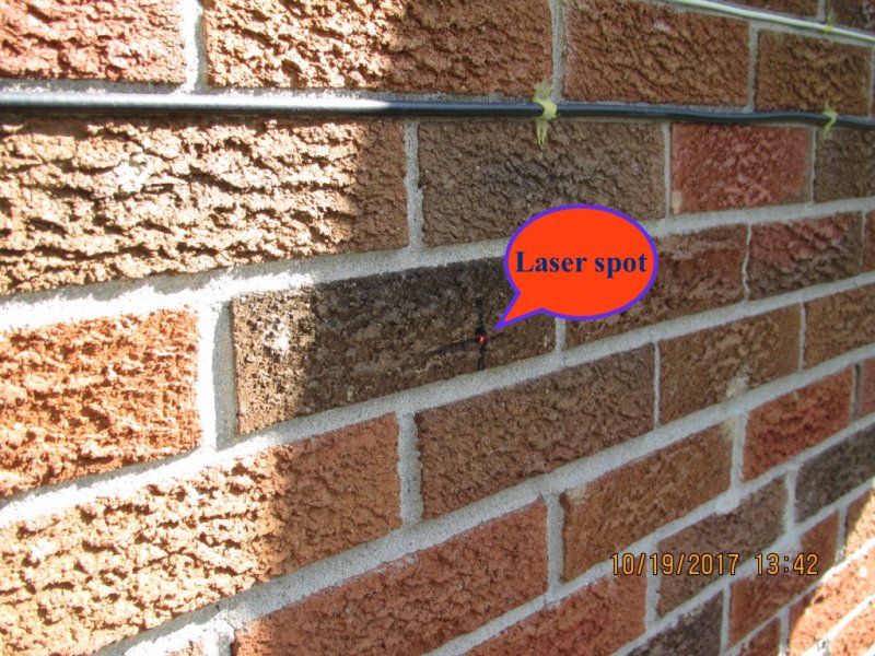

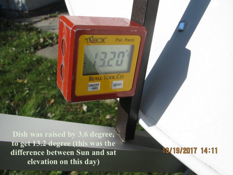

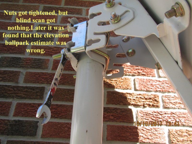

polgyver Creative Tinkerer Original poster Pub Member / Supporter Sep 21, 2010 493 379 Toronto Oct 22, 2017 #1 Just wanted to know, what is available on 97 W. It took me a few days, but, finally, got the programs to watch. I took 28 pictures and annotated most of them. Now, will try to upload them. Attachments thumb_IMG_5510_1024.jpg 95.7 KB · Views: 342 thumb_IMG_5512_1024.jpg 106.9 KB · Views: 387 thumb_IMG_5515_1024.jpg 83.1 KB · Views: 353 thumb_IMG_5516_1024.jpg 78.7 KB · Views: 375 thumb_IMG_5519_1024.jpg 56.8 KB · Views: 373 thumb_IMG_5520_1024.jpg 44.3 KB · Views: 363 thumb_IMG_5522_1024.jpg 57.7 KB · Views: 286 Reactions: iBoston, mc6809e, lost_mesa and 2 others
polgyver Creative Tinkerer Original poster Pub Member / Supporter Sep 21, 2010 493 379 Toronto Oct 22, 2017 #2 OK, now I found that only 20 files can be uploaded in one post (somehow, 21 got in...). Here is the last 7 pictures;
