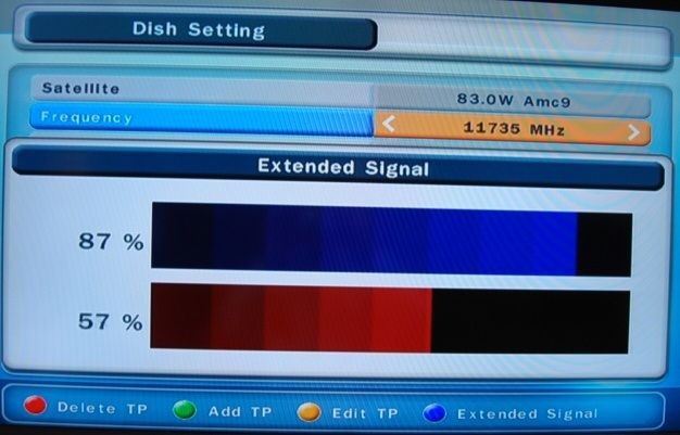

Once I was able to get a solid quality reading with dish peaked as best I could, I "tuned" the LNB arm for maximum received signal. I did what one should never due to a fine dish. I yanked, twisted, pulled, stepped on and kicked the LNB arm into position. Here's the final reading:
For now, I'm satisfied with this Coolsat 7000 reading. I never saw any higher reading at any time while abusing the arm. I reinstalled the new LNB holder. Placing the LNB a little lower and pushed forward gave best reading in the end. Now I'll see if I can get any other sats.

Yes, it is. I was worried there might be something like a "railing shadow" phenomenon where the dish effective surface area was being reduced. But the culprit seems to simply have been an out-of-alignment LNB arm. Once I physically manipulated it back to position, I was able to catch 57% from AMC 9. When weather improves, I'll take my portable palette dish down to the backyard and try to aim it permanently at 125W.
