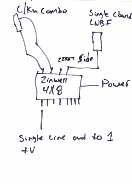

Would this work on a Zinwell 4x8?
C/ku LNBF to non 22khz side of switch
single line from fixed C band dish to 22khz side of switch.
Absolutely. I had the same situation going before i bought my DUAL output lnbf from Titanium and it worked fine to get either horizontal or vertical channels. But, you will only be able to see Horizontal or Vertical not both at the same time.

Ok would it be better to put a dual output on the C band 22khz only side?
I want to keep my 10 footer fixed on 97w and have my 8 footer moving C/kU side.
Am I going to lose anything? Only running a single TV so am I only going to be able to get H or V with a single feed not both?
Thanks for your help!
Well, question, are you attempting to be able to have multiple receivers view it at the same time?? I should explain further, the setup you have would enable only Horizontal on the Cband side, and Vertical channels on the KU band. and then Horizontal or Vertical channels on the other Cband lnbf depending on what port you have it plugged into.
Reactions: hank123
Dang so if I want to scan the sky with c/ku combo I would need a dual output c/ku combo? Any unless I want to drop big cash I am SOL.
The only other way I could do this on the cheap is, what Fat Air did and invert a KU dish to a C band dish to track.
okay, then you don't want the 4x8 switch. Instead, just use a cheap Diseqc switch. Port one to Cband, port 2 to KU band, port 3 to Second cband. Then, you don't need the Dual output LNBFs . You can get a CHEAP < $2.00 diseqc switch from Aliexpress including shipping.

Technically you could get signal from the three LNBFs you have connected. But only one polarity from each one. The multi-switch is designed to pass both polarities from two dual output LNBFs, selected by up to eight receivers. the 4 inputs are 18V (H) 13V (V) 18V (H) 22khz on 13V (V) 22khz on. The inputs are selected by voltage and 22khz on or off sent by the receiver. The is no DiSEqC involved with this switch. Look at the FTA FAQ section, there are a couple good threads explaining switches and DiSEqC .

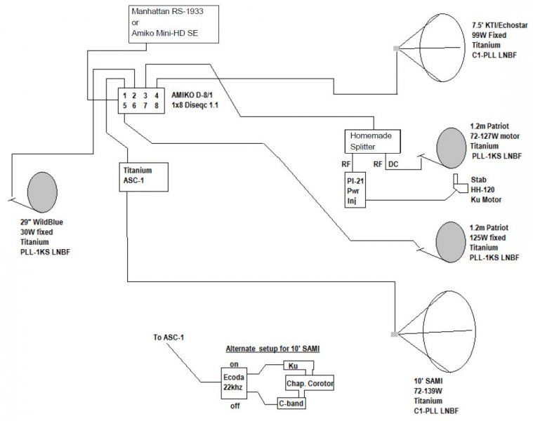

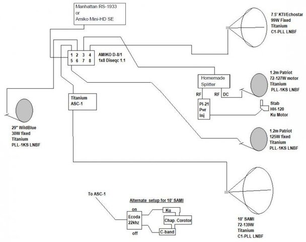

I've had good luck with Amiko diseqc switches. In my current setup there's an Amiko D- 8/1 - it's just one receiver to one TV wired like in the diagram.
