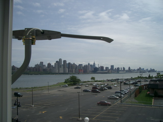

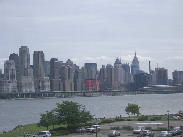

I understand the low power thing and I've been hearing about this combiner thing for months (when it actually happens I'll believe it's real). But c'mon now. This is SUPPOSED to be an amplified antenna good for at least 25 miles. I'm literally about 3 miles away with direct, unobstructed line of site. See these two pictures:

I realize you're trying to be as helpful as possible and that OTA HD can be tricky, but unless there's some invisible force field in the middle of the Hudson River, I'm having trouble understanding why I get absolutely no sniff of WPIX and really weak, sensitive NBC unless it's an equipment problem.
