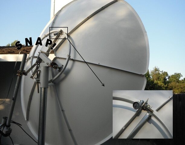

Make sure to look at all the photos and read up on all the excellent info in FaT Air's links. Take your time with the installation. If I didn't rush with the assembly and had installed the actuator properly, I would probably still be enjoying the CBC DVBS2 mux...
Don't let this happen to you:
HUGE fail.

That sucks. Sorry to see that.
HUGE fail.

Wow!! The actuator just broke off?!?!:eek:
