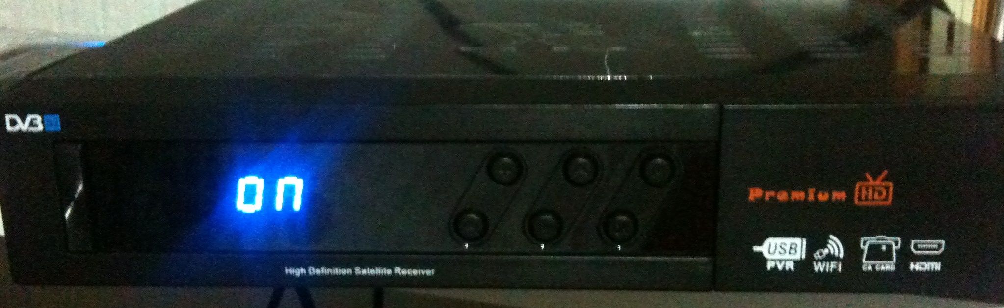

Hi, does anyone know how to reset a X2 (X-Square) Premium HD II that is stuck with "on" on the display? I was editing the radio channels, and the unit froze, so I unplugged, waited a few seconds, plugged it back in, and now it just starts up with the X2 logo, then goes blank, and only shows "on" on the display, with no response from the front buttons or with the remote. Will not power off using the power button either. THANKS!

I used to have an X2 Premium HD II but lightning got it. It used to lock up from time to time (frozen screen) but never experienced your particular problem. Unplugging it was the only way I could find to get it to reset. Have you tried leaving it unplugged for more than a few minutes - maybe an hour? Also, after it comes "on", did you try pressing the FORMAT key on the remote? May be stuck in a video mode you aren't using. Also, try the TV/RADIO key.
I agree that it may be in a video mode your TV cannot display. If possible try a different output, the composite instead of the HDMI.
Were you using the channel editor or the remote to edit channels?
You may need to recover using the loader and serial cable to restore the firmware.
I was editing with the remote. I have never been able to get the channel editor/loader to work, I've never been able to connect to the serial port, always came back with an error. I tried Windows XP & Windows 8.1, the same results.
I can't get any response from the receiver with the remote or the buttons on the receiver, it won't even power off without unplugging it. So I'm guessing it's probably dead. Anyway, I ordered a GEOSATpro Micro HD, hoping this will be a better receiver. THANKS for your response.

I tried leaving it unplugged for several hours, still can't get any response from the receiver with the remote or the buttons on the receiver, it won't even power off without unplugging it. So I'm guessing it's probably dead. Anyway, I ordered a GEOSATpro Micro HD, hoping this will be a better receiver. THANKS for your response.

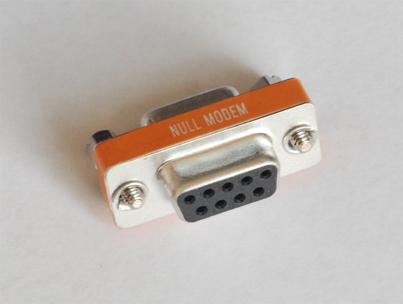

Did you use a null modem cable for rs232 connection? Regular serial won't connect. There is a thread at legitfta with the same problem. The final result wasn't posted, but there is a recovery file/loader attached to that thread.

Thanks for the reply. I used the same cable I used on my Fortec Lifetime Ultra receiver, which worked great with that receiver. Maybe it is the cable, going to order one and retry, and thanks for the info.

The loader sent the file to the receiver, but it still won't boot, but I'm also wondering if it is the wrong file for my version of the receiver. Mine is listed as X2 Premium HD II, other than case design, is there a difference between the X2 Premium HD and the X2 Premium HD II? The loader is listed as X2 Premium HD...
Did you use the files Carlos posted for you? That loader is called Flash download terminal version 1.0. I don't own these receivers, but I think that loader and recovery file should work for both.

Yes I tried those files, it shows a progress that it is uploading the file, and states that it finished, but still won't boot. I contacted X2, but haven't received a reply.

Hi everyone, still no luck getting this receiver restored. Contacted x2sat, they said: "the Nand Flash is damaged and will need to use the Programmer to solve it" but didn't provide any details or the Programmer. Anyone know what this is and what I need to give this another try? Does this mean I will need to open the receiver and use a TTL cable and connect to a terminal internally? THANKS!
