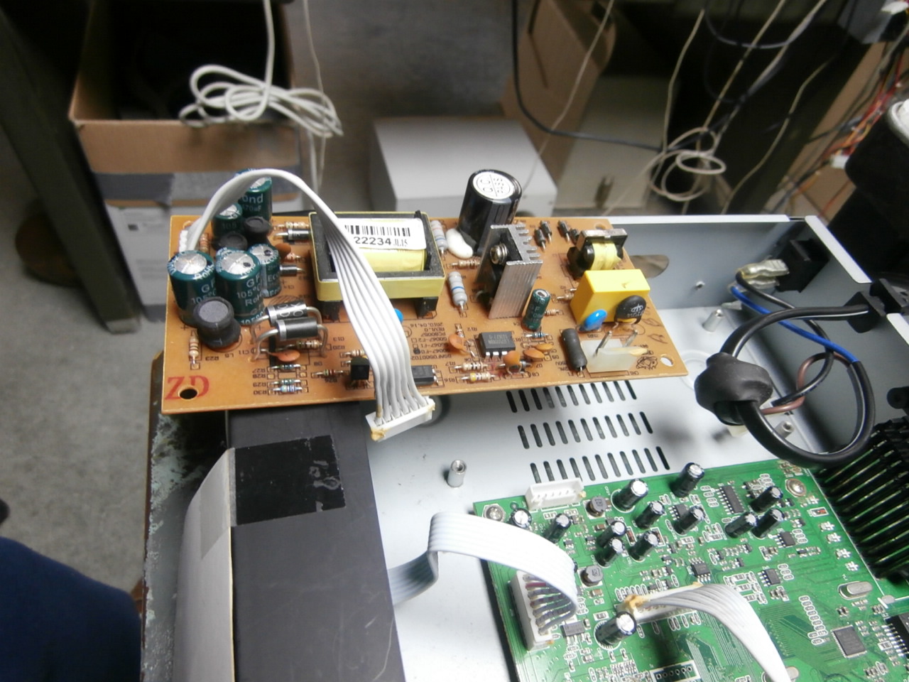

Hey guys, one of my S9 receivers has horked up. When I try to turn it on "ON" and the red led in the display are both blinking and it won't start? IIRC those things did have some power supply problems in the past so I'm hoping one of you can tell me how to fix it?

Put my meter on that thing today and checked the voltage at the RF out to the LNB and the voltage peaked at around 19v when it first came on and then the power turned off and it went to zero and back on was up and down and up and down, etc. It's cycling off and on at about twice a second +/-.
I've got two caps that are somewhat domed on top but the 3rd one isn't. Two that are domed are 10v 1500uf and the one that's not is 35v and 470uf.
It's acting like there is a circuit breaker on it that keeps on resetting?? If that's possible??? What do those look like and where is it if there's one in there?
Thanks.................
Here's a picture I just took. The two bulged caps are in the foreground.

Well, I got up this morning and decided to take the power supply out of the one that wasn't working and try it in the one that was working and I got the same blinking display as with the other one. And after looking at the power supply out of the working one it "appears" that those two caps in the working one had been replaced because they have a different brand name on them than the others. And FYI, I purchased both these S9s used years ago so someone probably changed them before I got it.
So, I just went on Fleabay and ordered what I need and we'll see how that works out.
Oh, and thanks for the help!!

Hopefully the new caps you ordered are at a little higher voltage rating than the originals.
Nope. The ones that have been replaced in the other unit are the same specs as the originals, just a different manufacturer. I found 5 pieces for $5 shipped and I should have them by Thursday and I'll have a few extras. :thumbup
Just saying...............
UPDATE: Got parts this AM and I'm watching TV on 103W as I write this. Those new caps were about a quarter inch TALLER than the ones I took out but the specs were the same. Maybe that will help them last, hey.
