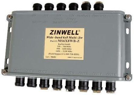

Can the Directv Wb68 Dtv 6x8 Switch be used with 3 dual Output Linear (FTA) LNBs?

Thanks, guys! I just picked up 2 of those from Amazon for under $33 shipped!
I've also heard that the flex ports can be addressed by software, if you're using a PCI card FTA solution. I think I remember that Diseqc command line options would do the job. It's been a couple years since I saw that thread. :) See this thread, http://www.satelliteguys.us/free-ai...xport-commands-zinwell-6x8-multiswitches.html .
Thanks for the link. I hope this helps with my DVB-S2 CA USB 2104D and switching issues. I will read through it and see what I can learn.
Shoot I find those for free on cable installs every now and then, havent kept any though except 1. I do have a nice assortment of 3x4 switches though :)
Do they require external power to operate? The Zinwells I have use a 24VDC wall wart that do not like inverters. They short out and then the inverter burns out.
That's the beauty of these.......they don't need external power supply.
Yep that makes em real nice not have to use external power, and these can be found free.
What will be Receiver ports/tone settings assuming the 6X8 is the only switch in the mix and connected to 2 dual output LNBs?

Add 4X1 to the mix
Can the 6X8 switch be cascaded with a 4X1 switch as demonstrated by Iceberg in this thread? How will this be setup in the receiver assuming 6 satellite with motorized KU and C-band.

Cascade: see post 9 of...Switches Simplified FAQ
http://www.satelliteguys.us/threads/134124-Switch-setups-simplified
And for more info on the switch, see this thread by Pendragon:
http://www.satelliteguys.us/threads...6x8-Switch-with-Power-Insertion?highlight=6x8
Edit: we'll since you changed your question, let me add...
no receiver is ever going to see that switch as more than a 4x8.
And that is TWO LNBFs.
Getting the other two inputs to work at all, is contingent on custom programming of a card- or USB- based receiver.
