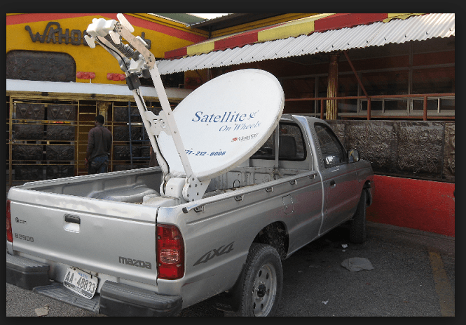

Not available in the USA from a vendor I'd deal with. What's your second choice?
Option #2 T.I.M.I.U.T (The Iceberg Move It Urself Truck)
