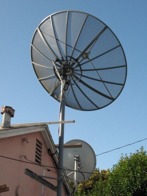

Hopefully the 7.5 footer has prepared them for this nicer dish. Also, being on such a tall pole, the 12 footer may look a bit smaller than it really is. What diameter is the pole, will it be freestanding?

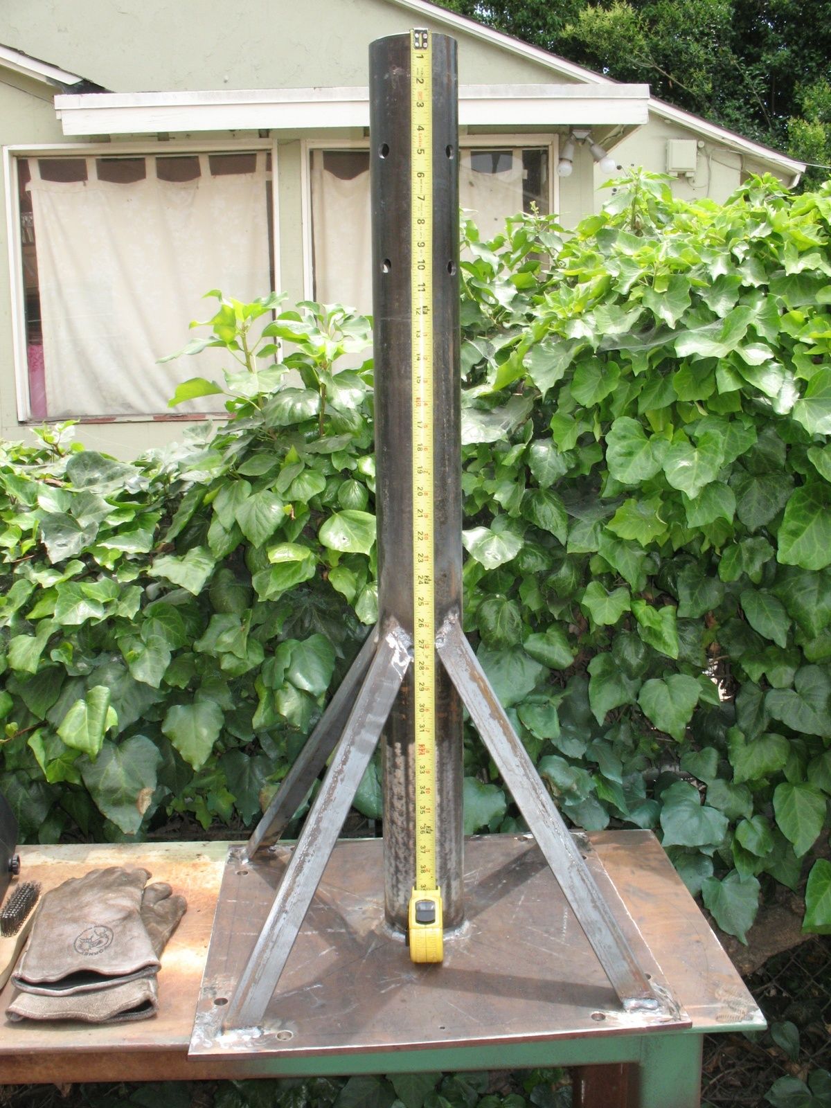

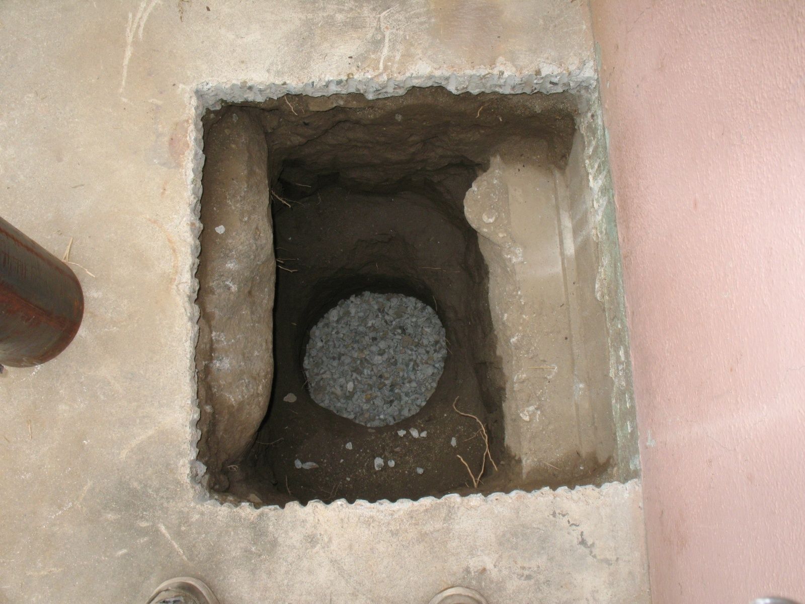

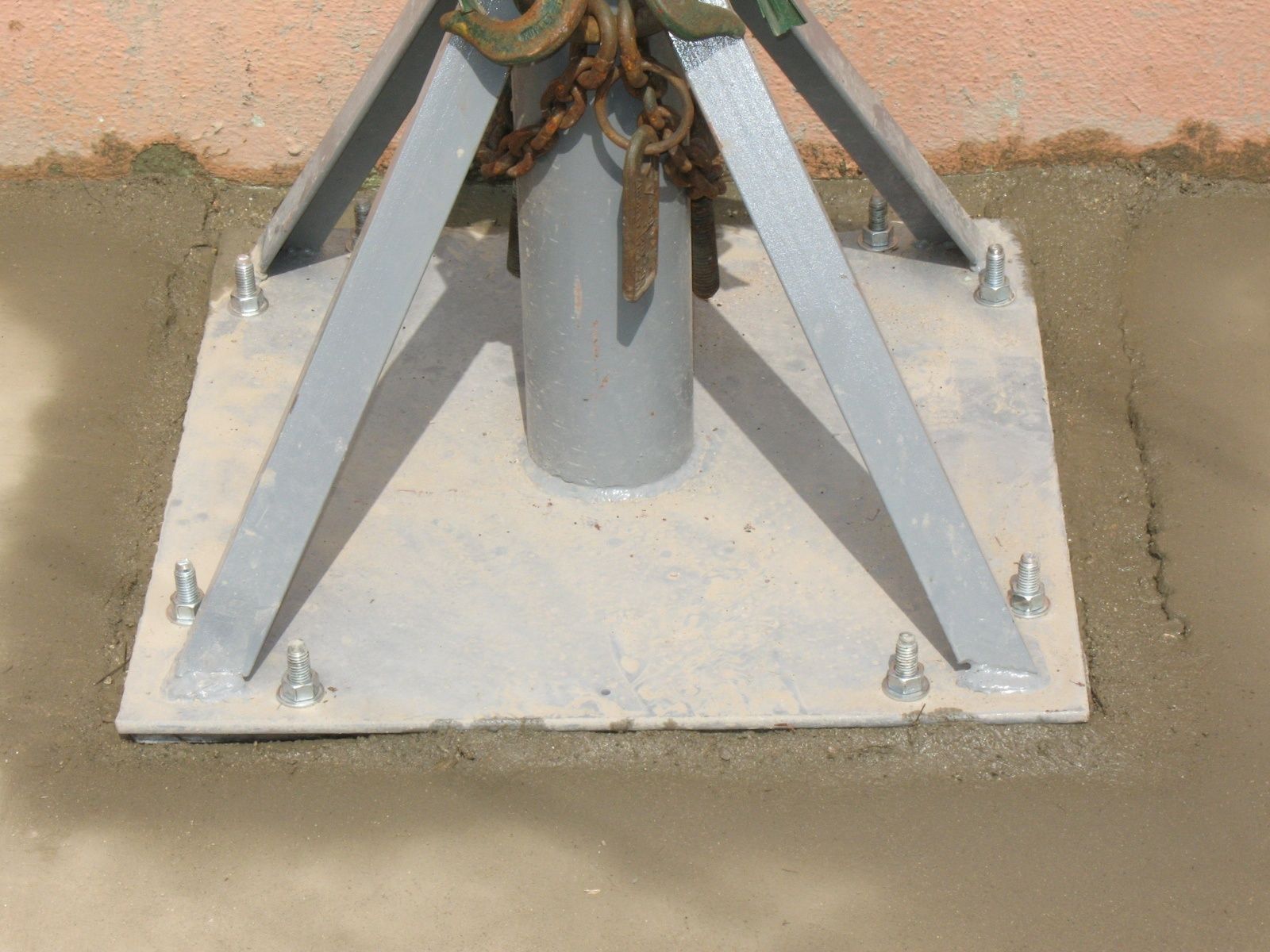

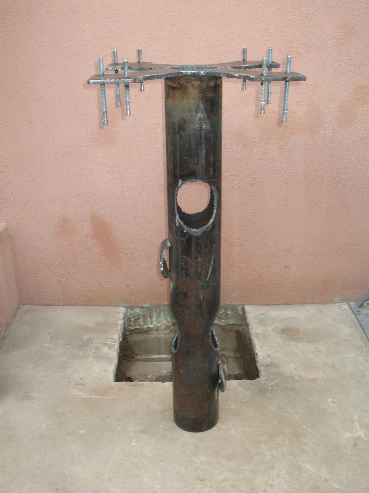

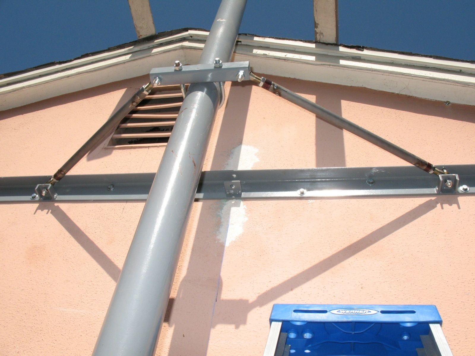

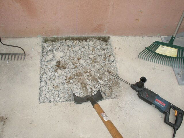

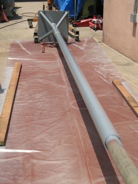

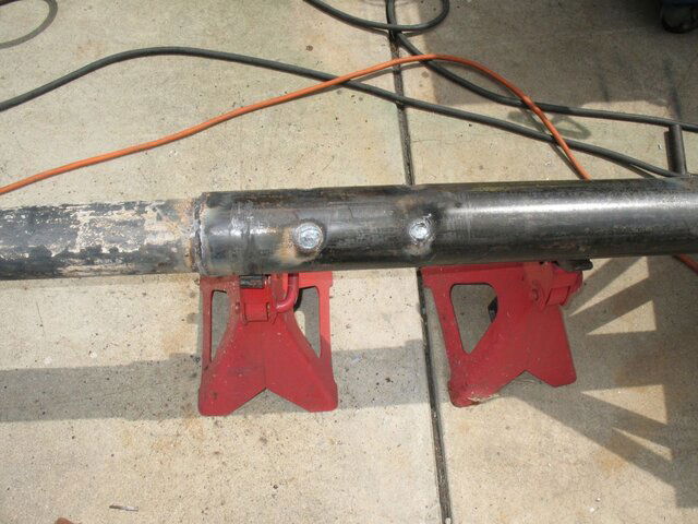

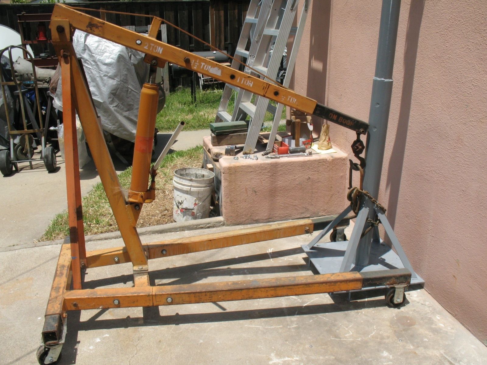

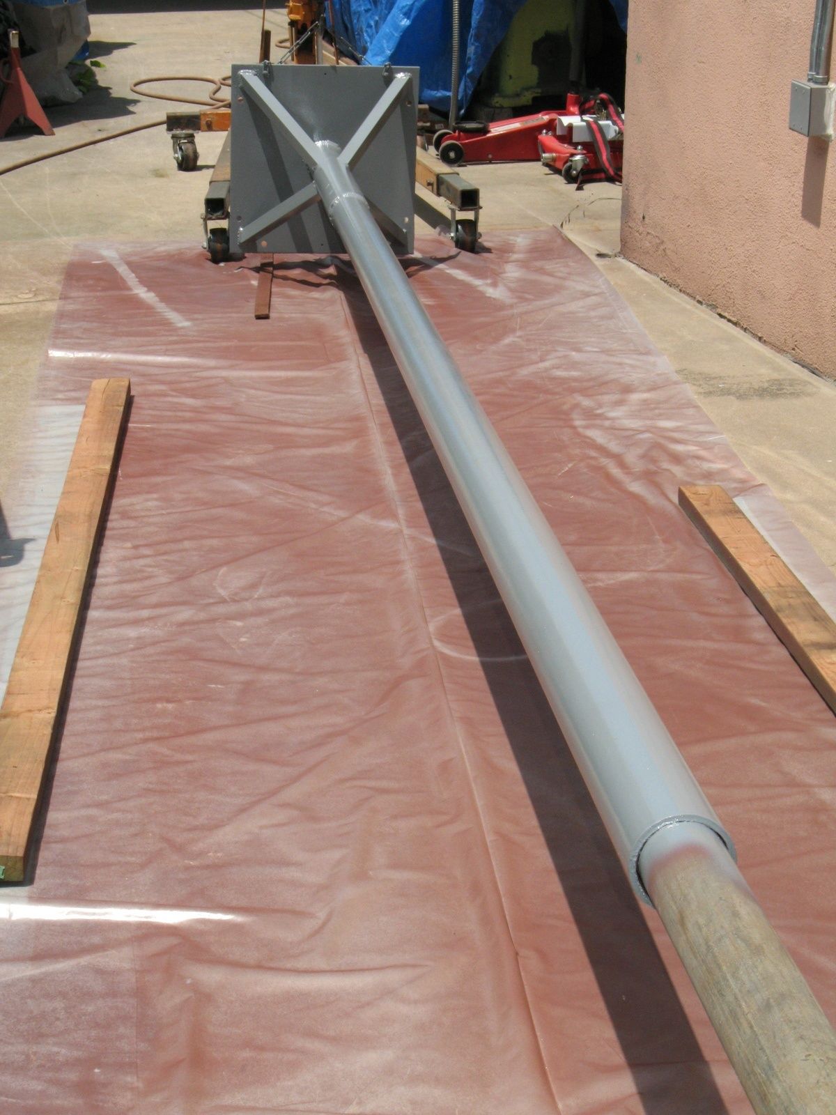

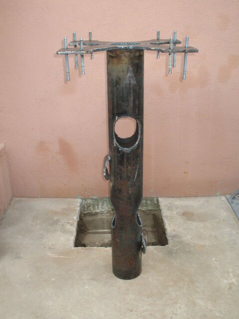

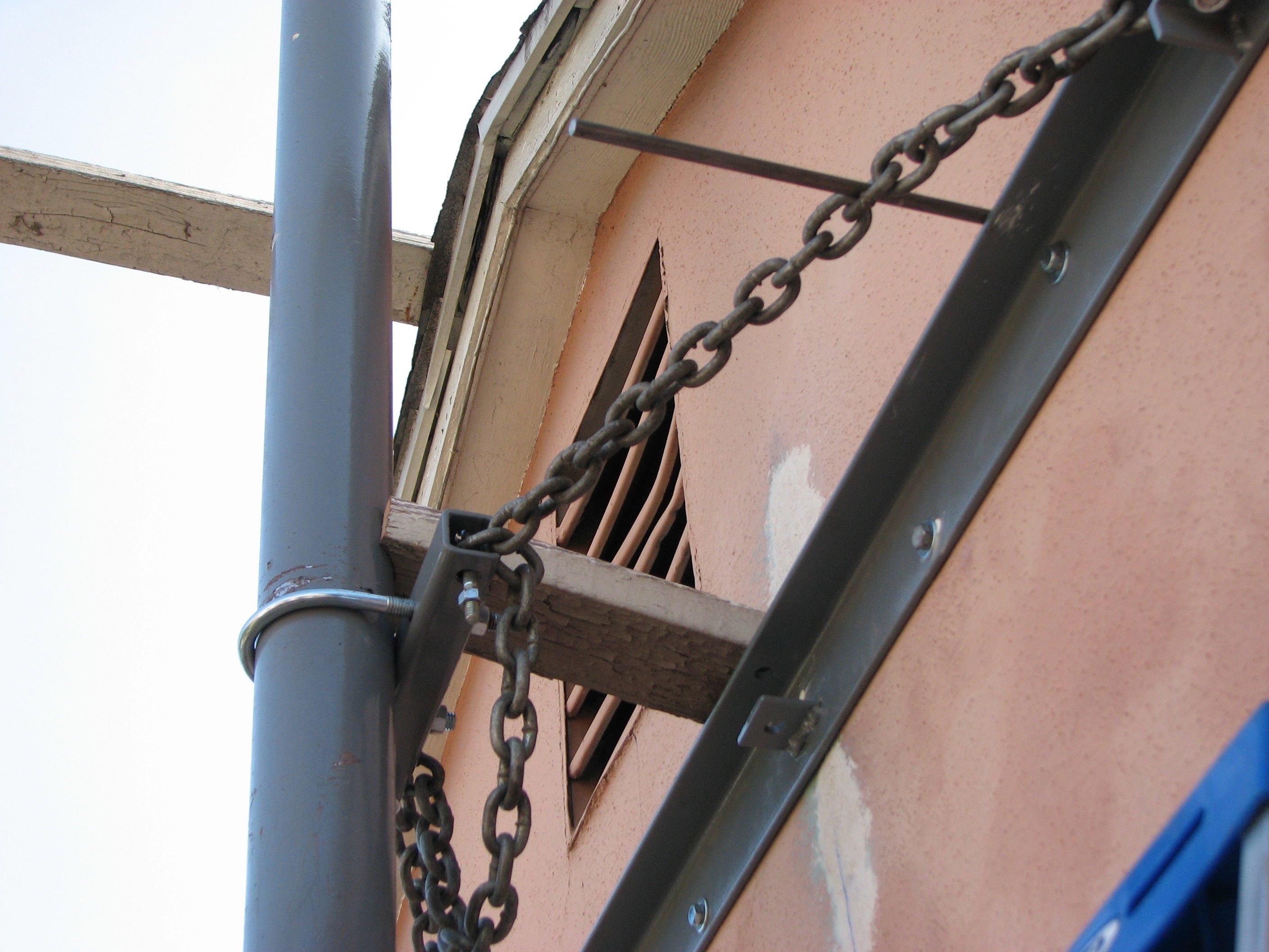

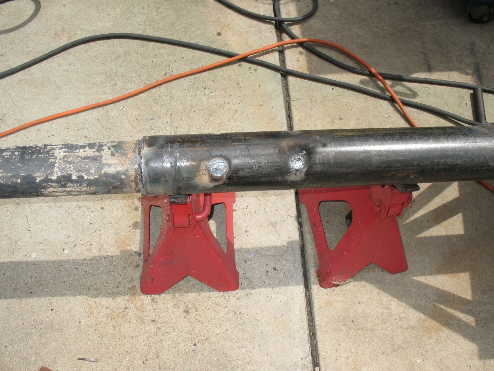

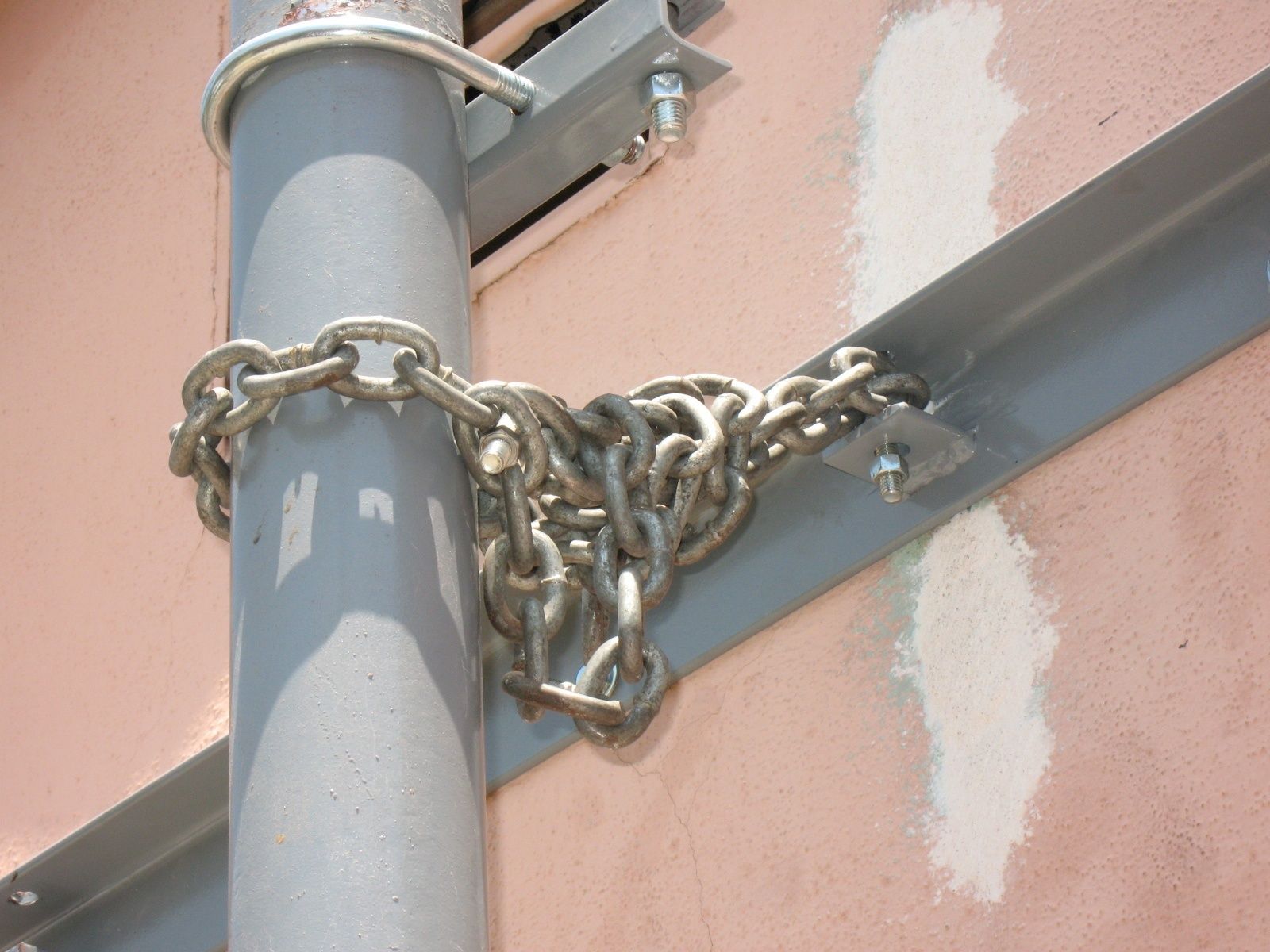

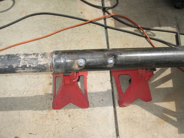

The pole is 16ft tall, 3.5" OD oil field pipe sleeved up to 4" OD with four 1 1/2 angle iron braces welded to a 22" sq. plate of 1/2" hot rolled steel. This is secured with eight 1/2"studs & nuts to the footing which is another 22" sq. plate welded to 6"OD pipe 4 ft in length with 4" holes in the sides to allow the concrete to connect in the footing. Seventeen(17) 90 LB sacks of concrete were poured in the footing, which is between a 500LB boulder & the house footing. The pole is braced with 1" diameter turnbuckles to a 8 ft long 3"x4" angle iron secured to the wall plate at ceiling level with eight 3/8x4 1/2" lag bolts that alternate in the doubled up 2x4s of the wall, 9+ ft above ground level.

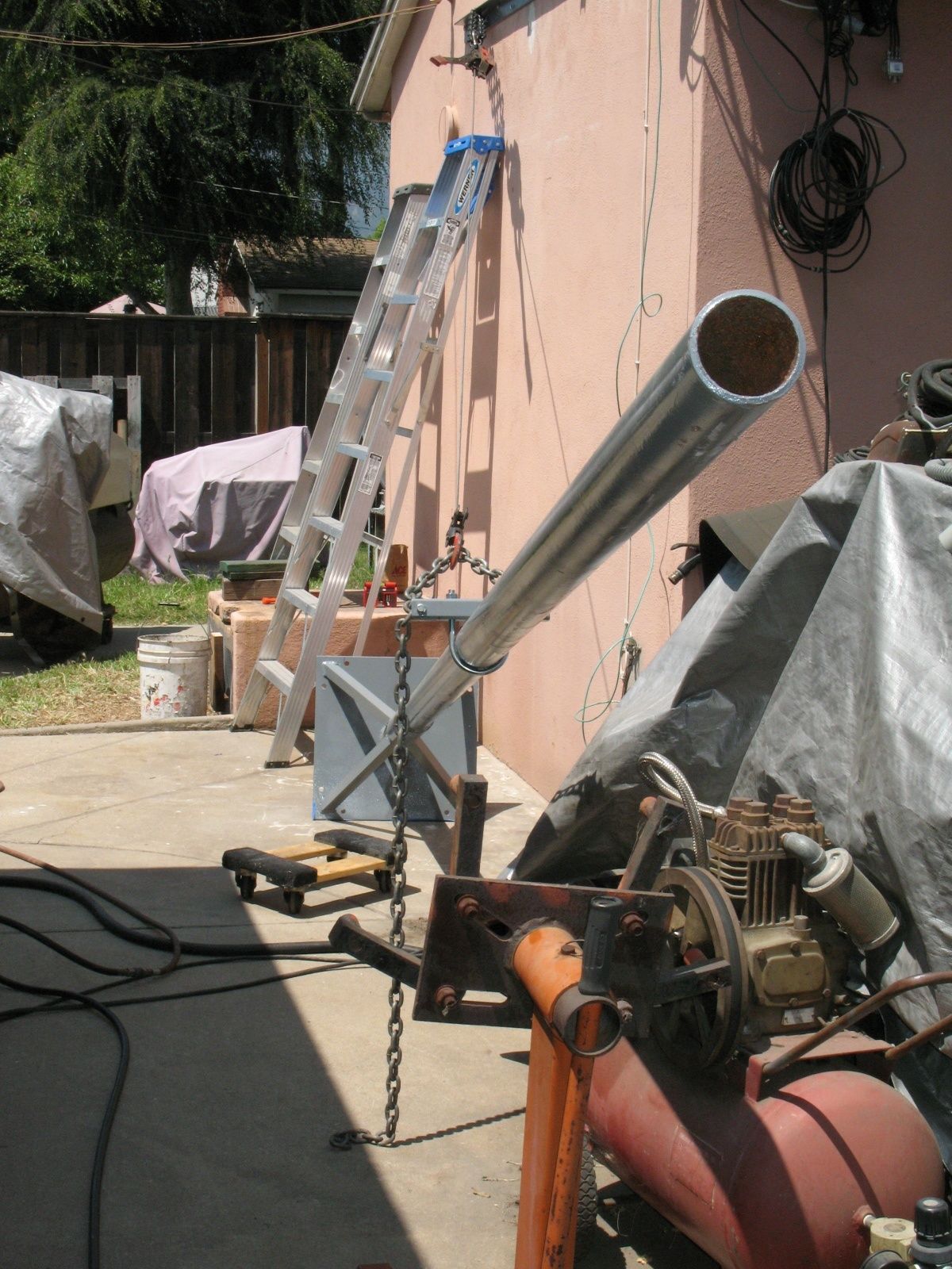

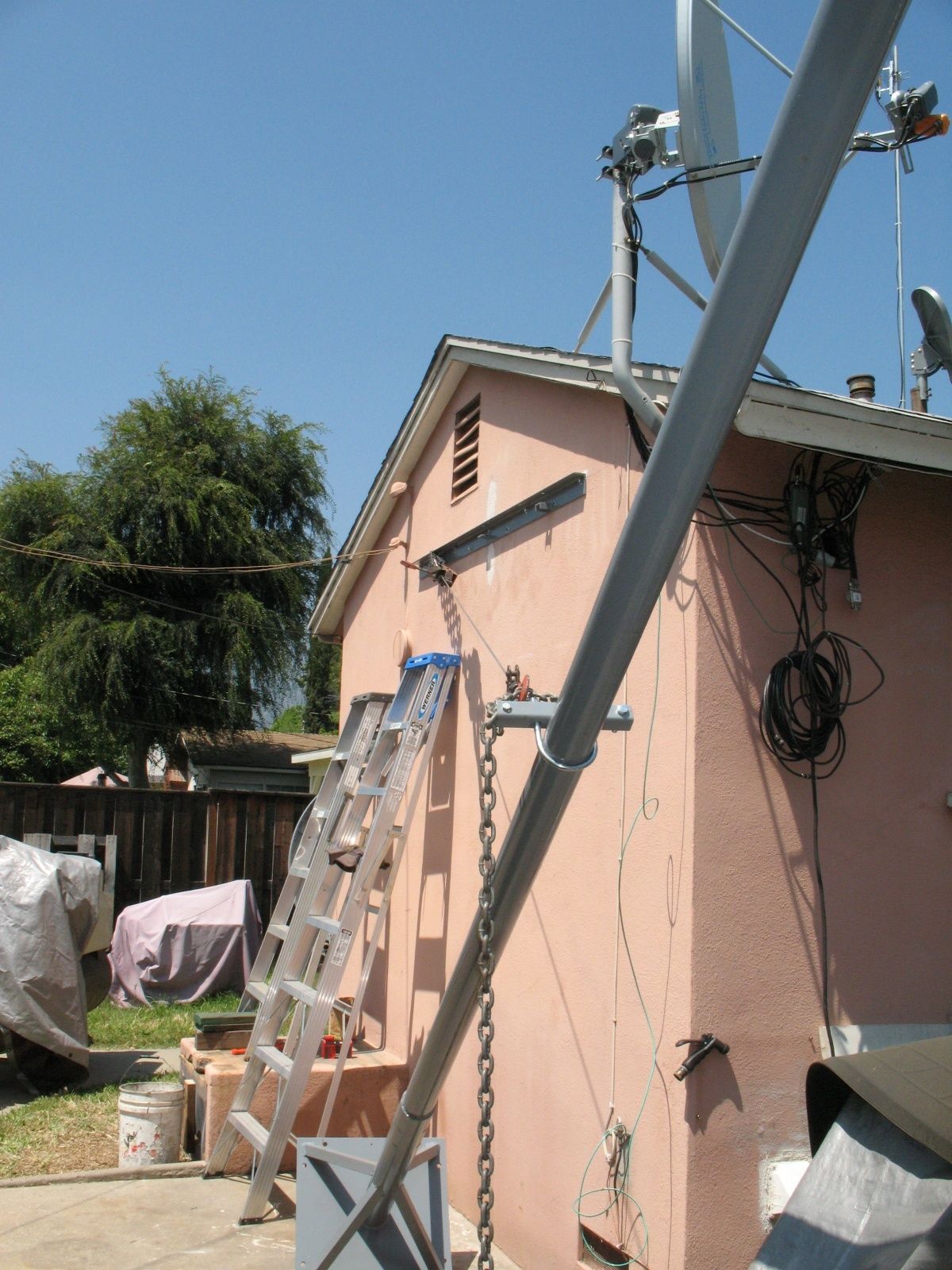

I tilted the pole up with a come-a-long & chains between the mounted 8 ft angle & the pole. At about 5* from vertical the pole moved the remainder to upright. Then, with the pole loosely chained near the top, lifted the whole thing with a cherry picker & dropped it on the studs, truing it with a 2x4 block + chains bolted down to the footing, then mounting the dish after 10 days curing. It wasn't very far out of plumb so it took very little to trim it with the turnbuckles.
Lots of torch & grinder work. Lots of welding & painting work. Lots of planning.;)
It doesn't flex in the wind much at all, but the springiness of the oil field pipe helps in that respect.

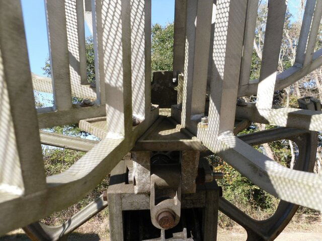

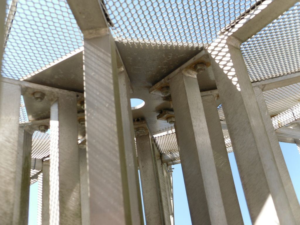

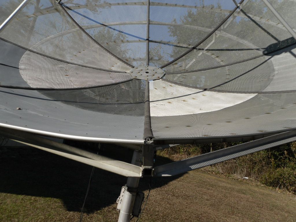

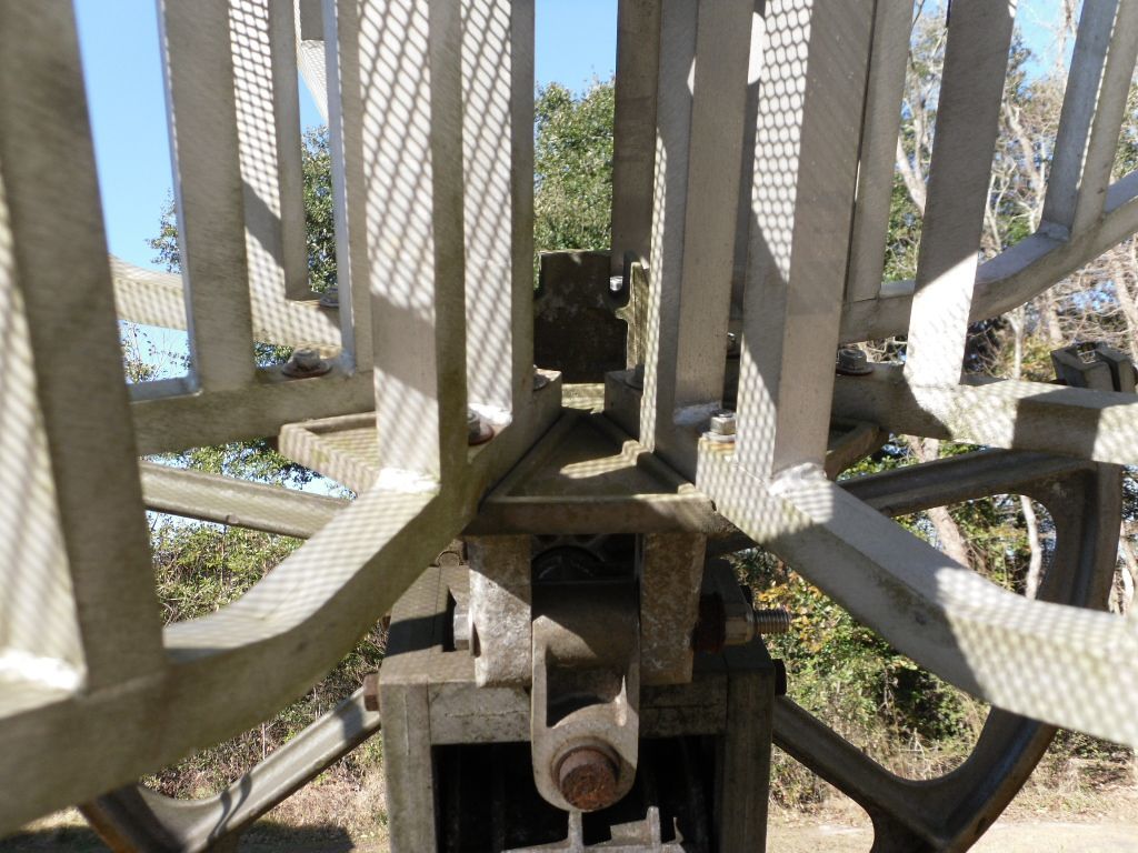

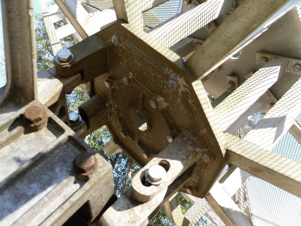

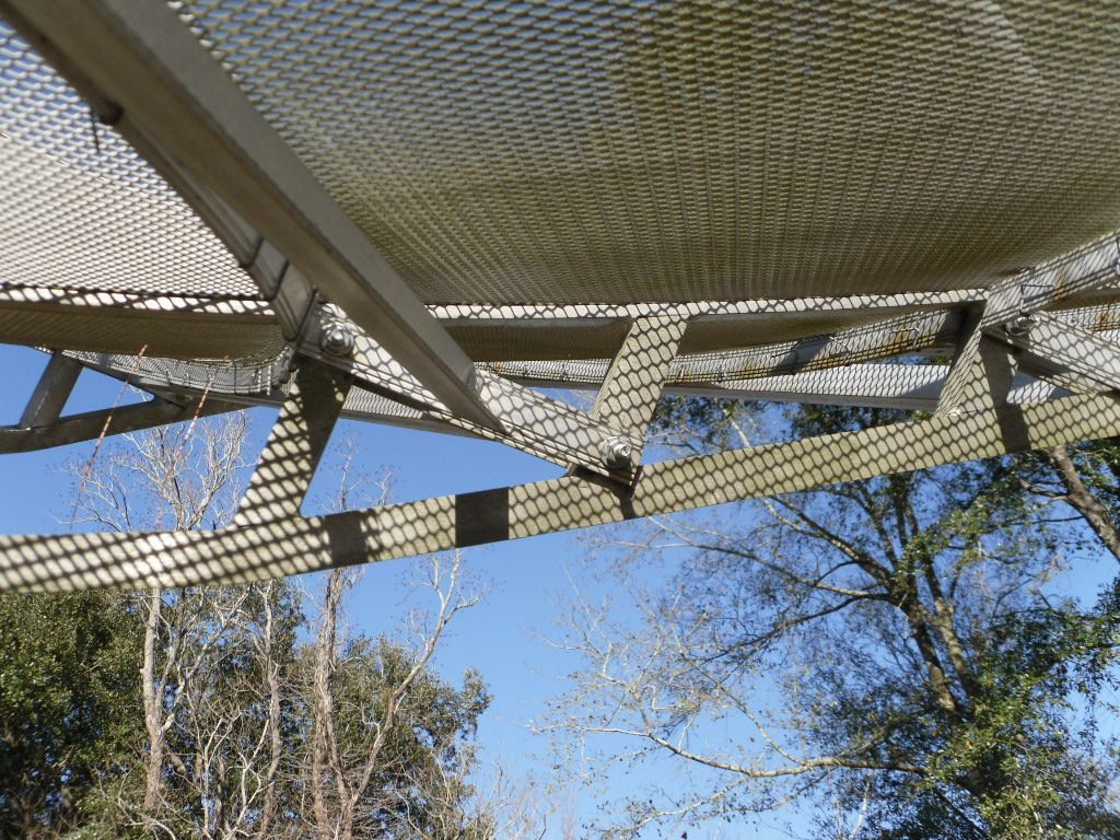

I'd have to take some pics on my dish for you to really explain it.....remove HALF the bolts in the hub, then remove JUST the bolts needed to break it in two. There's no need to remove them all, just the ones you need to take 'er apart. The buttonhook might interfere, I don't know. Lemme go take some pics...
EDIT:
OK here we go. First pic is the bottom. Each rib has four bolts holding it to the hubs, remove two bolts on the bottom plate and two on the top hub plate for EACH rib you want to remove. I think I removed three or four ribs . You can remove however many ya want, really. Second pic is the back side of the BOTTOM plate, to show the back. Third pic is the TOP plate, disassembly is the same as the bottom. Fourth pic is the bolts that hold the slices together. You ONLY need to remove them on each side to break it in two, in other words, like in the forth pic, straight across where the mesh panels meet. I hope that made sense. You going to need to remove the pieces that hold the mesh in place, depending on your dish, some of them used a screwed on piece, some have the groove like mine does, to allow the dish to come in two. If you need more clarification post back...
