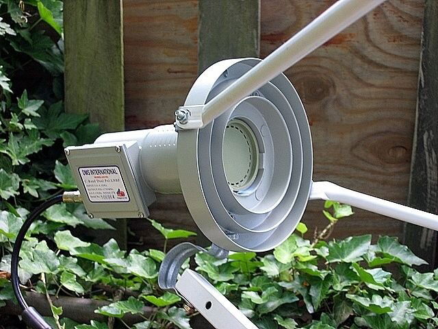

120cm dish with C-Band performance - Now with HD!
CharredPC said:
Sounds great, but I'm having a problem picturing it...
You wouldn't HAVE any pics, would you?
Also, what occurs to me (unless you just described it) is using a 3-lnb setup on the 120cm; the center being the C-band lnb, a Universal Ku and DSS lnb on either side. I picked up a circular polarized lnb today (read: UNMODIFIED, lol) and slapped it temporarily next to my Universal so I can try getting my 4*1 switch working.... but that's another story ;)
no pics...just dont use the plastic saddle at all. use some two inch corner brackets and bolt from the end of the support leg and the scaler ring. the focal is perfect...yes ...use a c/ku feedhorn, the skew is a factor for the c/ku band, this has nothing to do with dish or dtv, this is a great c/ku dish that will power your fta receiver. you can bolt other bracket to the scaler to provide off set feeds like with a regular c band setup. there can be some adjacent satellite interference

It'll be very interesting to see the results for the combined Ku/C-Band LNB Sadoun mentioned earlier, as soon as I know, you'll know.
I'm expecting an analogue receiver courtesy of MrBurg next week, if I can see enough analogue stations I'll be posting those results too.
With the setup I have at the moment I'm running over 100ft of RG-6 with a 25ft run of regular indoor cable to the distribution point on the side of the house and about 75ft of quad-shield underground from there to the dish.
More pics later today if I can get rid of this aching back.
Edit: Don't forget about the 5% discount Sadoun are running for our members right now.

After messing for a few minutes tonight I've come to the conclusion that the focal distance needs to be increased by 10cm or so.
Here are my level readings off Anik F1 which is really the only sat I've thoroughly tested:
Freq/Pol/SR/Qual/Sig
3780/V/28346 - 100/58
3926/V/6150 - 100/70
3936/V/6150 - 0/22
3962/H/6500 - 0/11
4060/V/28346 - 100/75
4100/V/28346 - 100/70
Galaxy4R:
3860/V/28340 - 100/42
AMC1:
4005/H/18800 - 100/41
IA13:
3980/V/27690 - 74/20
Galaxy13:
3800/V/27690 - 36/100
Still a few transponders with quality without signal but I've noticed a lot more English speaking channels on C over Ku band.
