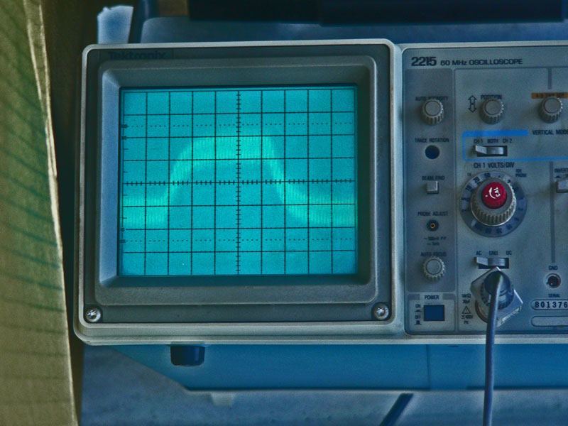

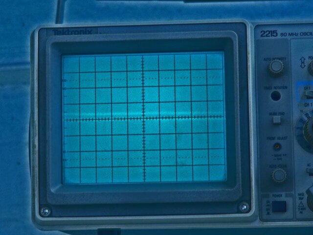

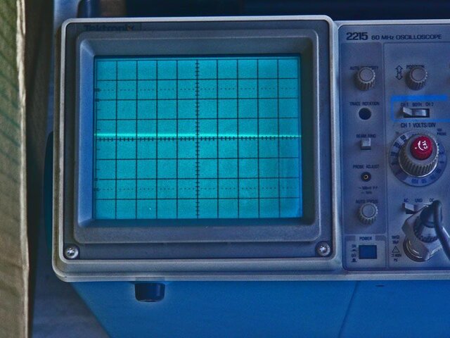

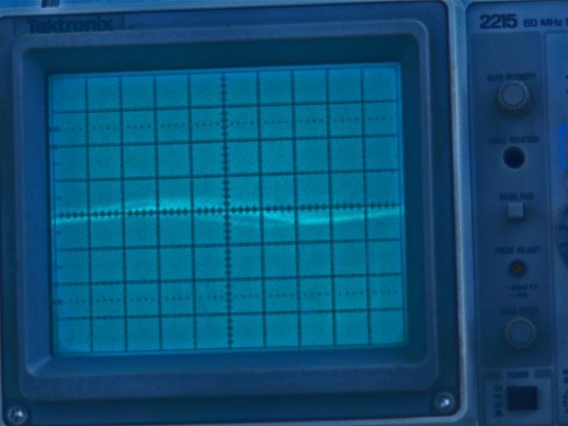

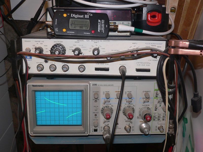

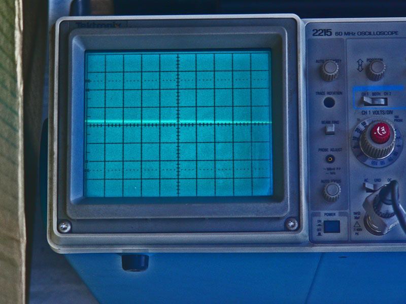

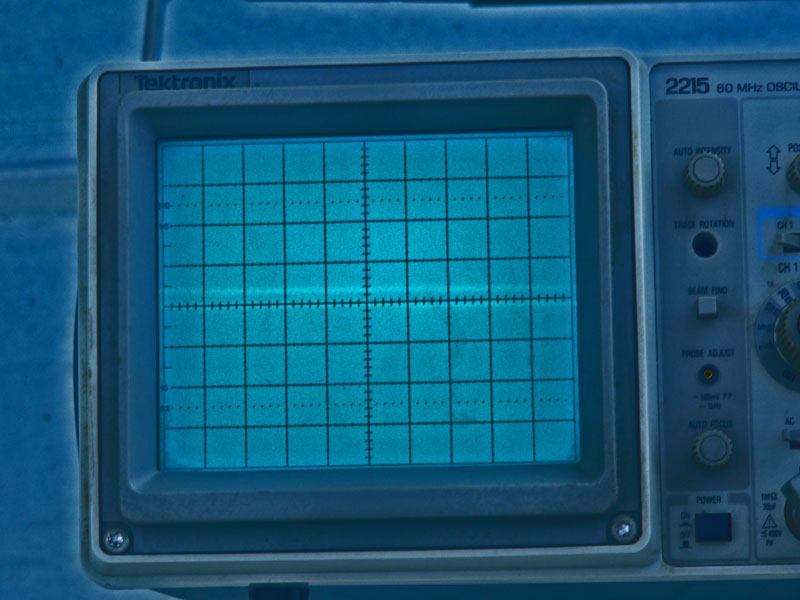

Took my scope this morning out to check for 22KHz coupling through the LNB. I see some, but have no idea if its enough to cause the problem. Even in shadow on the roof, the sky was light enough to wash out my photos. So the outdoor ones were enhanced to see the waveform better. All have the same time and voltage scales, AC coupled.

I agree, the signal through the LNB looks pretty small; to cause what I see as interfering from one system to the other.
