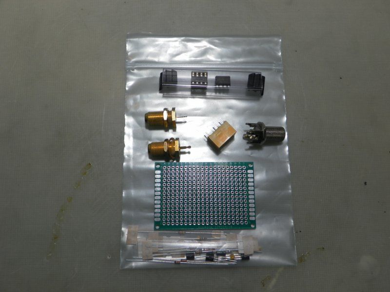

There are no 2 port DiSEqC 1.0/2.0 switches available that I know of. But thanks to N0QBH there is a plan to build a 2x1 switch here (scroll to the bottom of the page)
I happen to be in need for one myself and decided to build this switch to suit my needs. I gathered up the parts. Some assembly required. ;)
