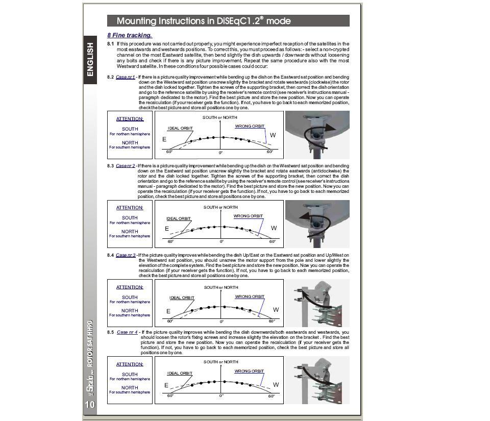

Follow this guide.

Backlash adjustment fixes EXACTLY what you describe, the side to side 'wobble' in the motor shaft itself. The 'zero' is a different thing entirely....you should have a hole right next to the green light on the motor, you can reset/rezero the motor by sticking a paperclip in there and gently pushing the reset button.
Backlash is a bigger problem I would think on the larger dish/motor combos where there is considerable strain on the shaft...I am not wild about hammering on my motor either BUT if I suspected that backlash was the problem I'd get myself a meter and go at it.
In your case I would eliminate everything else before I did that though. What I would do is take the whole thing down, reset the motor, reset the receiver, and start over like it was a new, out of the box install. Like Tron said above, use the latitude side, disregard the elevation side.
