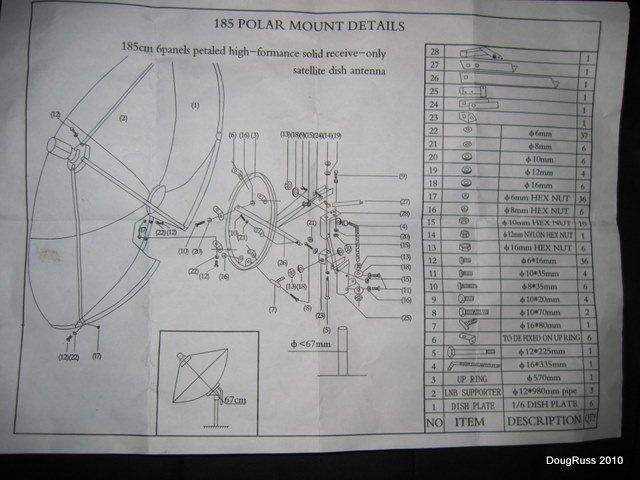

Didn't come with mine, can you PDF it and post it?
Thanks
Mine was Folded up in with the Hardware package.
I don't have a Scanner to send you a copy, sorry.
I took a Pic of it................

Thanks for the pic. The exploded view shows the lnbf supports coming from the outside rim of the dish, while your pics show them coming from the outer row of securing bolts. Your pic seems to go with the anatomy of the panels, so I wondered .....

Each panel is notched at that position, on one side. The documentation is probably for a similar, but different dish. I have to say the Doug is one fast worker. I'm still piddling away at assembling the dish. I'd be digging my hole later this afternoon ( wrong order, I know, but I just HAVE to put the dish together !) .

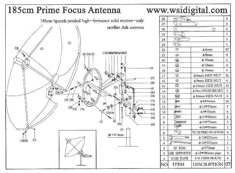

For comparison, here is a picture of the attachment arms from the WSI website. Robby did say this model is slightly different.
