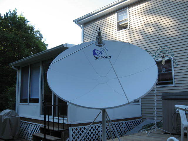

I have a 6 footer that looks just like what wsi is selling from sadoun.(man you guys are really getting a deal).I have noticed that wsi dish dosnt come with a center cover leaving a hole in the middle.Can there be some signal loss because of the hole!Just wondering.
I don't think there is any appreciable loss. If you think about the dish reflecting back and focussing into the throat of the lnbf, it's hard to imagine that small area having much of an effect.
I think we're getting a deal, BUT I think the Sadoun dishes are a little heavier weight steel.
Thanks! That hole should make centering the LNB a much easier job.I think you will be happy with a 6 footer!Dont know if you was getting any dvb-s2 with the 4 footer!but im sure you will be getting it with the 6 footer:).
