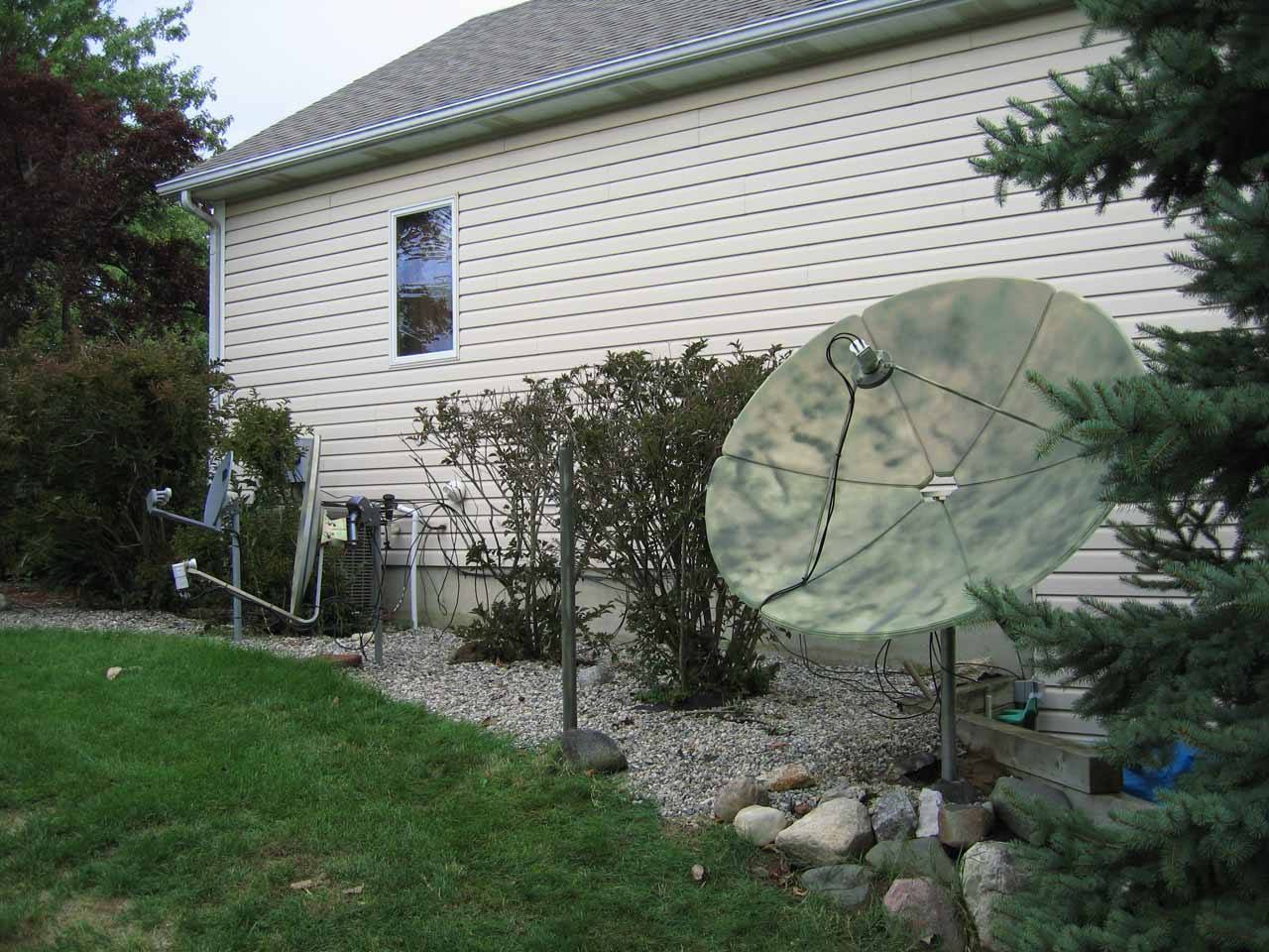

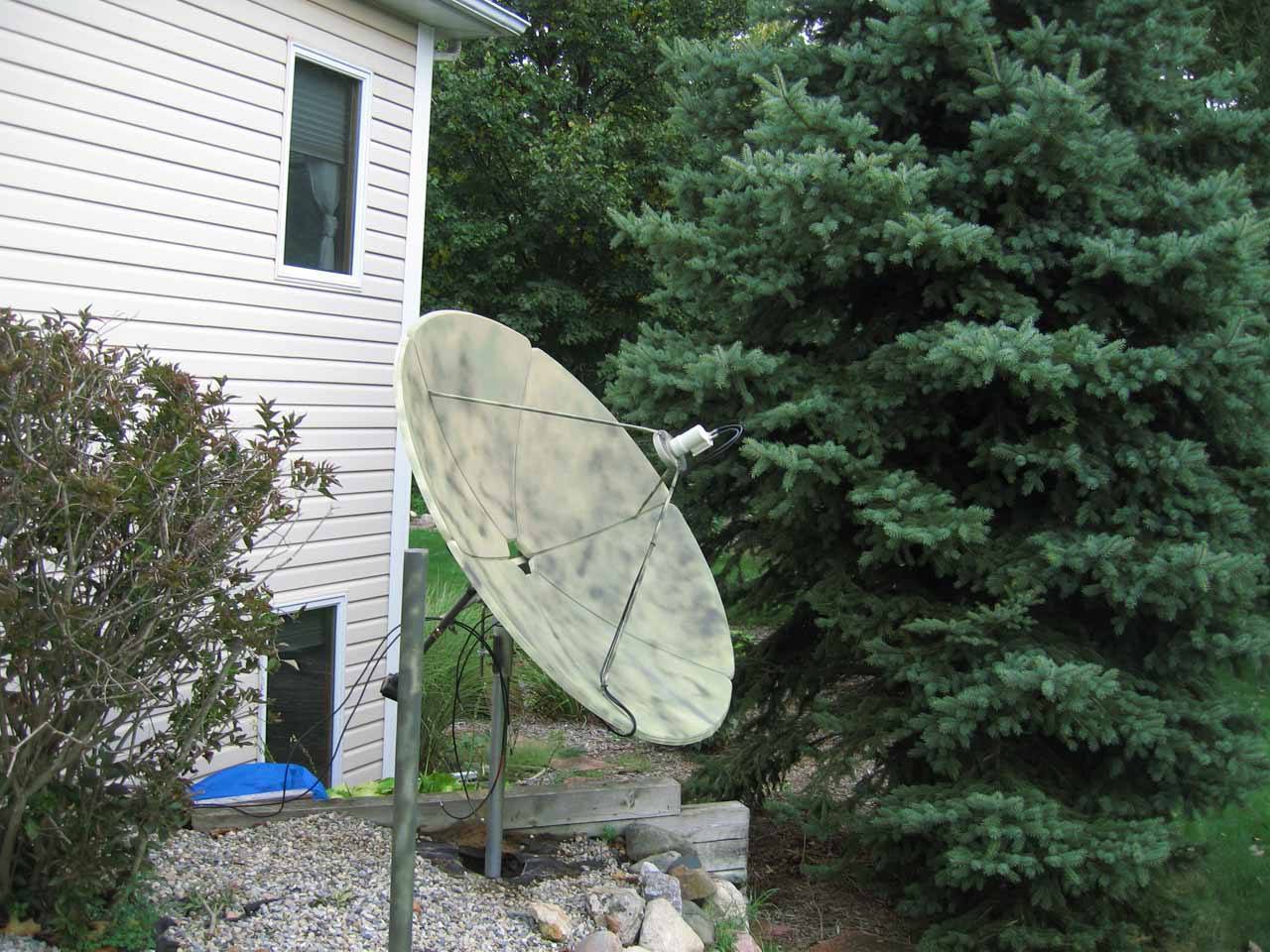

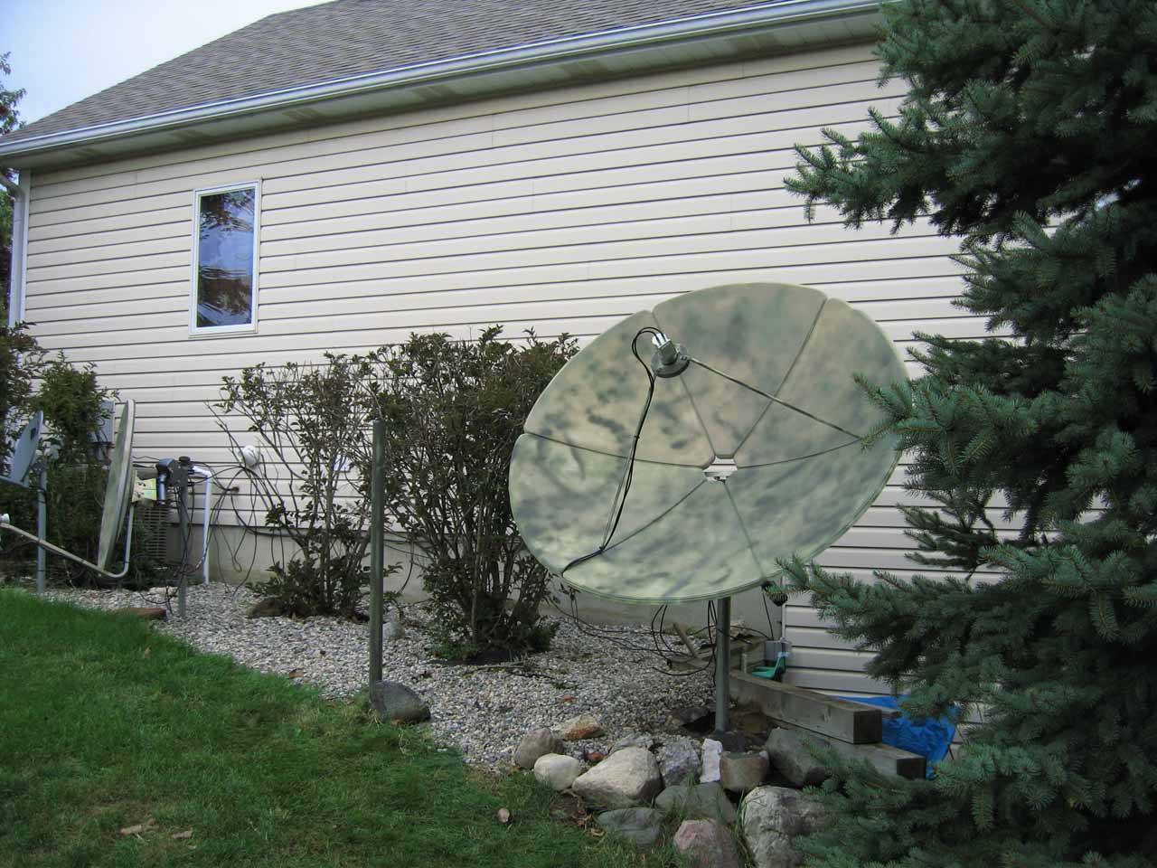

I know what you mean, I went to Menards and picked up a 2" pipe and PVC couplings. Then today I went to Menards again for 3 bags of concrete, then later today went to the local hardware for a stick of 1/2" threaded rod . Picked up some 1/4" and 3/8" flat washers while I was there.
Pole is in the ground, though, and the dish is assembled except for lnbf and support rods. By Monday, I'll be brave enough to put the dish on the pole, and finish the assembly.
I get DVB-S2 stuff on G17 C-Band on my Minibud right and plenty on the KU side too.
What I would LIKE to get that is DVB-S2 are the 9/10 FEC feeds, and that's not going to happen with a 6 footer. Mostly I watch TV in the evening while I read, preferably sports. The 6 footer should give me more than I've gotten this summer, and that'll be a plus. ZombieSAt has ruined my summer, since it caused Peachtree TV to leave 131W. I'll never forgive it !
Getting close here ! Looking everywhere for my inclinometer, to dial in the 40.7 inclination to start out, I may just have to "wing it" .

nice pics brentb636, especially the camo paint. looks like you have a open pole waiting for another dish ;)
Ha !! Reading about setting up the actuator and Elevation and Declination angles . Found out that I should reverse the side of the actuator. Mine pushes on the west side, and it should be pushing on the east side. I also need to get a longer bolt for the pivot point at the end of the actuator. The existing bolt is too short to give a "straight push" for the actuator. Meanwhile , I have the dish fixed on 91W and am enjoying the best signals I've ever seen from that bird. Definitely an improvement over the mini-BUD setup.
