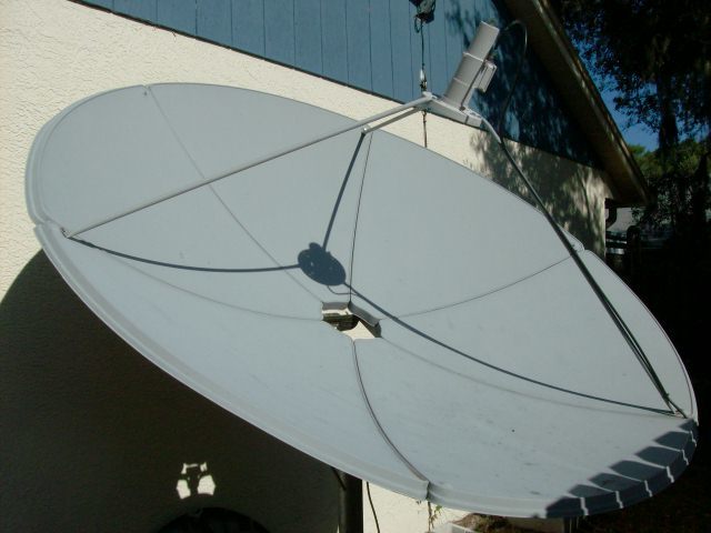

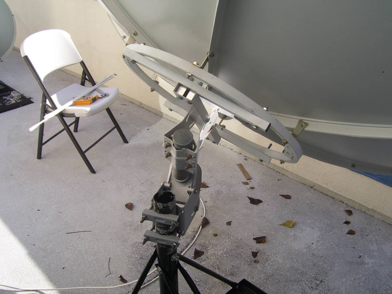

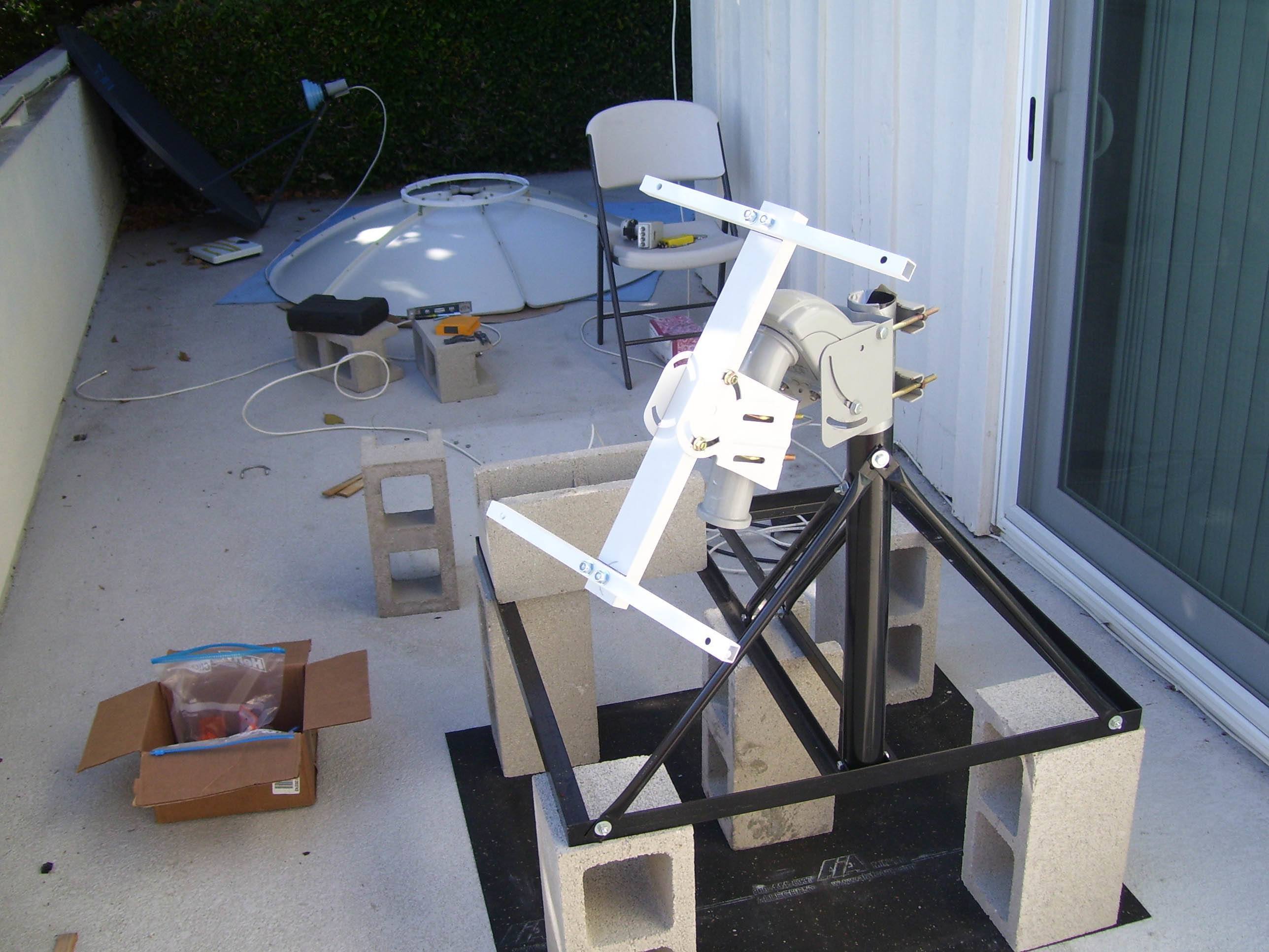

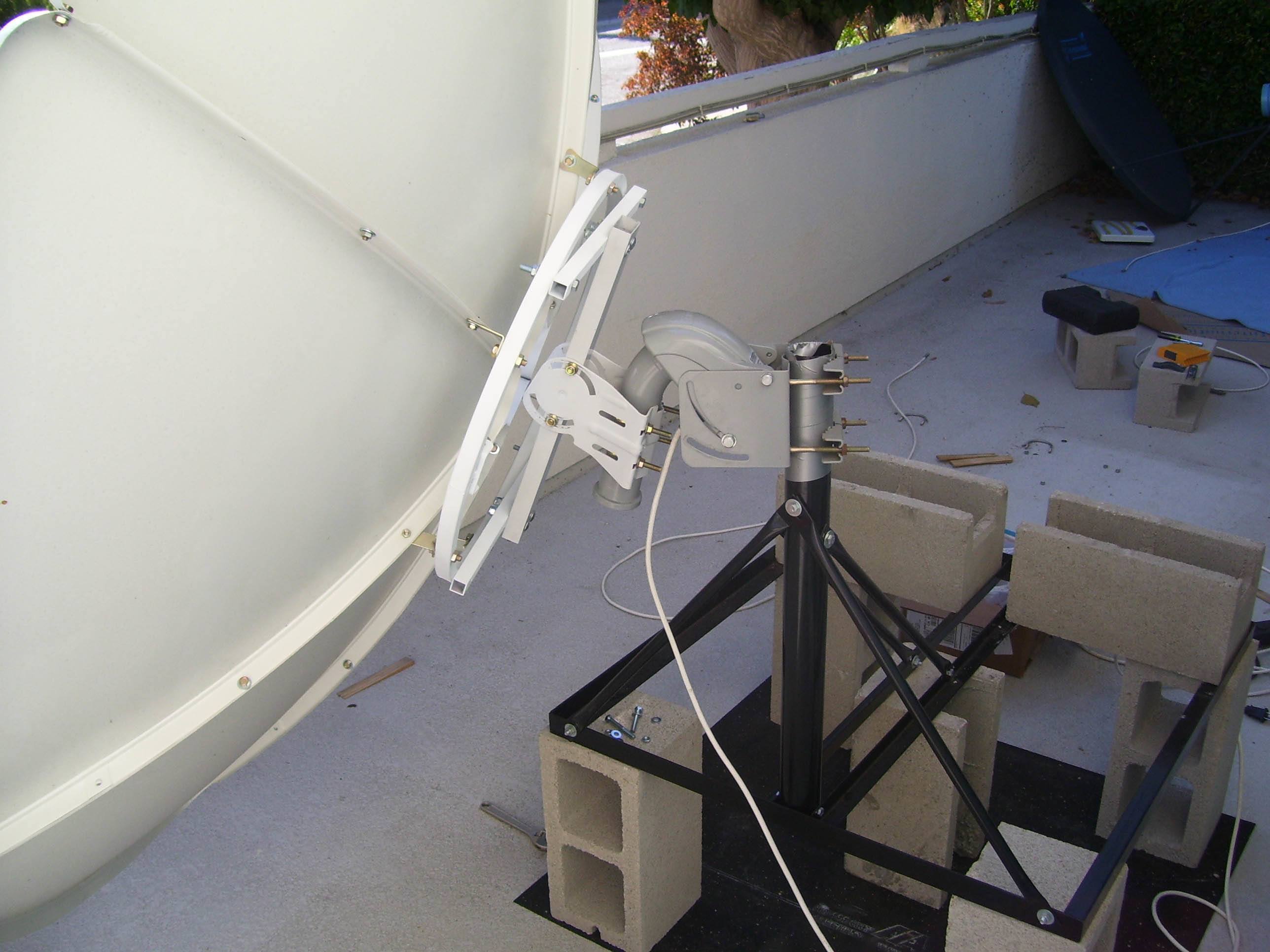

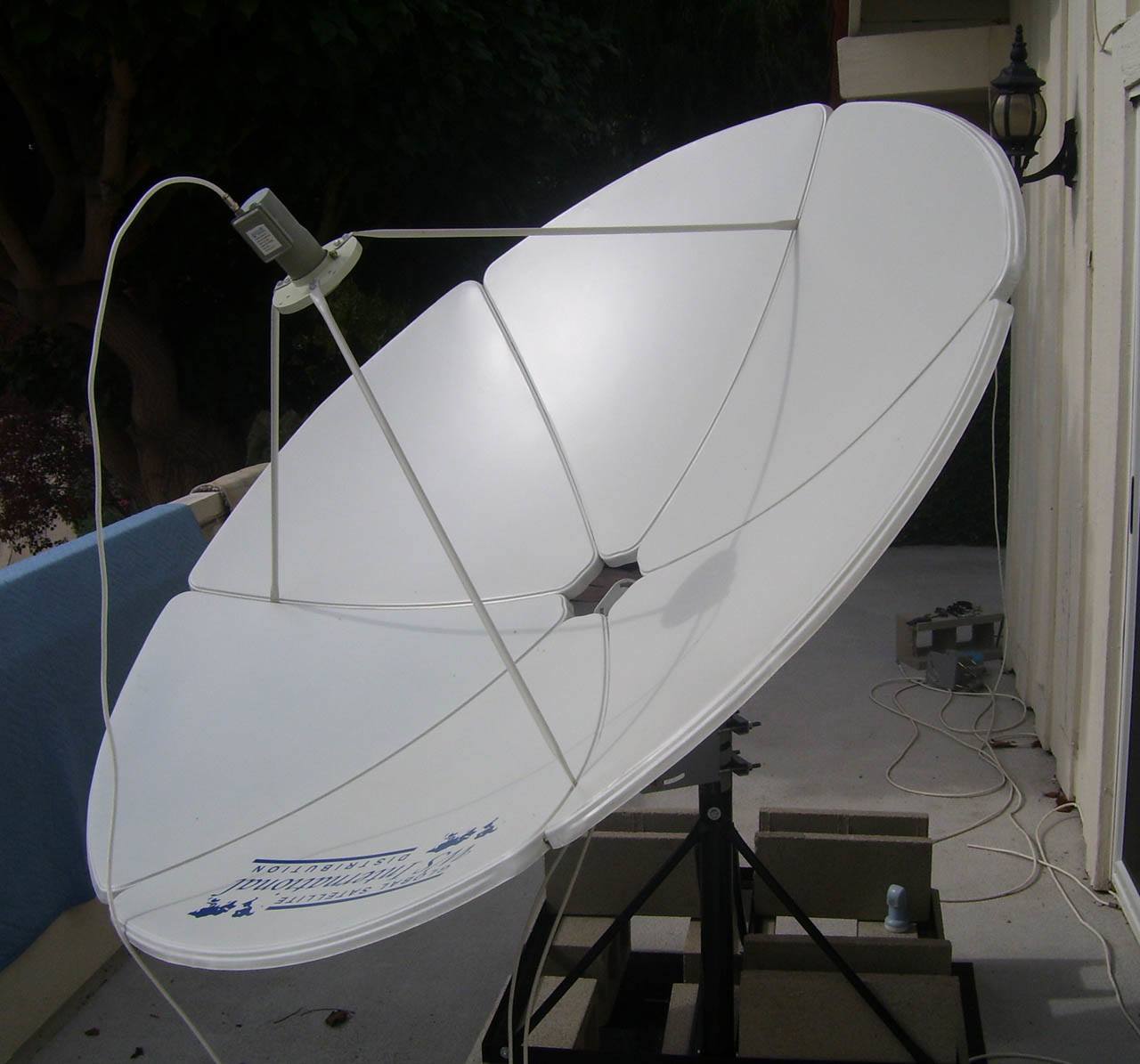

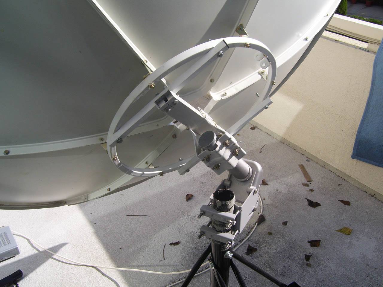

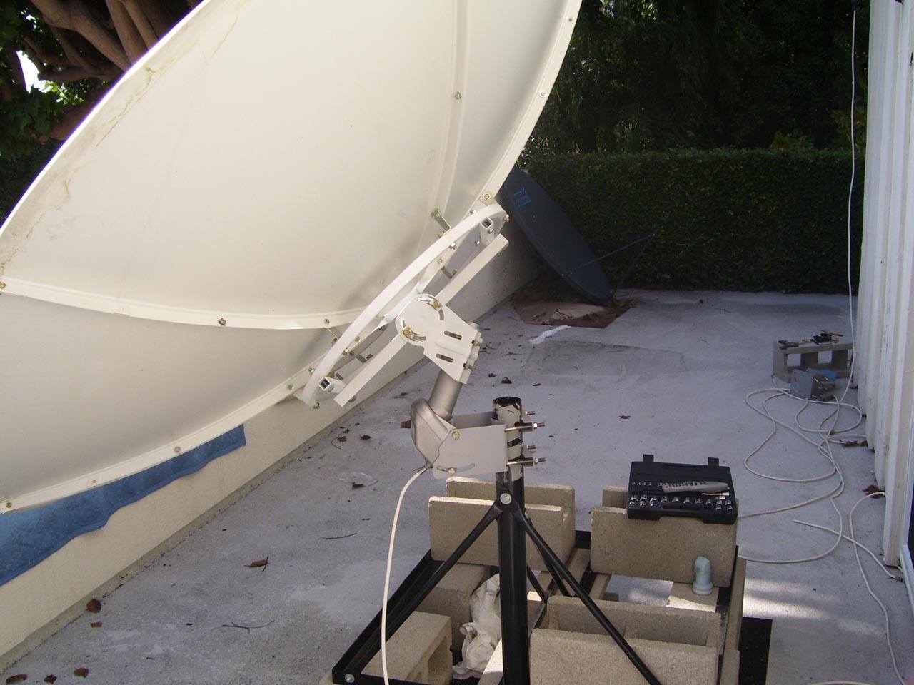

I'm currently using an HH120 motor to move my 6ft WSI dish. See attached pictures. I ultimately would prefer to use the SG9120 motor as it moves faster and doesn't have any play like the HH120 but I need to further modify for the bracket for elevation so for now the H120 is working fine. I had to make a modified bracket and its really only possible because the total weight is similar to a 1.2M dish. You may want to weigh your fortec dish before attempting because my guess is the metal sheets are heavier than the WSI model. I can move back and forth between my LOS 72-135W with no prob.

Ok. Thanks. Those are the couple of photos I had. Yeah the Fortec is heavier than this new WSI dish I have now.

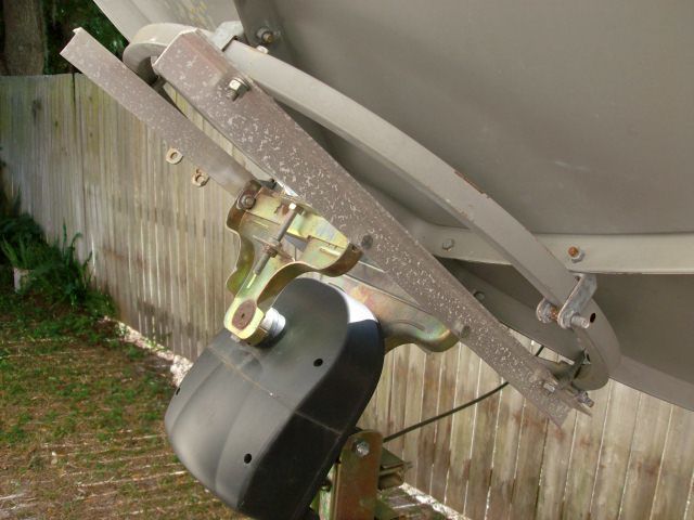

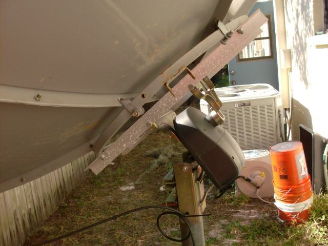

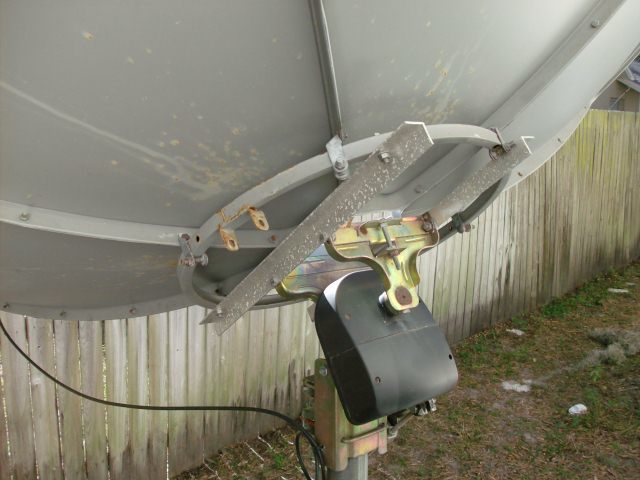

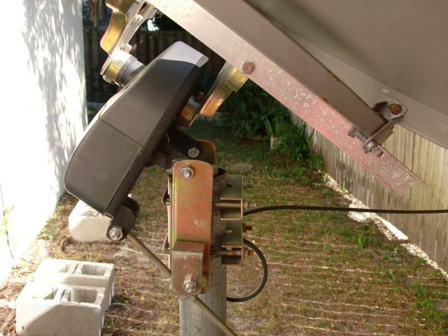

Is this what you are looking for?

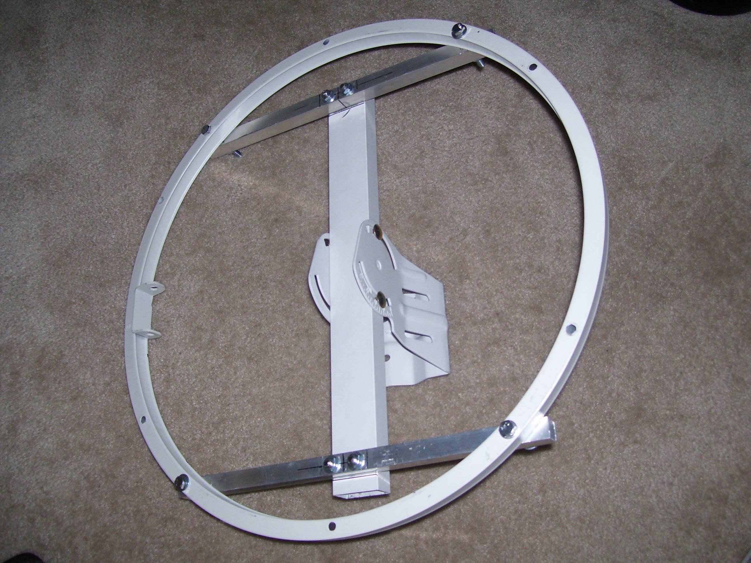

So you are still using that dish. I thought you would be up to a twelve footer by now!Glad to see it is still working for you.By the way, nice mount adapter, I womder who came up with that! LOL.I hope all is well with you,Nick

Yep! Still in service thanks to you. Your mount is holding quite nicely also.

Looks like something that would work. Where did you get that?
Comptech gave it to me. I'll be moving soon and have another dish to replace it, so this one will be given to anyone who can use it.
