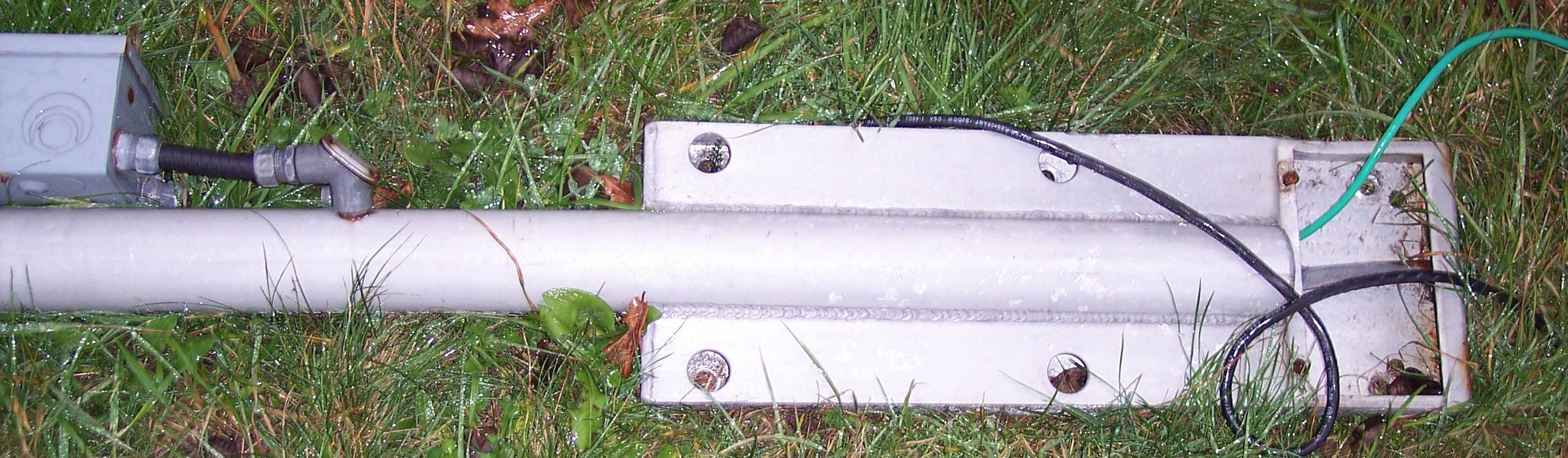

In my avatar, you'll see that on the left hand side I've got two 75E dishes on a 6"x6" post (my clothes line post). It's 4' into the ground in a round poured form. I have a 12' tall, 3" diameter, 3/16" thick mast from an old phone booth that has a rectangular wiring box welded to it, with 6 bolt holes through it. Does anyone here think that attaching that to that post and putting the dish way up in the air would be a problem? Should I be concerned about the post twisting in the wind? Should I use another post, say an 8"x8", instead?

So anybody think an 6x6"x12 post, 4' into the ground, with a mast tied to it for adjustment purposes, would suffice?
Only if you plan on adjusting your dish every 6 months or more..just buy a steel pole. This ideal has been discussed before on another thread.
Only reason why I was thinking of bolting a pole to the 6x6 is that the 6x6 is already in the ground. That hill is nothing but medium sized rocks and clay backfill.
Here's a picture of the mast I was talking about. This mast is 10' tall, 3" diameter, with a box welded at the bottom. Figured I'd bolt it to the post that's already in the ground.
If it's ony going to cost you a few bucks for Hardware, your time, and you can un-do it - "no harm - no foul", I'd give it a try.
Should I be concerned about the form that post is in now rotating in the ground?
If the Form does Not go to the bottom of the hole, it May Not be an issue, as long as it stays Plumb.
What other choices do you have?
Without getting an auger and doing another hole there is no other option.
So long as it doesn't snap the 6x6 off in the wind I don't think I've got anything to lose besides my time.
