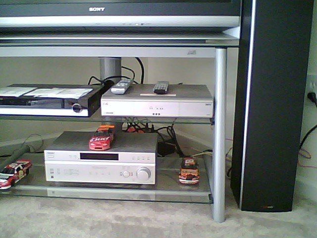

Sounds like you might have a heat related issue. What are your temps showing? Is the 622 in an open cabinet?
Both times today were on FoodHD.
High temp 125
Low 100
Avg 109
Heres a pic of how it sits

Those temps aren't bad. And the setup looks nice. I haven't seen the reboots that you are talking about. Sorry.
