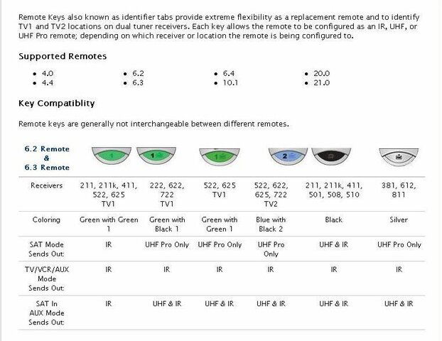

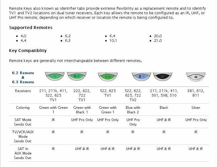

You can use TV2 remote to control TV1. You would need to make sure that the remote has the right "key/tab" in it. If you take the battery cover off of the remote, you can pull the tab out at the bottom. Depending on the remote model that you currently have, you just need to make sure it has the right tab in it. For a 21.X remote, just flip it to the "1" side. For a 6.X remote, use this chart below to figure out what key you need
If you do not have the correct tab for the remote, feel free to send me a PM with your phone number or account number and I can get you info on getting a replacement remote.
