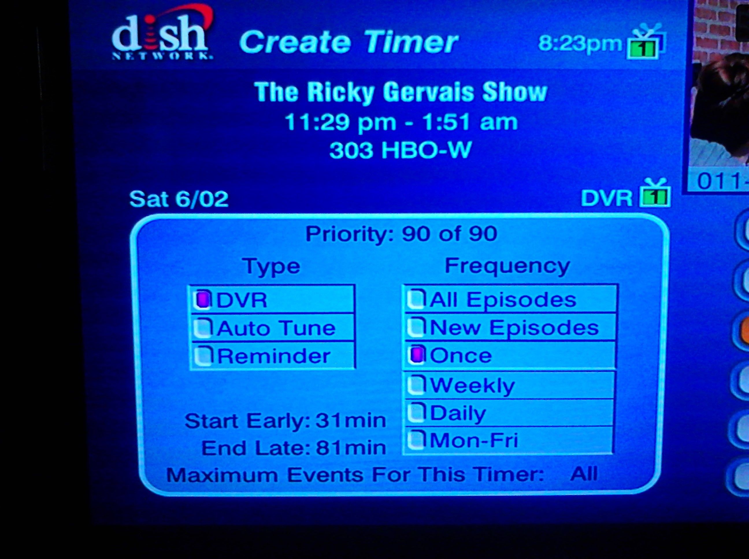

Well it's Friday so I should be relaxing but instead I will be battling my 722. I have been keeping a close eye on it since my original post and what I find is that any new timer I create, it gets messed up. Example the 11pm news on my local cbs affiliate (no not off air, dish provided network), I select it to record one episode and I think everything is fine and find out that it records the entire program on before it also. Seems to be something with the start 1 minute early. I did not say was going to do that, it just did. (35 minute news program recorded for over 2 1/2 hours) I notice when I setup a timer, example the ricky gervaise show on hbo. When I look at the my schedule it has the time to begin as 11:29pm, the show starts at 12am. Looking at the options it is start 1 min early end 3 late like I prefer. It should say 12:00am as the start time in the schedule (even though will start 1 minute early). All of my existing timers are not effected. I so would love to just have the Hopper installed and be done with this 722, but I cannot justify the cost. The increase in monthly fees alone would bring my bill up an aditional $15 if I recall correctly. Well my Dirt friends, this is where I implore your assistance. Anyone who has read some of my previous rants knows just how much I despise calling tech "supposed to be" support. ;)
Further information, yes I have reset the box (took about 20 minutes to come back), also I notice when I attempt to setup a timer it shows start 31 minutes early and end 81 minutes late, but when I select options it shows start early 1 minute and end 3 minutes late. WTF 722 Grrrrrr

check switch run, no problems. I have less than 4 hours hd left to record. This all started after the other day when I found the guide settings to be all messed up. Weird that when I setup a timer it wants to record everything 81 minutes longer than supposed to and and start 31 minutes early.
